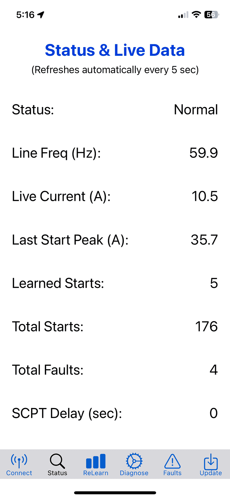

I purchased and installed a Micro-Air Easy Start for the 5 ton AC unit. It did incredible things to limit the initial draw at start up, but I fell short of being able to run the AC from the truck. My AC unit is rated LRA (start up) of 152.9 amps. I knew that likely spelled trouble. With the Easy start it is pulling about 35.7 amps or 8568 watts at start up and there is just no extra room from the truck - it trips at 7600, I got so close. Once the AC does start it only pulls about 10.5 to 11 amps while running, but the start up is a no go. If only I had that little extra to get through startup.
The Easy start has blue tooth in it and you can monitor it and the power draw. I'm attaching a screen shot from a few days back. Each start varies just a little, but they are all close.
The faults listed actually came from the first 4 start ups of the AC. The Easy Start flashed an error light and told me it was overloaded. It still started the unit and over the first 5 starts it was able to do its thing and make adjustments (it needs 5 starts to learn how to do its job).
