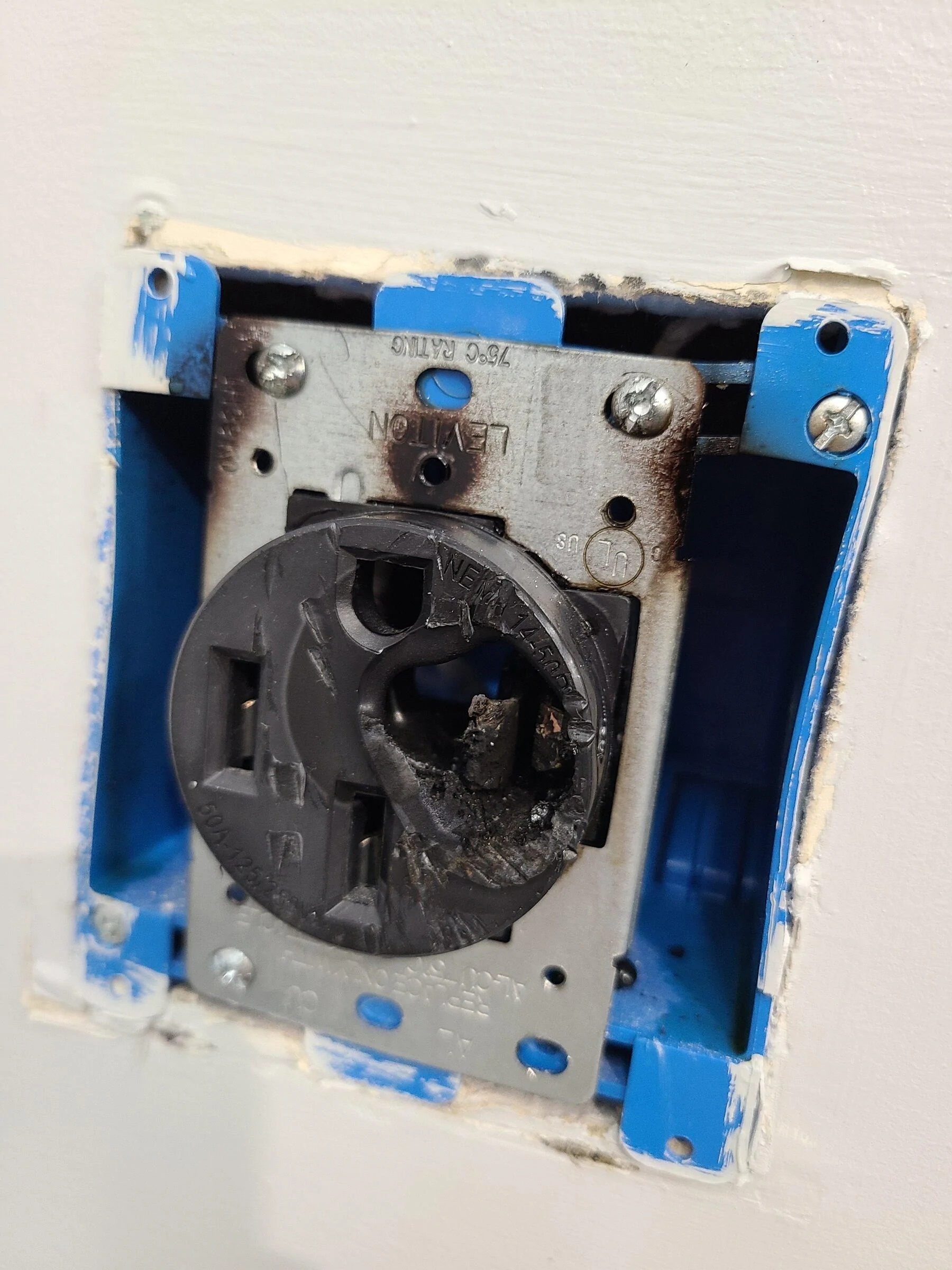

Ford F-150 Lightning Pro Charging Station to NEMA 14-50 1646919842965
The breaker did not trip, and my old Tesla connector does not have a temperature sensor in the plug. The heat was concentrated in the receptacle. Eventually the resistance was so high that the car noticed poor power and refused to charge which prompted me to investigate. The breaker would have only tripped had there been a short, and by that time my entire wall would have been on fire.
After doing some research, apparently the Leviton is known garbage. Some people have had failures with it after only a few months - perhaps accelerated by frequent plugging/unplugging of the connector. I left mine plugged in semi-permanently so maybe that's why I was able to get over 2 years of service out of it. Popular brands are Bryant and Hubbell. The Utilitech from Lowes is also a good budget option which is what I bought. Eventually I'll just use the hard-wired EVSE from Ford when I get my truck and decommission this receptacle.
Do what you want, but don't recommend people to be so cavalier in disregarding code requirements.

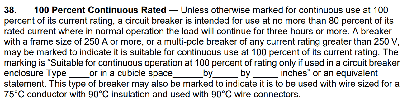

It's not pure balony when considering safe long term operation of a circuit. Breaker will carry it continuously but it is not allowed by NEC unless breaker is explicitly 100% rated (the UL listing describes the 80% rating of standard breakers, no need to print it where you see it if you just follow the NEC rules). NEC concern is heating.
Ford F-150 Lightning Pro Charging Station to NEMA 14-50 1646927713948
IS_37_80-versus-100-rated-ATS.pdf (cliffordpower.com)
Molded Case Circuit Breakers (ul.com)
