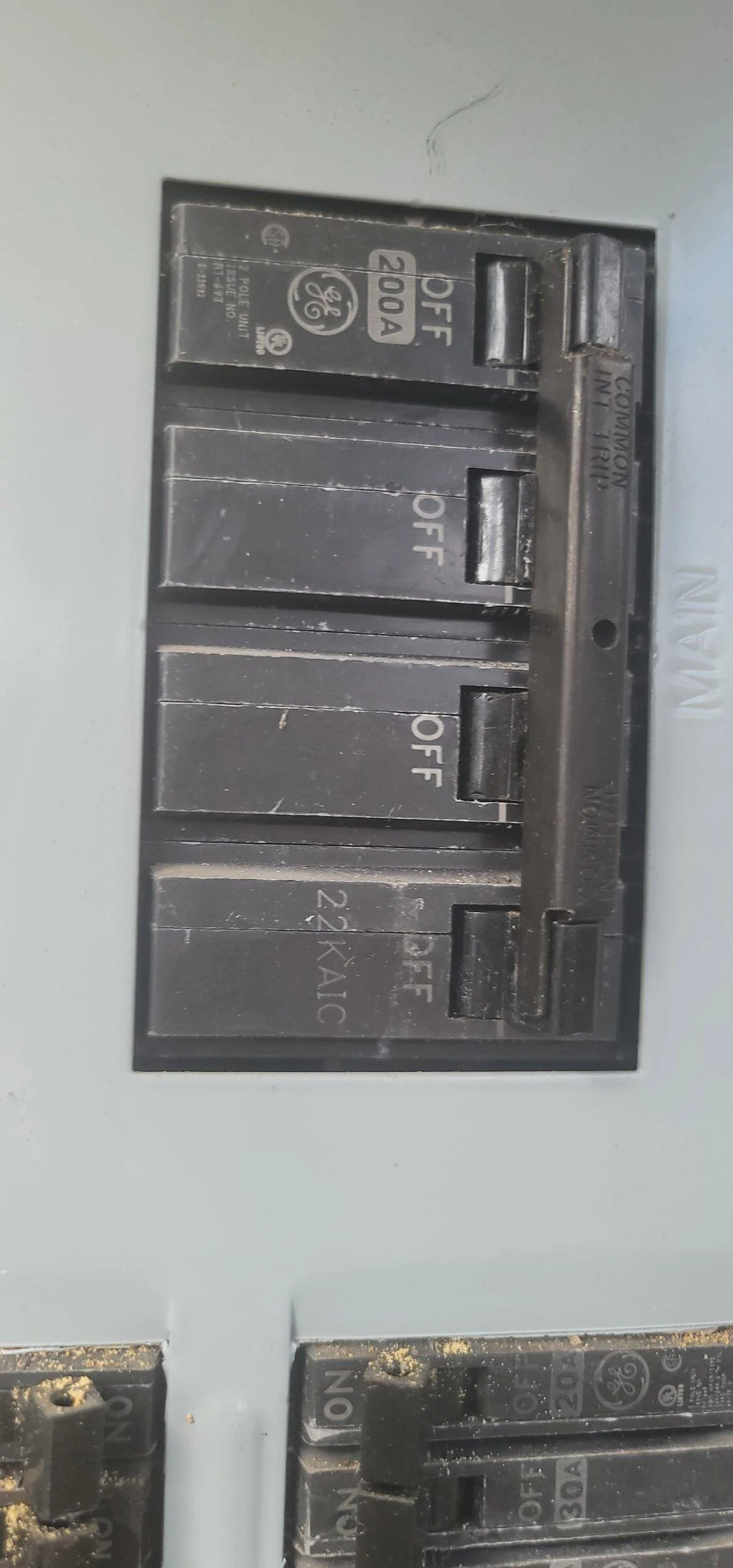

Depends on what you mean by two breakers. You refered to the the main as four breakers but it is really two 2-pole breakers together in one. If it is two poles or two whole positions together, that is making it a higher voltage (240) at the same current, because positions alternate between 120V legs.
This is the main breaker for incoming to the panel

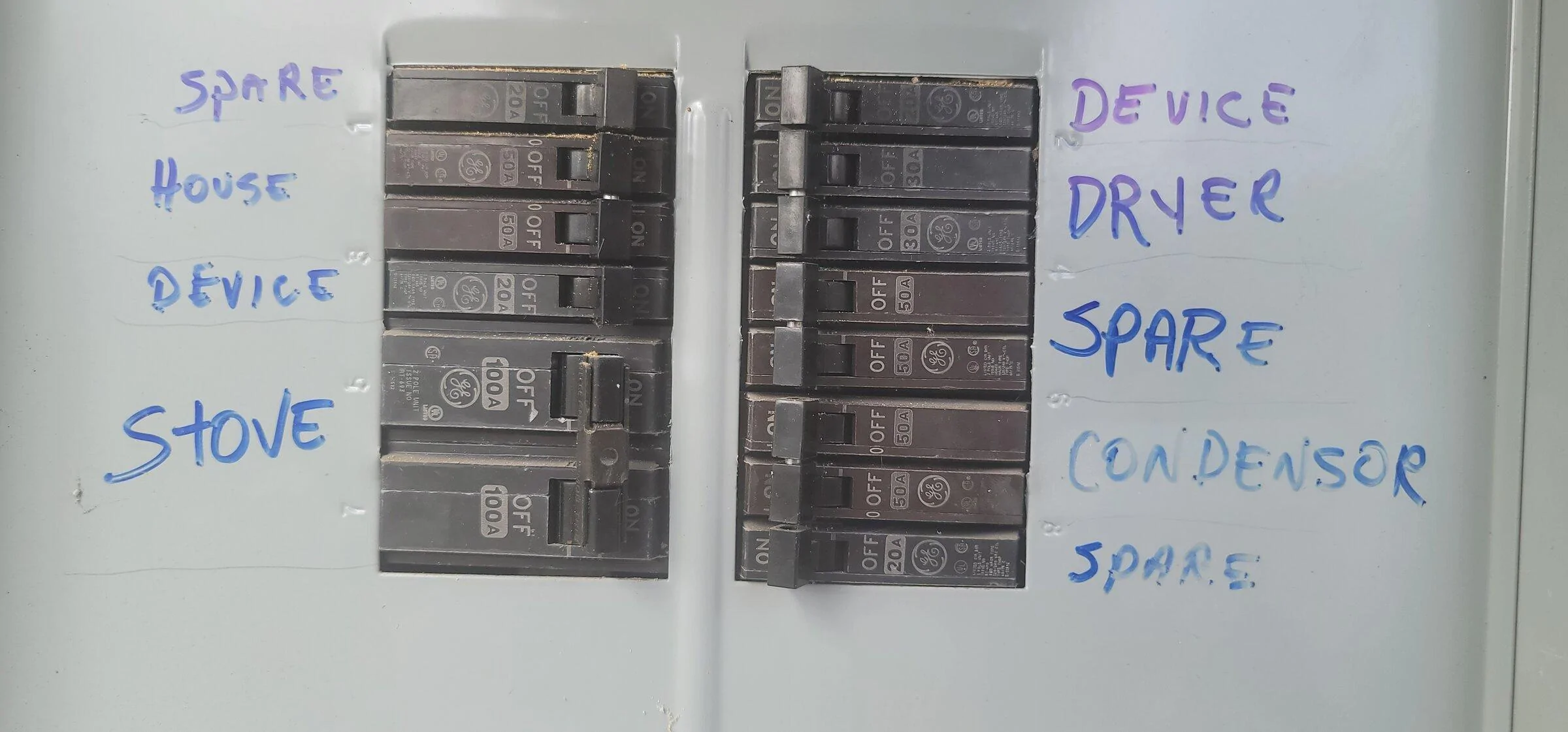

And here is a picture of the two spare 50 A (middle of the right side)

I think that's a single 2 pole 50A breaker. You may be able to replace it with a 100A breaker, but as it is, it's only 50A.
Thanks! I know DC and batteries, but I guess that type of knowledge doesn't transfer to AC currents ;)

If they make a compatible slim line model in 100A
Yes. That's why I said "may". Still, need to talk to a qualified electrician. Looking at this panel it has a 100A circuit for the stove. That seems high. Most modern stoves need a 50A circuit. So there may be an opportunity there. Talk to an electrician.

Definitely not a modern home. House built in the '60s, stove bought new probably 20 years ago, and panel upgraded 10 years ago. Lived in the house for 26 years.
I wouldn't make any decisions until you verify those "labels". Typically you would want to see a spare in the off position to know it isn't being used - you might turn off and confirm nothing is affected. The 100A breaker for "stove" is suspect (larger than typical) as is 50/2 "house" breaker.

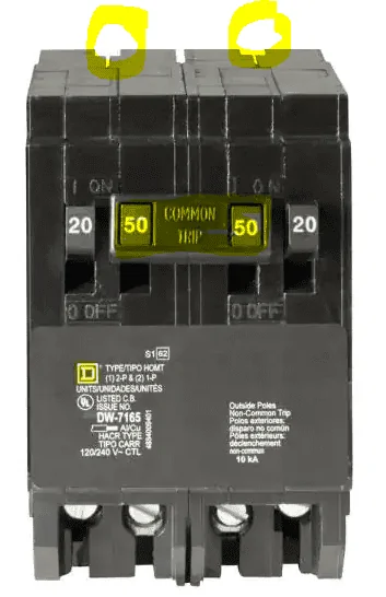

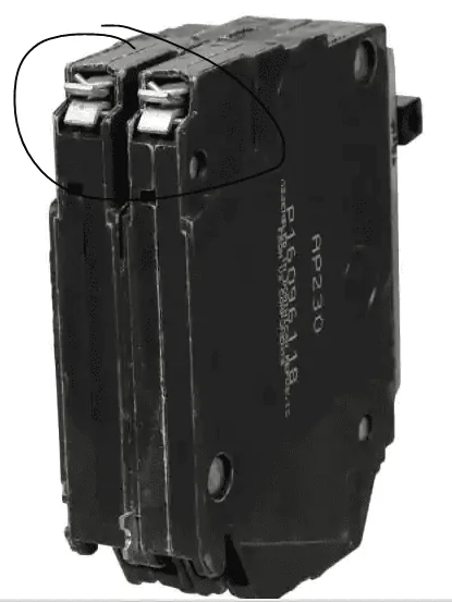

I have a number of slim 240V breakers in my panels. Just none 100A. I had to move stuff around to get some to match to two legs. Since there are slim breakers in we have to believe it is supported.
Good catch on both the labels and the 100A stove.
Could you post a photo of what they look like?
I'm curious to see how it would be set up, I'm imagining two slim groups with a breaker tie across all four switches, if any of the four breakers (or 240 groups) experience an excessive load all will trip off.
