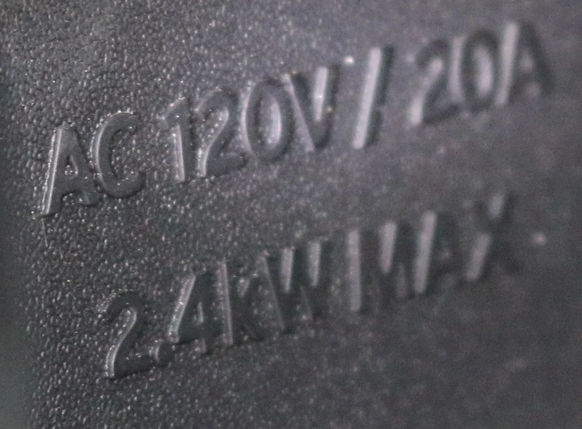

There are a couple sets of 120V 20A outlets in the bed so IF you are saying using more than one of them you can get 30A that's believable.
But if you are saying ONE outlet (labeled 120V 20A 2.4kW MAX on the cover) could output 30A and a test proves that, I'd be shocked (pun intended).
It would allow you to overload a 15A or 20A cord and plug with 30A which could result in a melted cord wire/plug since they are not rated or designed for 30A, and that would be a code violation as well - yes the NEC has codes for automobile outlets:

Really the issue I was responding to, that the 20A receptacles can provide 30A, should be moot because Ford clearly labels the 20A receptacles on the receptacle covers as "120V 20A 2.4kW MAX" and the manual says not to exceed the rating on the cover.
So Ford clearly did not intend that the 20A receptacles provide 30A. And I do not believe they would.

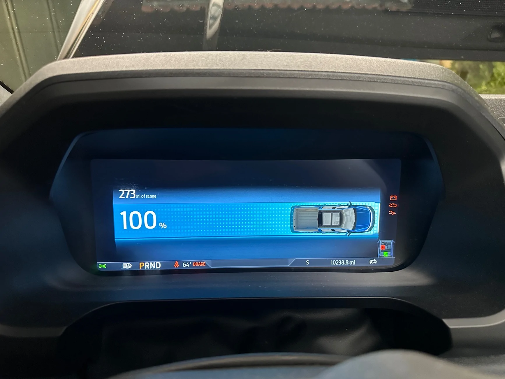

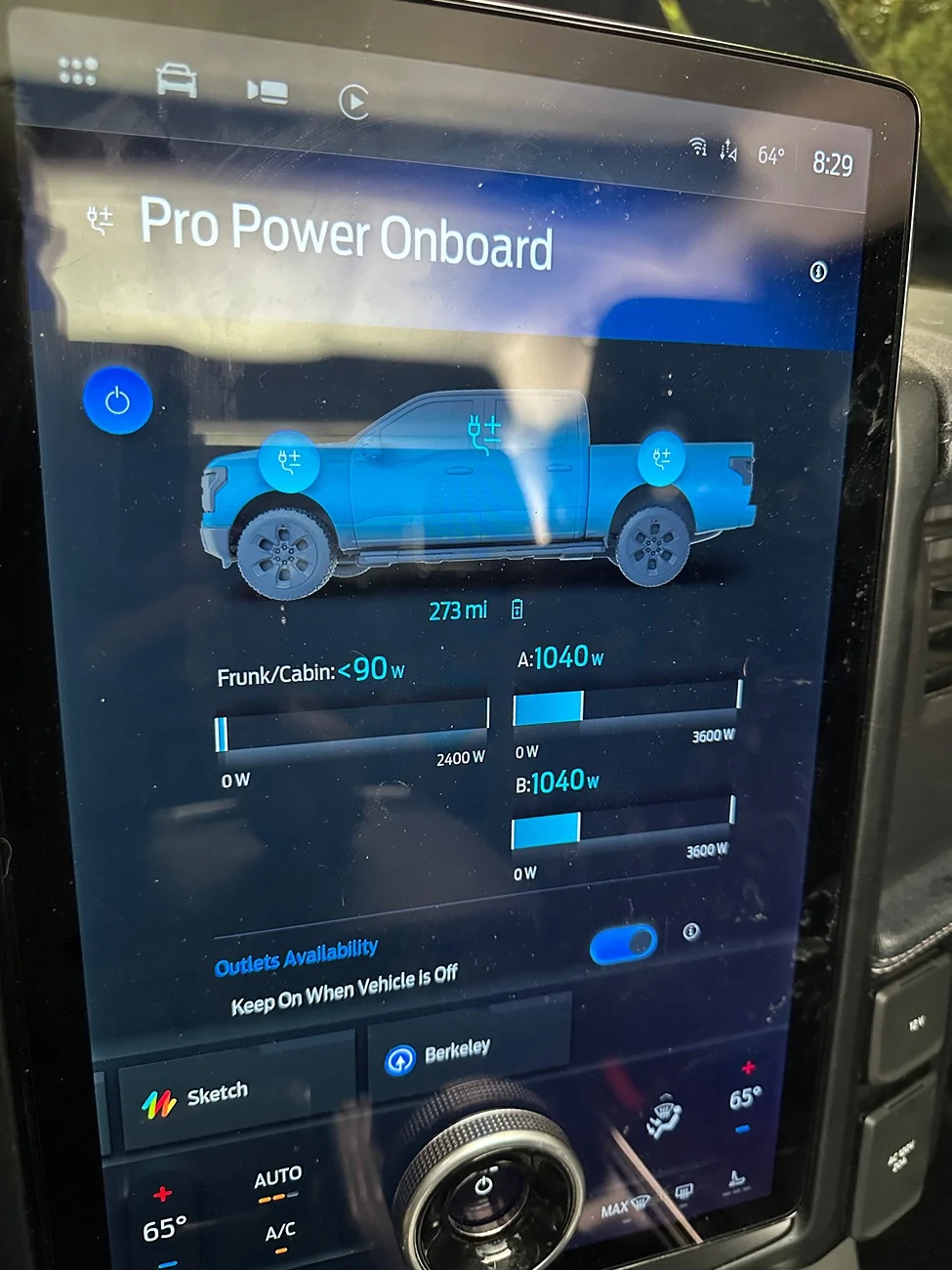

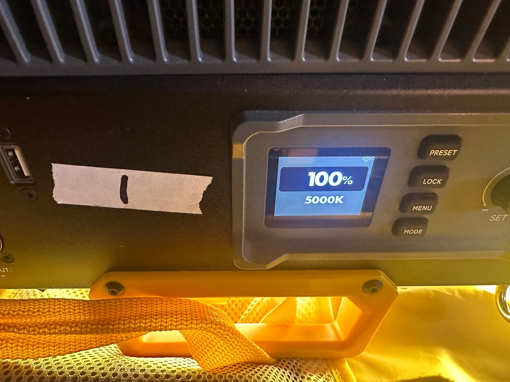

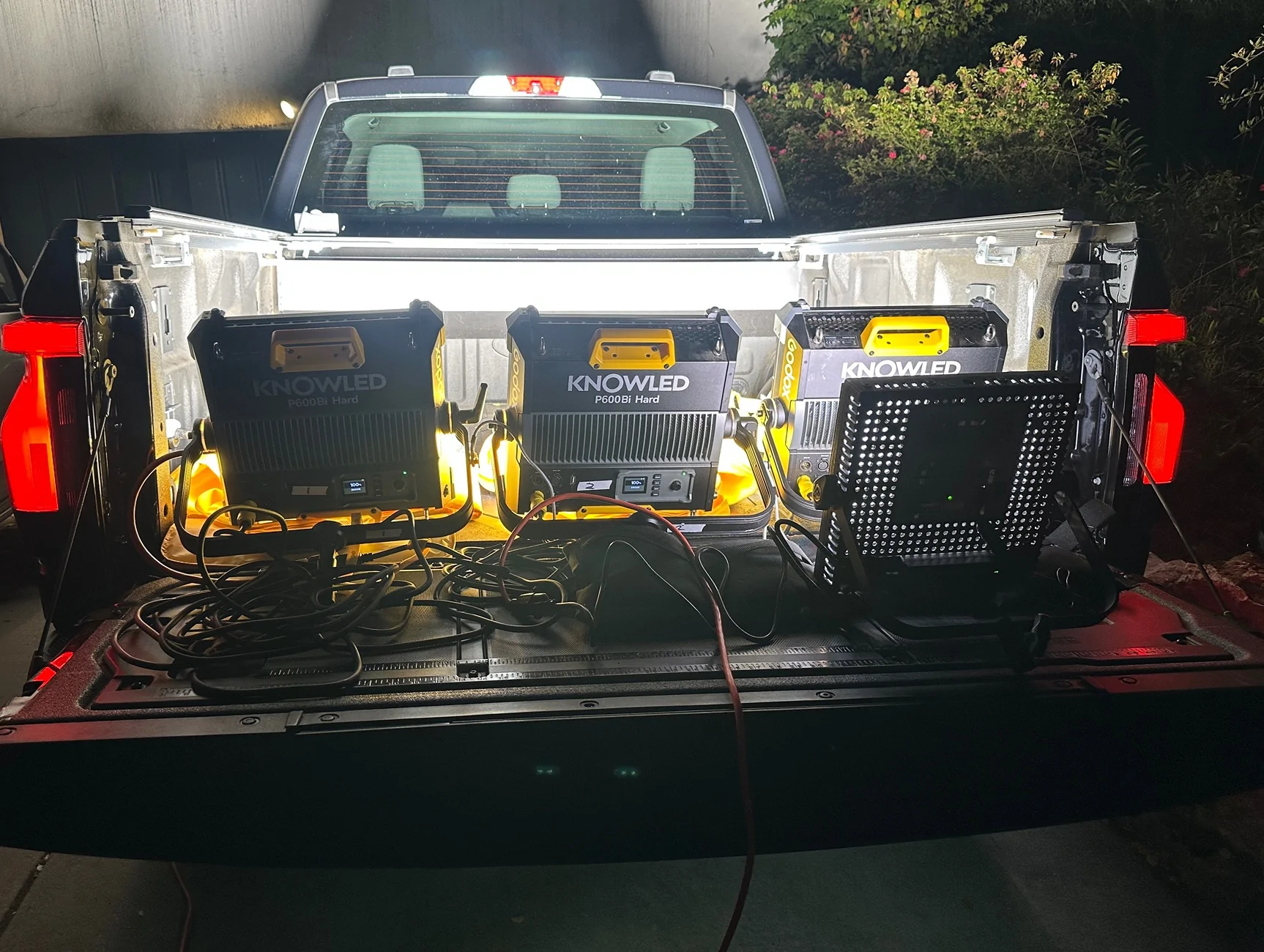

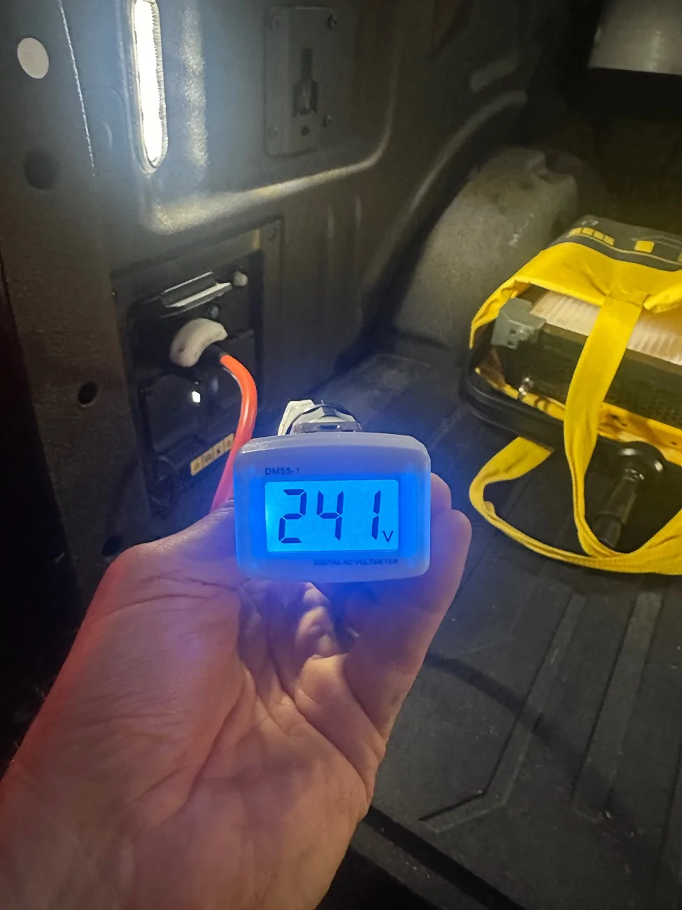

I did a test running 3x Godox 600 lighting instruments and an old 1x1 light panel I had around.
All in all generated somewhere around 2000watts thru the 30amp/240 using a pigtail.
this worked fine and I gave me the the confidence that it’ll do the trick. Of course elements matter and this was NorCal around 58 degrees w a tiny mist. Mileage will vary in Las Vegas.
Kept the car on and ran everything at 100% for an hour and mileage range dropped 3miles over that time.
