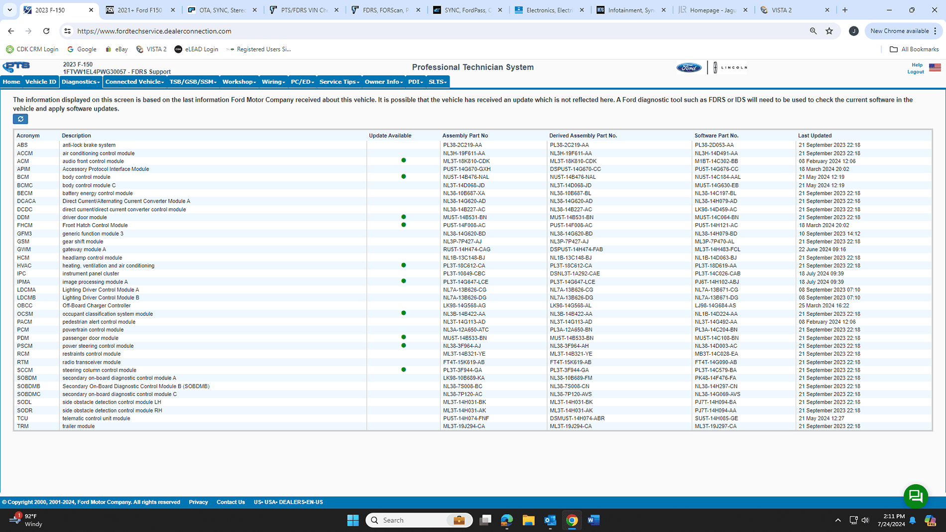

Con someone check mine?
1FTVW1EL4PWG30057
Your truck is on the latest Sync version and shows recent OTA history. Modules with pending updates are below. Nothing to be concerned about here, IMO.

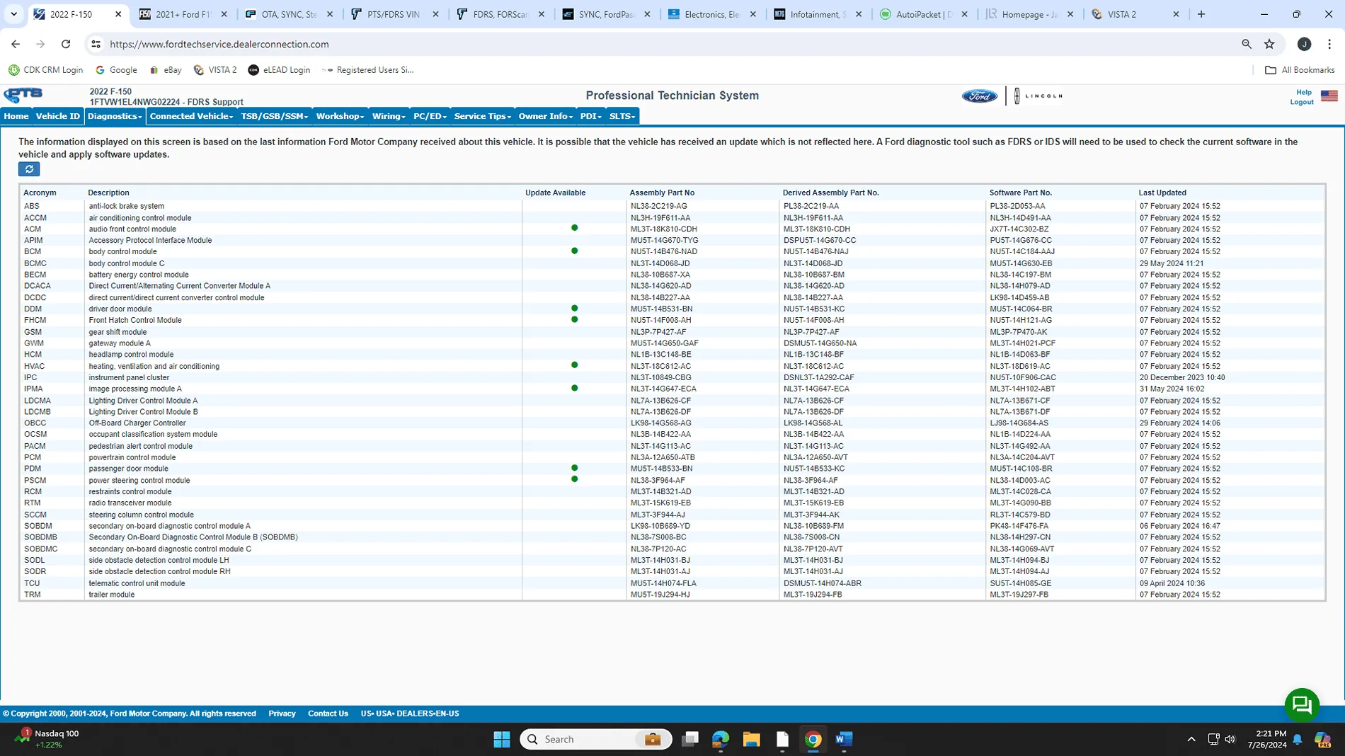

Can someone check me? I have not received an update since the Supercharger P&C update.
1FTVW1EL4NWG02224
rugedraw
rugedraw
Javier
Dec 14, 2021
1,862
2,276
Miami
Auto Sales
1FTVW1EL4NWG02224
Your truck is on the latest Sync version and only showing a few pending updates. The PSCM/IPMA you see below are not available OTA, so there isn't much you need updated. You aren't getting update because there is very little to update. Nothing to be worried about here.

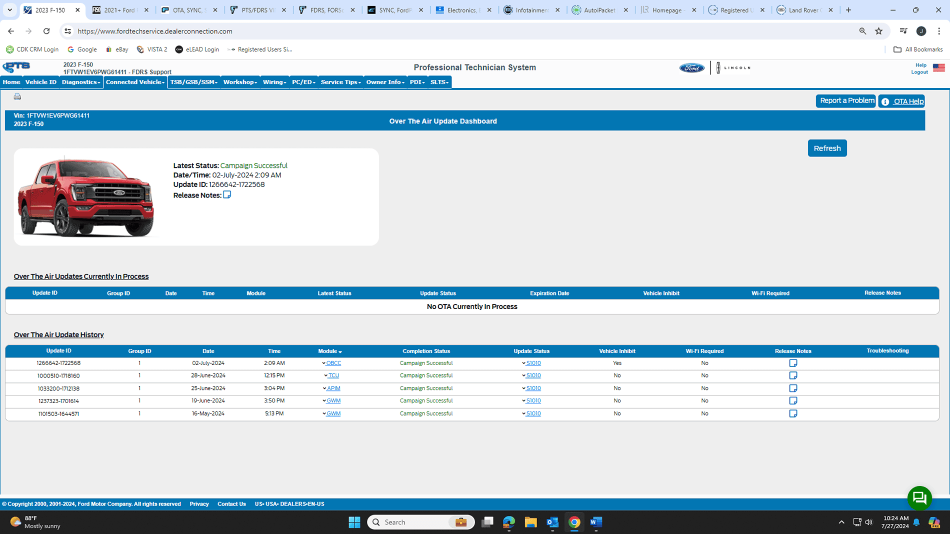

Would you please check my OTA history and modules pending updates?1FTVW1EV6PWG61411

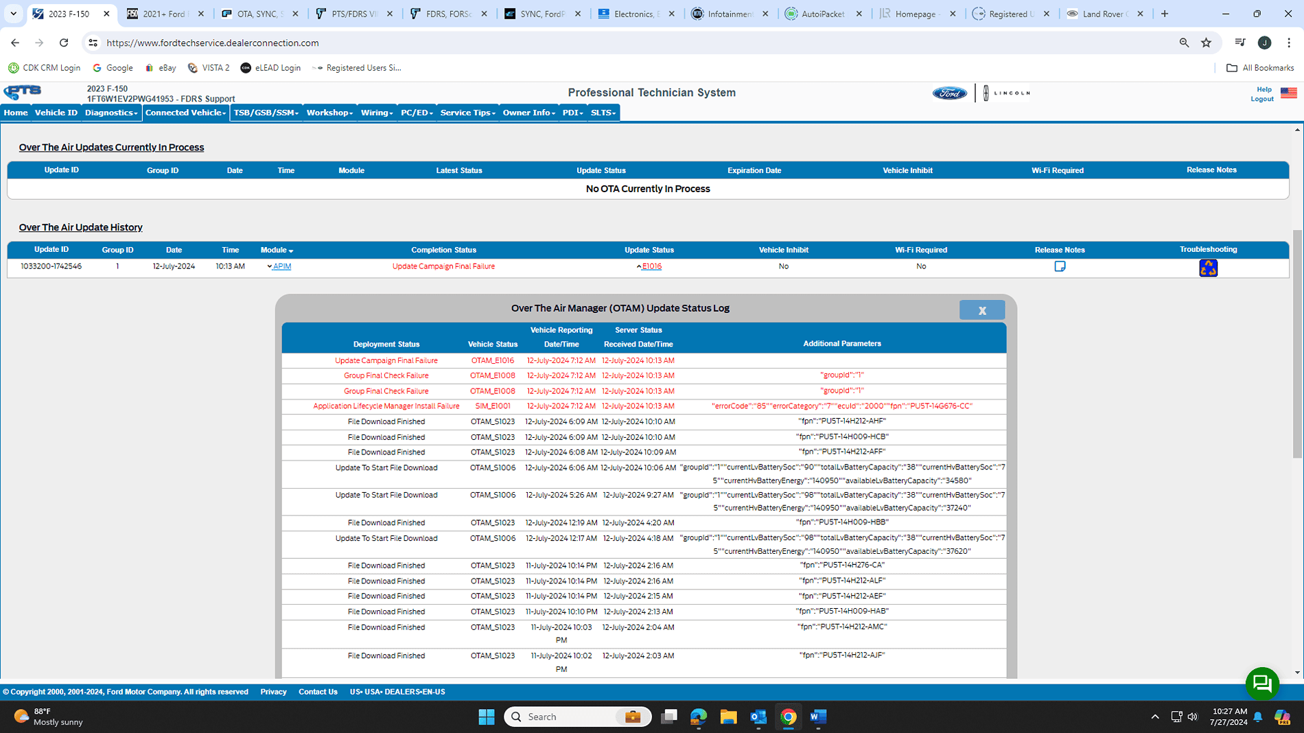

Hi @rugedraw ,
Thanks for your help. I have an Update Incomplete notice after what appeared to be a 12 hour download, and Ford OTA has shrugged it’s shoulders and passed me off to a three week wait to get into the dealership. Would appreciate a peek from an expert as to what is going on.
VIN 1FT6W1EV2PWG41953
2023 Lariat ER
Thanks again.
OTA history and modules pending updates are below:

Hi @rugedraw ,
2023 Lariat ER
Thanks again.
The update failed due to an issue installing of the files. In this case, PTS does not give any clear details as to what happened citing "errorCode":"85""errorCategory":"7""ecuId":"2000""fpn":"PU5T-14G676-CC". This is internal lingo that would only make sense to Ford engineers.
