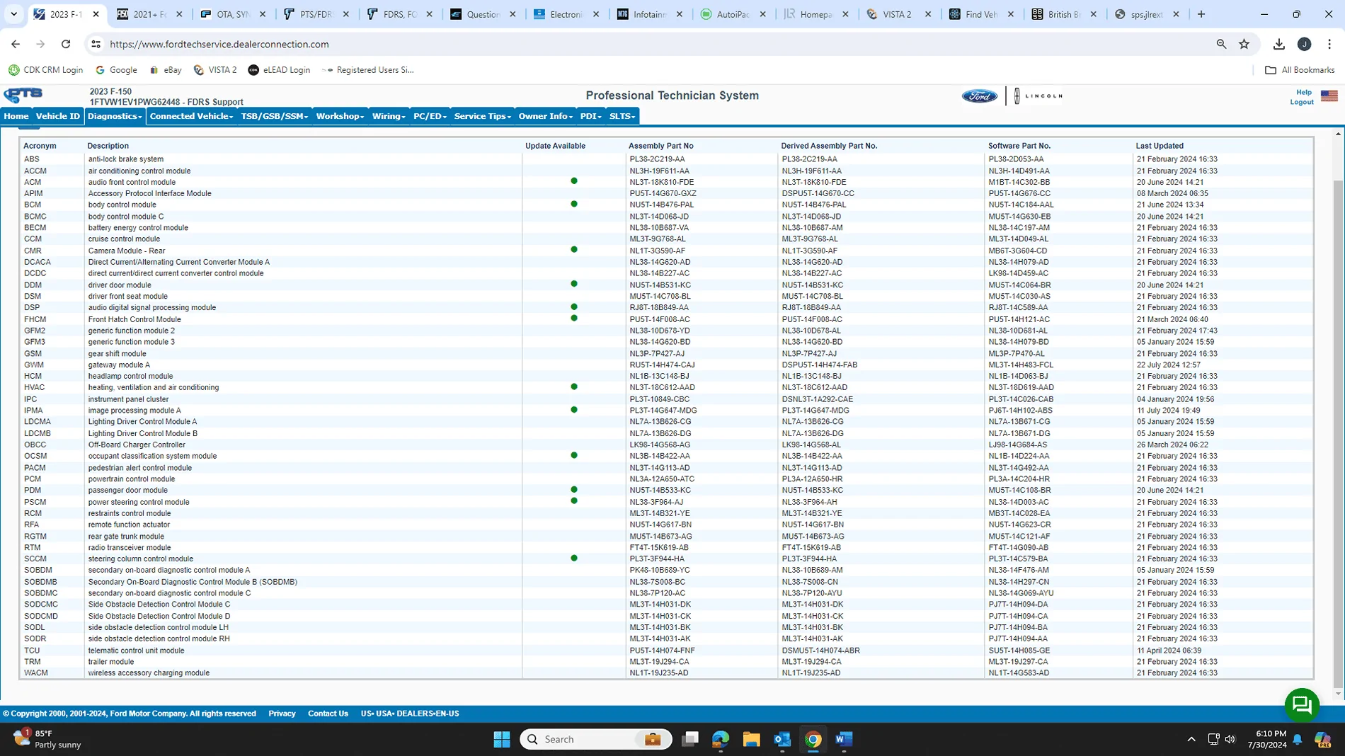

Can I get a check for 1FTVW1EL3PWG12195? Thanks in advance.
Truck is on SYnc 23159 which is one version behind the latest. OTA history shows updates are being sent it and modules with pending updates are below:
Ford F-150 Lightning PTS/FDRS VIN Check Thread 1722352924048-7c

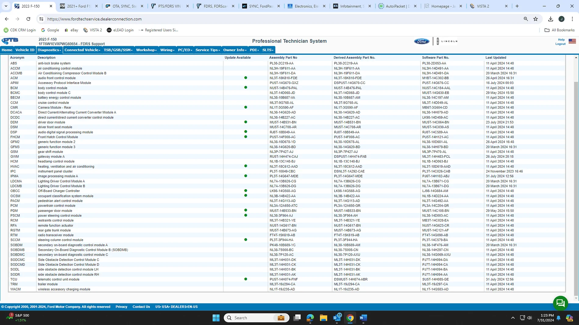

Could I please get a VIN check as well? Thank you so much!
1FTVW1EV1PWG62448
Truck is on the latest Sync version. Modules with pending updates are below.
Ford F-150 Lightning PTS/FDRS VIN Check Thread 1722377422680-og
