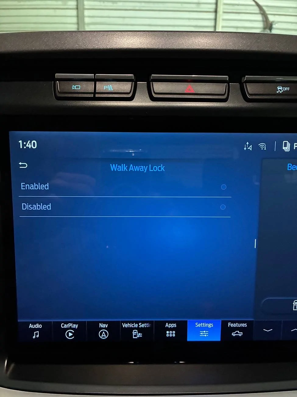

So I got this update Friday in my 2022 XLT and went into forscan to enable the toggles. I just updated everything I could using FDRS a few weeks ago but couldn’t update the bcm. Does this mean I still need the bcm update for this to work?
Ford F-150 Lightning PU-Sync-25.2.1.6.5 - Walk Away Lock Toggles UPDATE POST# 95 IMG_0056
Ford F-150 Lightning PU-Sync-25.2.1.6.5 - Walk Away Lock Toggles UPDATE POST# 95 IMG_0057

Got this update last night as well. I already had the WAL toggle setting enabled via FORscan from a few months ago. I tried enabling it this morning and it still automatically revert back to disabled.
Just got added yesterday 7/11-12 and same result here... Just found out from someone about this thread too so... yay us.

If you havent recieved the BCM update, it wont work with just the APIM update, it will have the toggle, but it wont stay selected. Im also waiting on the BCM update.

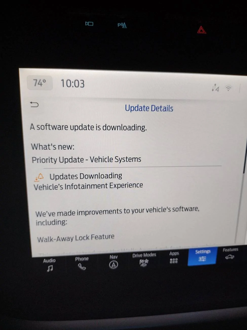

On Friday I had a cluster glitch in the matrix indicating cruise control was not available. Meanwhile I didn't even have it turned on... It was the typical Ford way that an update was coming. Didn't drive till this morning and long and behold.
Oct 23 build XLT ER
Ford F-150 Lightning PU-Sync-25.2.1.6.5 - Walk Away Lock Toggles UPDATE POST# 95 IMG_20250714_100327500_HDR

2,432
2,568
I saw the updated thread not long after I post that. Yep, after a little testing I'm in the same boat. Oh well. I'm at least pleased that I got the update relatively soon. It's encouraging that when (if?) they send out the BCM update I shouldn't have to wait terribly long.
