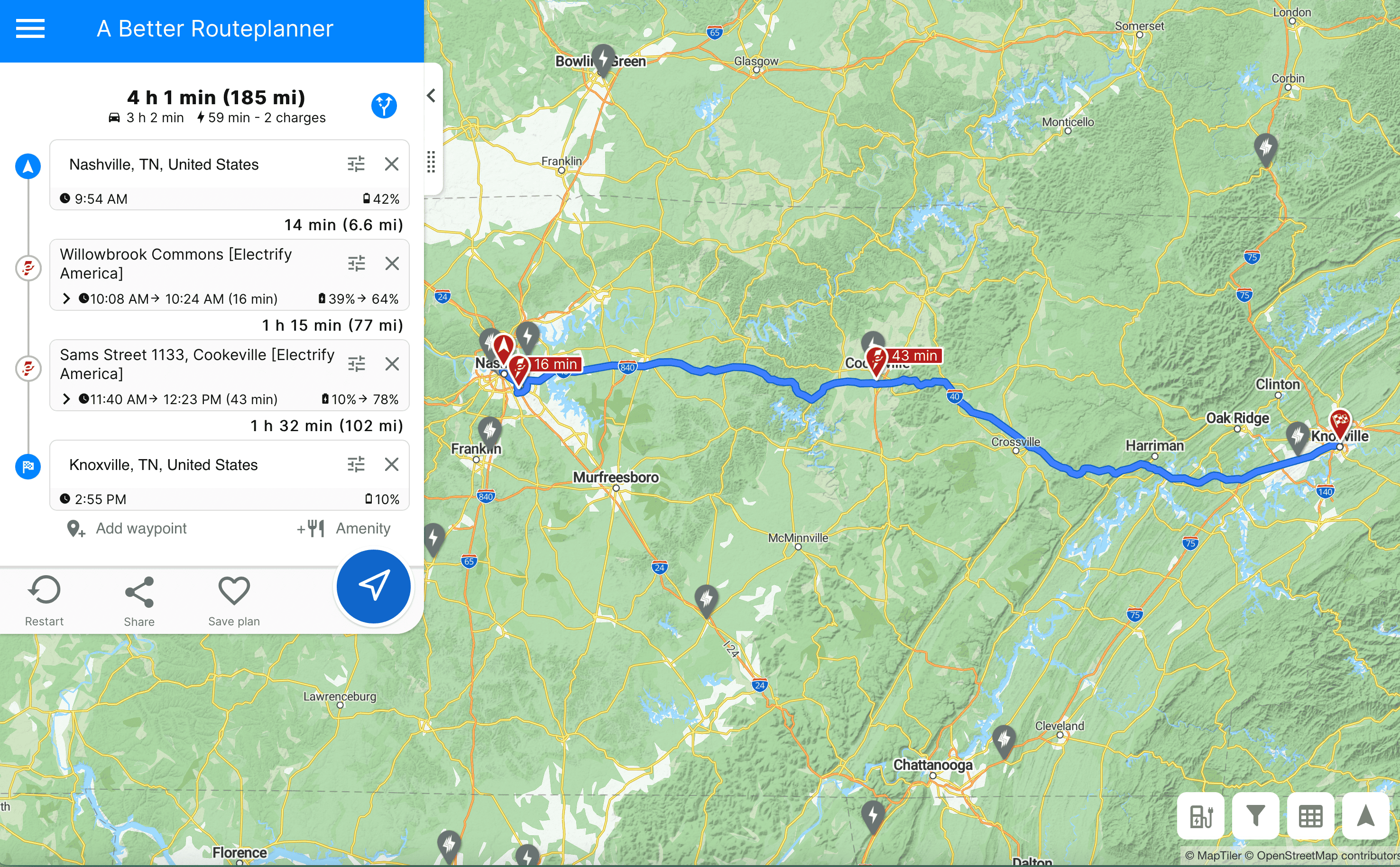

What would I do? I'd download the app "A Better Route Planner" [ABRP] and use it to route a couple of trips from my house. Both battery sizes for the Lightning are listed and the app has a very good (but not perfect) database of charging stops. I'd see what chargers it recommends, and then sign up for an account with those vendors.
I've included a screen grab from the web version of the app so you could have a look.

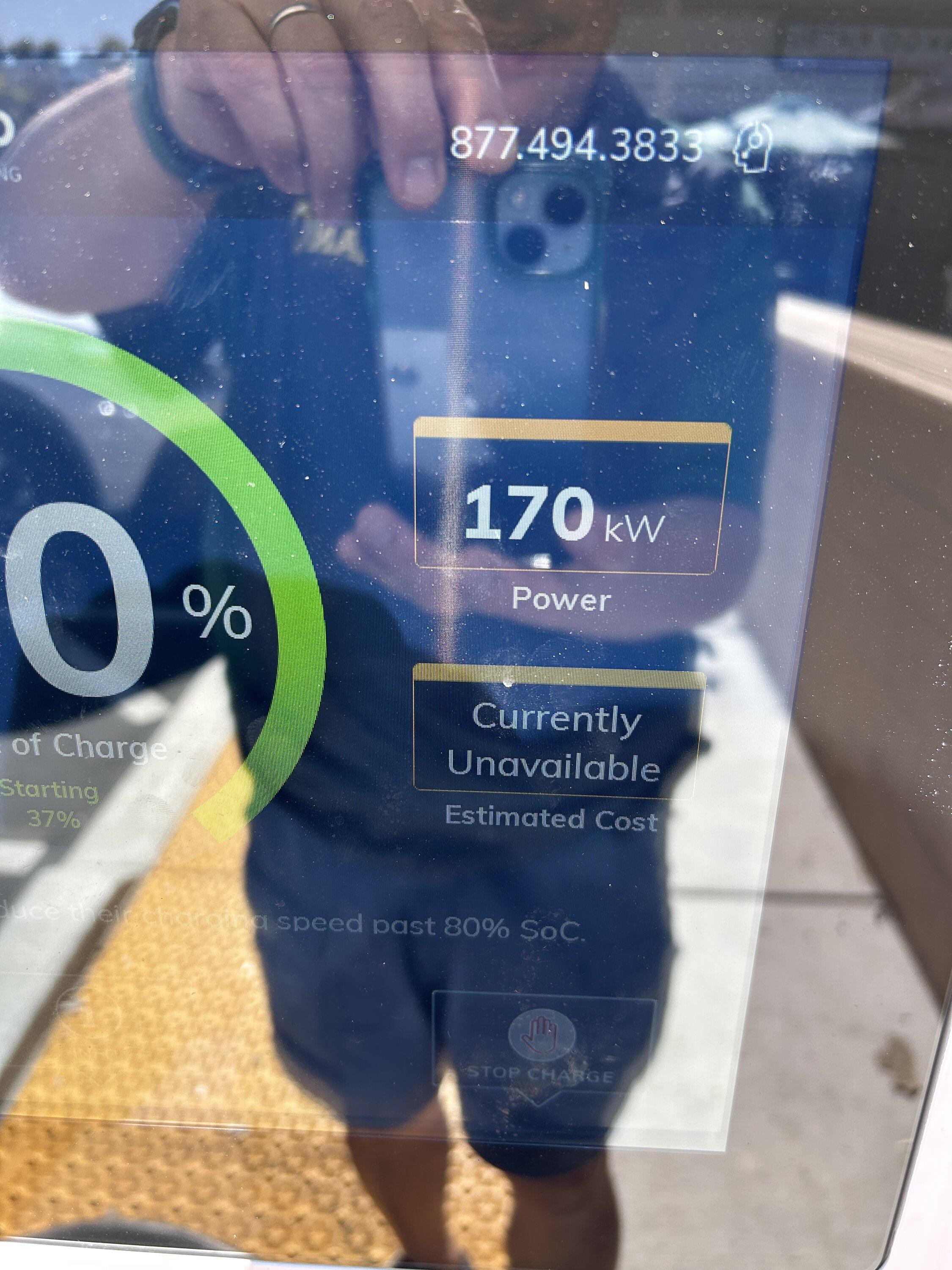

Use each charging network's own app for your area.
Where I live it's a heavy EVGo charger area while Shell ReCharge, Electrify America & ChargePoints are sparse.
So I keep 4 apps on my phone with a credit tied to each app.
The only advantage I have is I am enrolled in EVGo's AutoCharge+ which makes it a true plug and charge experience.
Just yesterday charged super quick at 170kW rate on a 350kW EVGo station.
