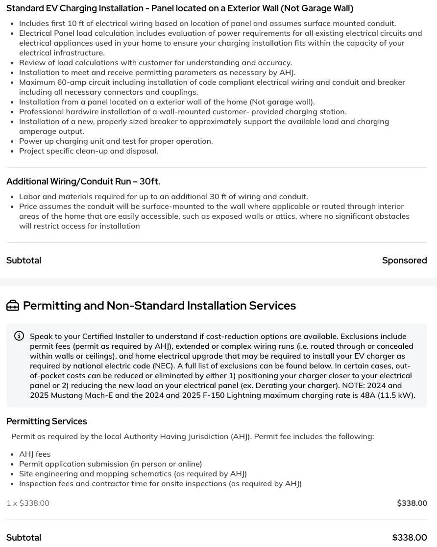

Qmerit install - $338 for "Permitting"
jefrank
Jeff
Dec 11, 2021
302
333
Fenton, Michigan
2022 Ford F-150 Lightning Lariat ER, 2004 BMW 330Ci
My permit fees were $250 in Michigan when I paid out of pocket for my Autel charger to be installed... I also thought that it was high, but not enough to fight over given the time it would take me to learn what was required and file for the permit on my own.

Yes it is excessive. Here the permit itself is $65. Most electricians around here will charge around $145 for it.
Through qmerit I've also been quoted $275-300.
I'm waiting for the latest quote via qmerit from a new electrician after the last one flaked out. After weeks of waiting after accepting the quote they admitted they hadn't even started on getting registered in my city to be able to request a permit, and that it would be another 2-4 weeks before the charger is installed.
If this one doesn't go well I'm just hiring a local electrician. They quoted me $600 total including labor, parts, and permitting.

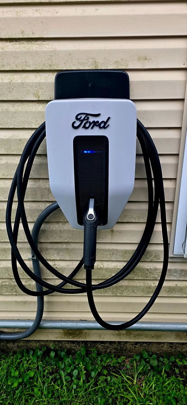

Mine was installed 9-2-25. My final cost was $0.00.
It's one of the great things about living in rural Kentucky. We "permit" as little as possible because we're Americans.
They sent two electricians who were here for 3.5 hours. Used 30 feet of conduit, wire, etc. Took some pictures of installation, asked me to sign off on it, and they were out the door by lunch.
Your installer asked me to send you the photos.
The subcontractor that my home builder used actually did that.
My Qmerit subcontractor did a very professional looking job.

$338 is nothing. I was just quoted $825 for permitting for my "free" charger. I checked my city's fee schedule, and their fee is listed as $260...
