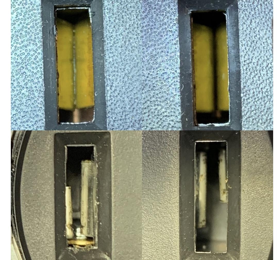

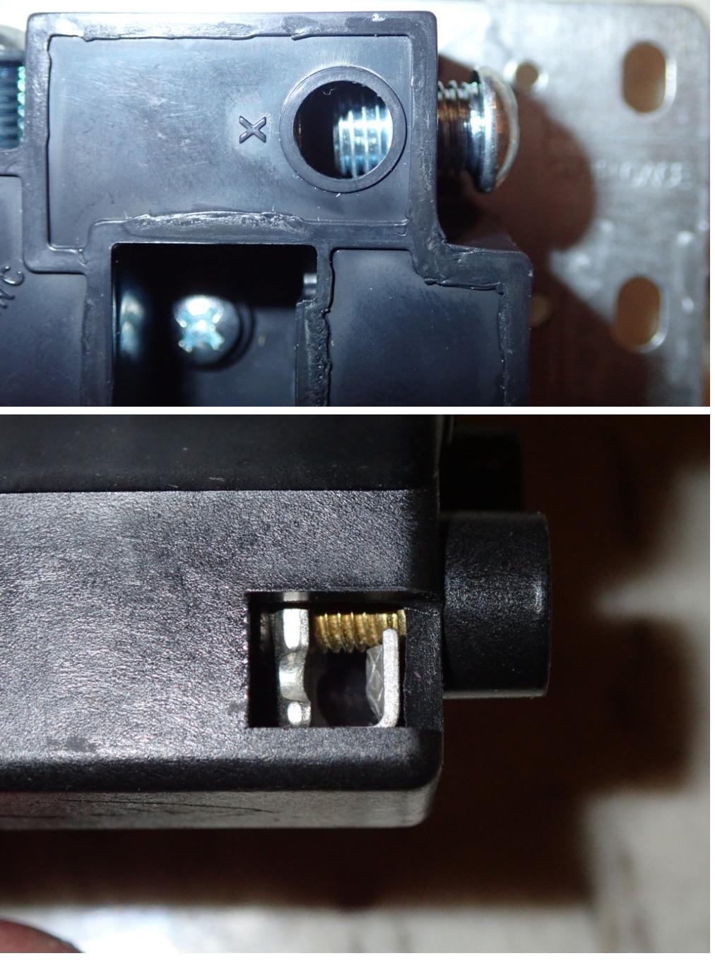

I would also check the tightness of the connections on the receptacle. Also look for signs of overheating and arcing, especially if an industrial rated receptacle wasn't used.

While we’re on the topic of electrical safety, here are a couple pictures showing the difference between a true industrial 14-50 receptacle and those sold in the big box stores. Notice the full contact area for the blades vs partial, and the saddle clamps for wire terminals vs simple set screws.
