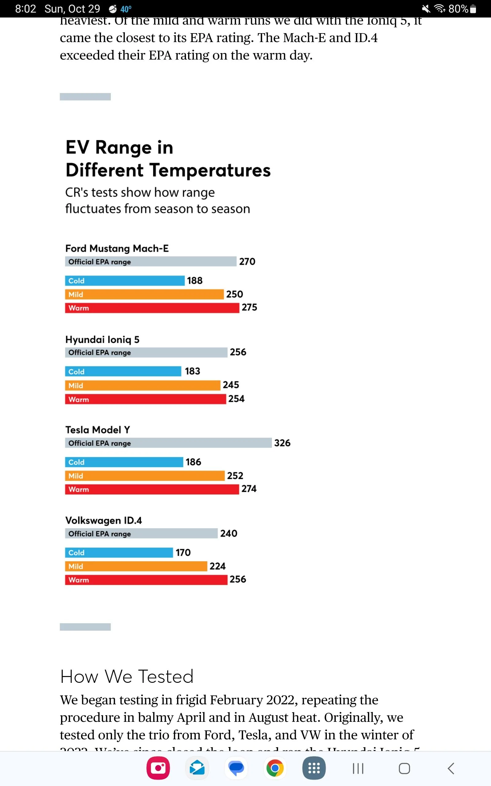

Not true. Facts vs opinions.
You should read the Consumer Reports story on this. FYI, CR is available online for free via most public library websites. https://www.consumerreports.org/car...e-affects-electric-vehicle-range-a4873569949/
In short, they found that a Model Y lost 32.1% of summer range while the Mach-E, without a heat pump, lost 31.6%. And that Tesla's EPA range was fiction. And that a Model Y long range got the same range as the Mach-E.
All fact.
The fact that Ford is incorporating a heat pump in the Lightning next year is interesting, perhaps the energy needed to warm the massive battery pack is where they save some efficiency.
Ford F-150 Lightning Question on Initial Range Screenshot_20231029_080254_Chrom
