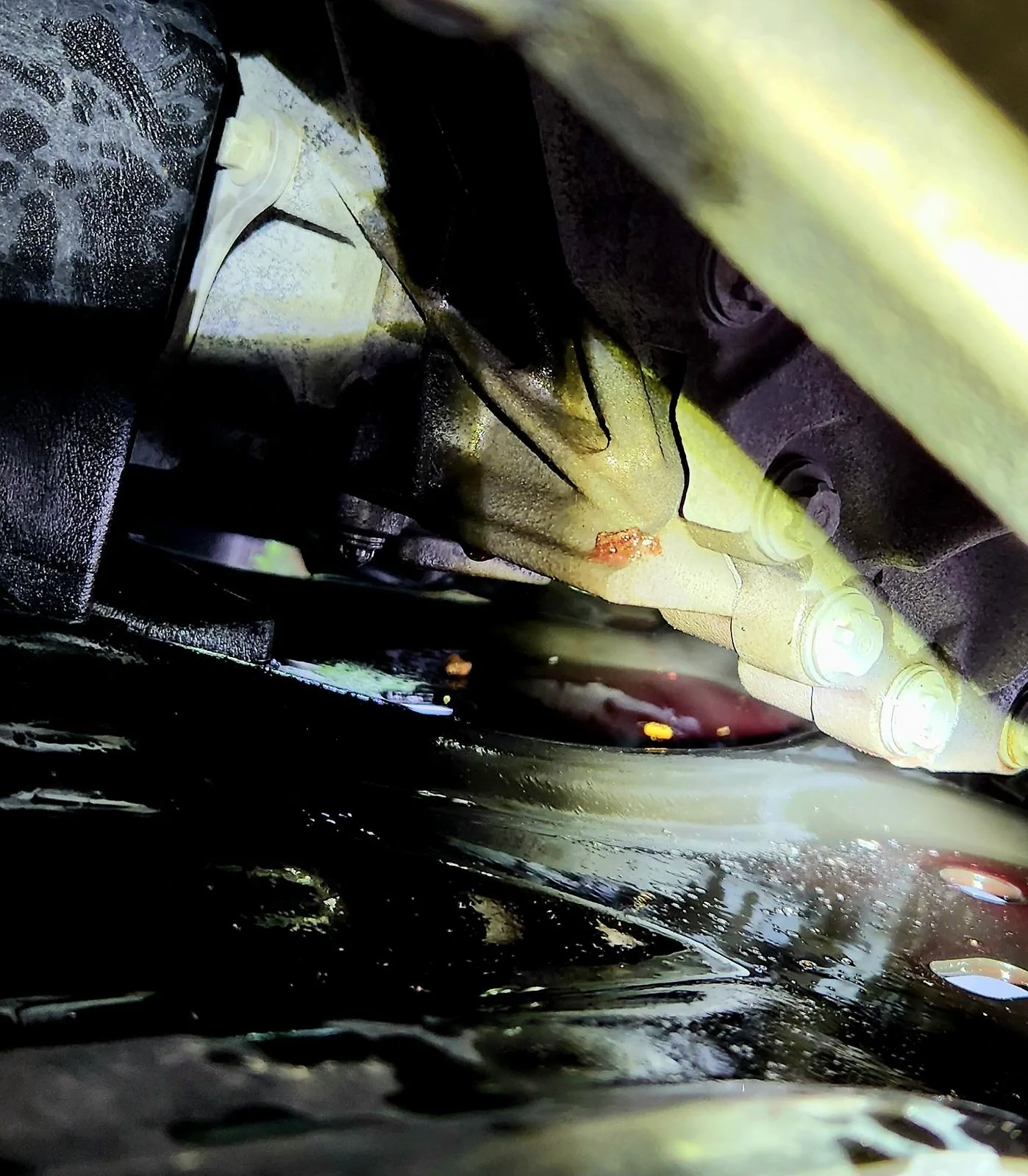

Have had my XLT ER since October 2023 when I took delivery after ordering it. Have 6,714 miles on it.
Today I experienced a rattling sound in the rear motor, although no warning lights came on and the truck continued to drive and stop normally. I looked under the truck at the rear motor and saw red fluid leaking out of the rear motor. I was able to drive it and drop it off at my local dealership only a couple of miles away from me. It's Sunday, so I'm hoping to get an update from them when service opens tomorrow.

Sorry to see this happened to yours too. When was your truck built?
Wondering if they had some bad parts in a certain run of motors. Hopefully they can get a new motor out to your dealer fairly quickly.

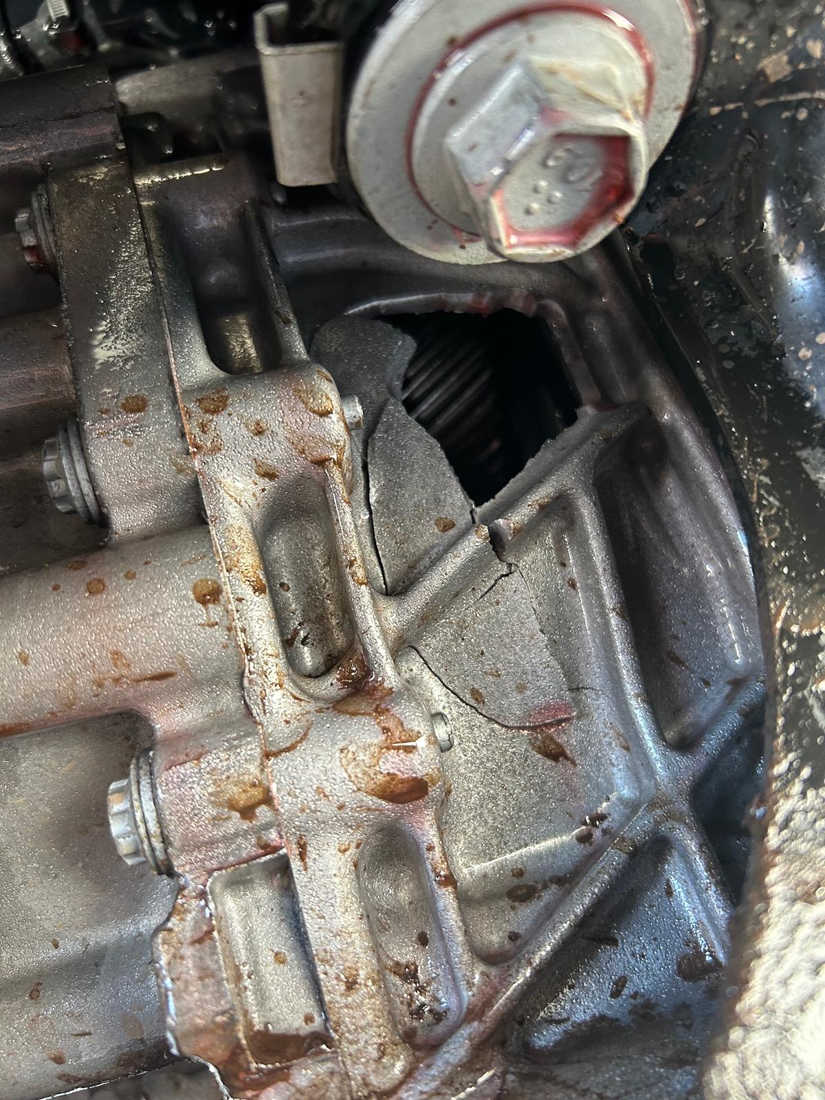

This just happened to me yesterday. Fortunately it was as I was heading home and only about a mile away. Heard a brief, slight rattle then steady leak of red fluid after I parked. Got towed to the dealership last night and waiting for official diagnosis.

Keep us posted, I'm curious about what failed in the motor!
How many miles are on your 2023 Lariat ?

About 18k miles on it. Was planning to take it on a 900 mile road trip next week. Disappointed that I will have to take a rental but better that this happened close to home.
