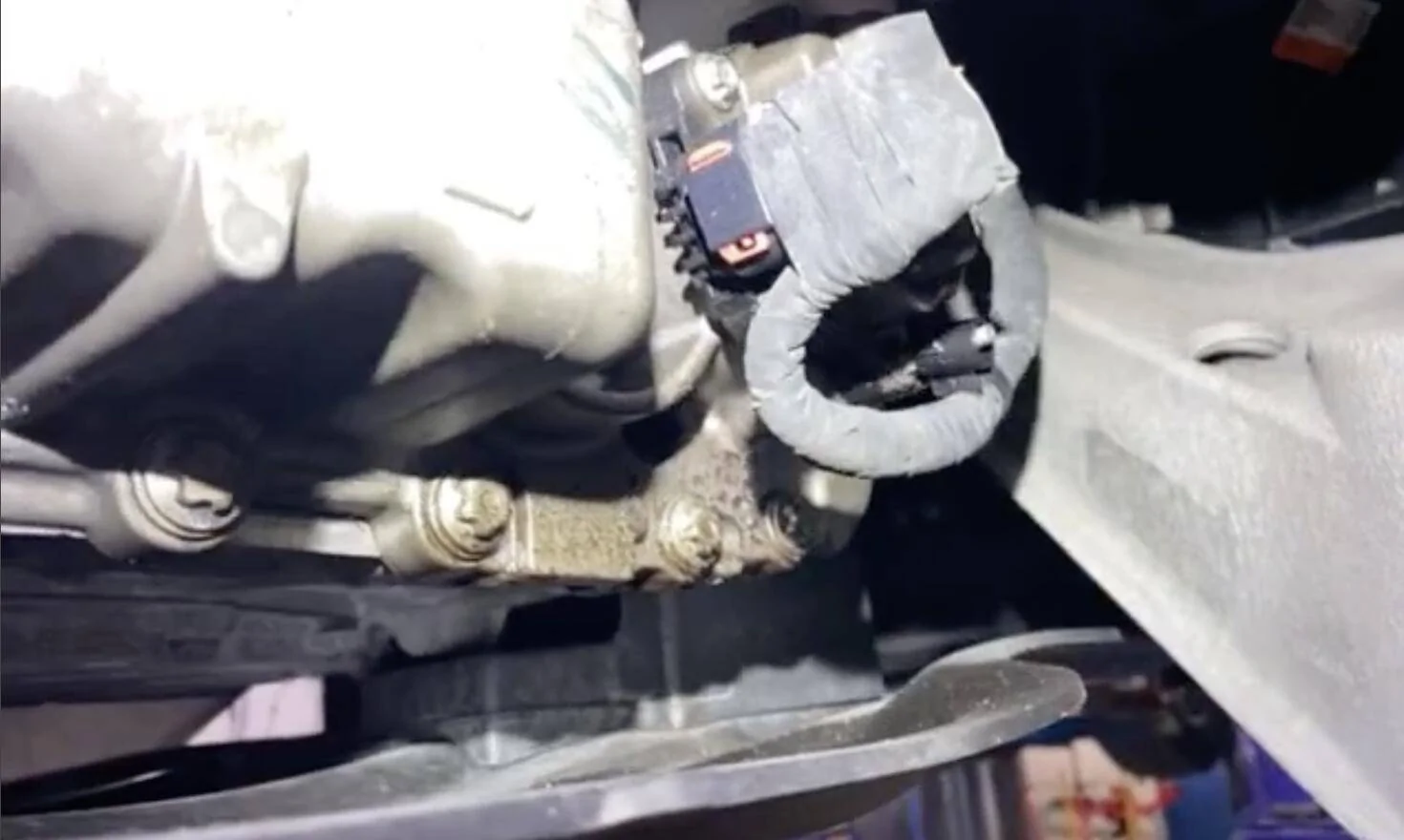

Hey all, I brought my truck in for a recall item, and they found a leak during the inspection. Using search, I did not find any like issues. Has anyone else seen this issue? I'm concerned this could become a big issue as they look to start working on it next week. Thanks!

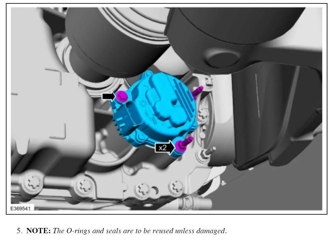

Could be o'rings, oil pump, oil filter, axle output seal, or electronic interface plug

Thank you. I will update when I hear back.

Here is an update on the issue here. The problem was a leak from the seal on the oil pump on the rear motor. They ordered the part, replaced it, and refilled the oil. I'll report back if there are further issues.
