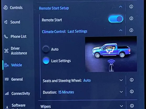

Agree with Rick. I was helping a member trouble-shooting HSW remote start and I couldn't get mine to work at all last week. But it worked fine last night.
Make sure it is enabled in Settings..Vehicle
