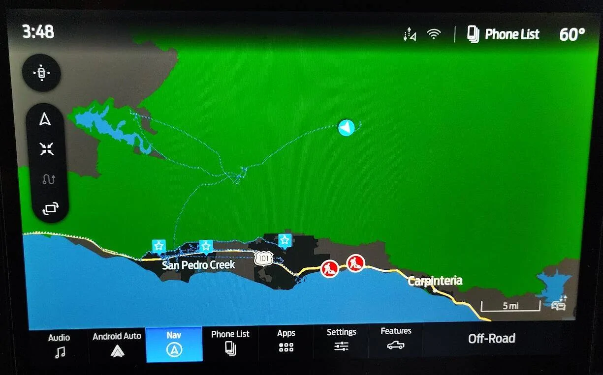

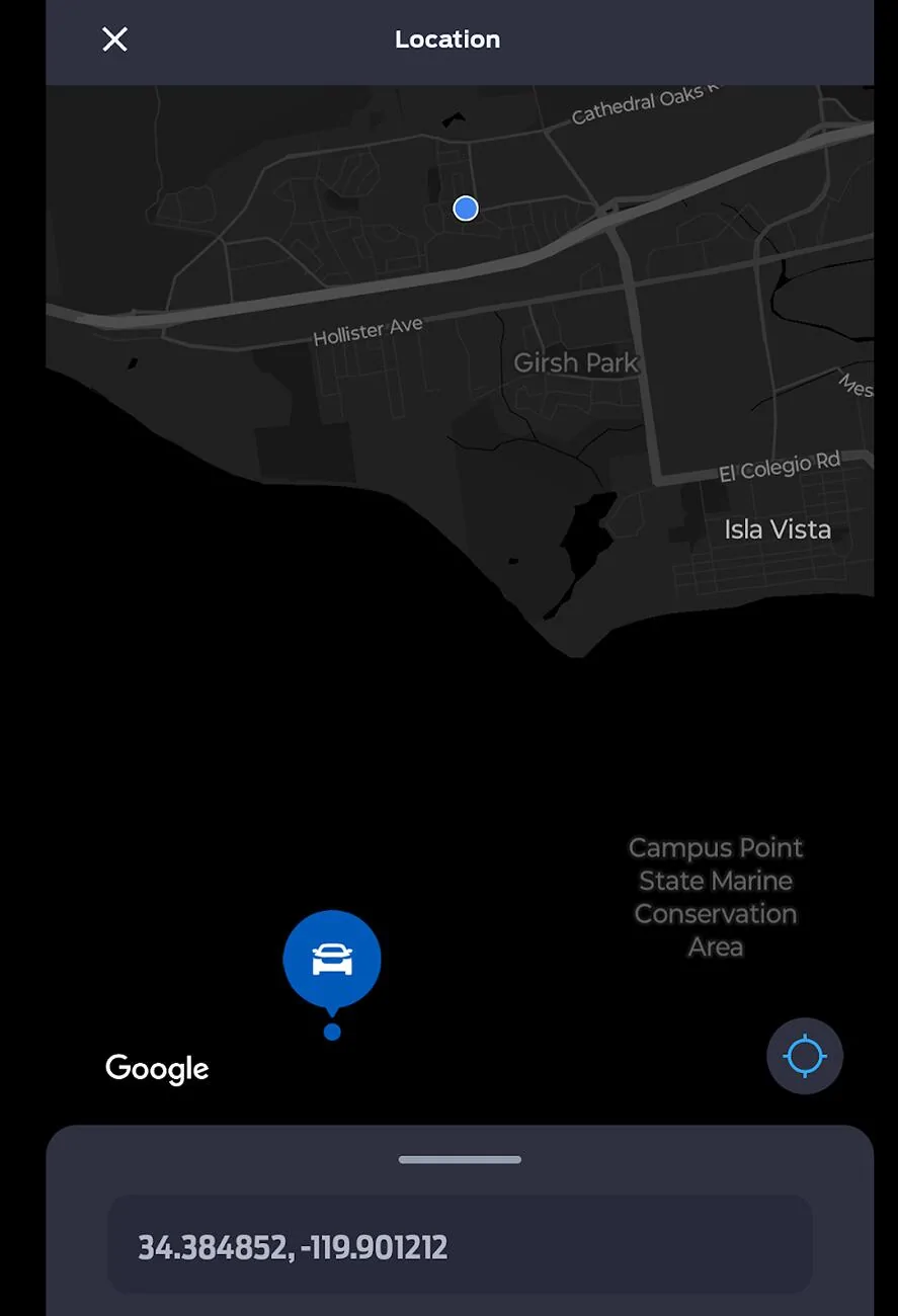

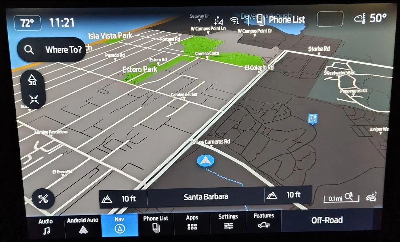

As for the so-called "Sync" systems, I hate it when the Ford Navigation GPS location is lost when I am parked at home (a supposedly known location) and the charging goes to 100%, even though "one time" charging was set to 85% previously and no updates have come through lately. Last couple of days, my truck has either been in the ocean or deep in the roadless part of the national forest [even Android Auto is taken over by the Ford GPS for both G-Maps and Waze]. January, 2025, I will take it in for the latest Customer Service Programs and hope for that problem to finally go away after 2 years of not so intermittent problems. I wonder if Ford would give me a couple more years of free navigation before it runs out. Public charging location finding sucks as well.
Is it possible the GPS antenna has come unplugged ????
Tech replaced a cable connecting circuit board long ago for an attempt at a fix, but not reliable. If GPS was completely unplugged, I would expect no change in location when driving, but [AA and] Ford Nav just wobbles off road and leaves the blue breadcrumbs on the maps listening to Russian Global Positioning Satellites perhaps.
Maybe cooler weather has shortened the cables just enough to freak out the system.

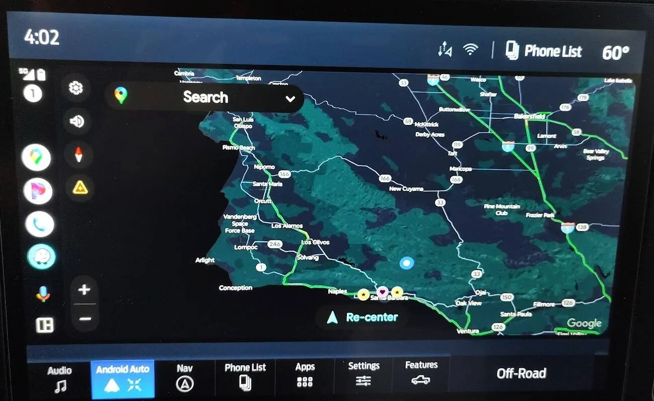

But I was also waiting for the SSM 52574, APIM update needed to fix Sync4 static, etc, problems, to be ready to go...any idea on this SSM? There is a thread on this, I believe, from May, 2024? At least August: https://www.f150lightningforum.com/...4-solutions-being-developed.19619/post-411460
Anyone have access to OASIS to monitor the promise of SSM 52574?
