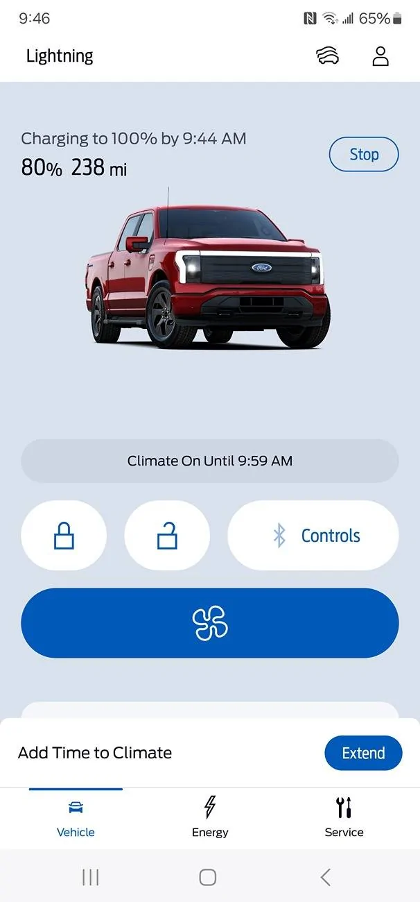

I don't use the remote start feature often so I don't know if this has been this way for a while, but it seems like incorrect behavior to me.
I have my charging set to charge to 80%. This has been working fine for me for many months. My truck was plugged in last night and correctly charged to 80%. Since it was chilly this morning and the truck was still plugged in, I decided to remote start it to use the plug energy to heat things up. But once started, it also started a charging session to 100% (see top of screenshot). Interestingly, the message implied that the charging would finish 2 minutes ago :crazy:

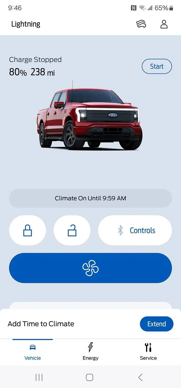

I clicked on the Stop button and the charging did stop. When I went out about 5 minutes later, the remote start was still working as I had hoped and expected.
Ford F-150 Lightning Remote start results in charging to 100%? Screenshot_20241016_094627_FordPass
Seems like a bug (or two) to me. I would have expected the latter behavior without having to stop a charging session I didn't want in the first place.

I've seen that in the past, it's just topping up a fraction of a percent SOC from your prior bulk charging event, after the pack cools down, there is a bit of settling in values, so during remote start or departure timed start, the charge controller will top up to programmed value (80% in your case).
The message needs perfection, but the actual action is fine.

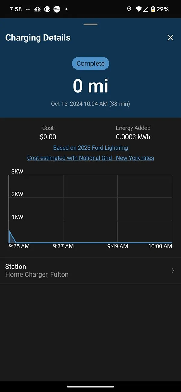

I remote started this morning at 9:45am and no draw on the charger.
Are you seeing a draw when you remote start?

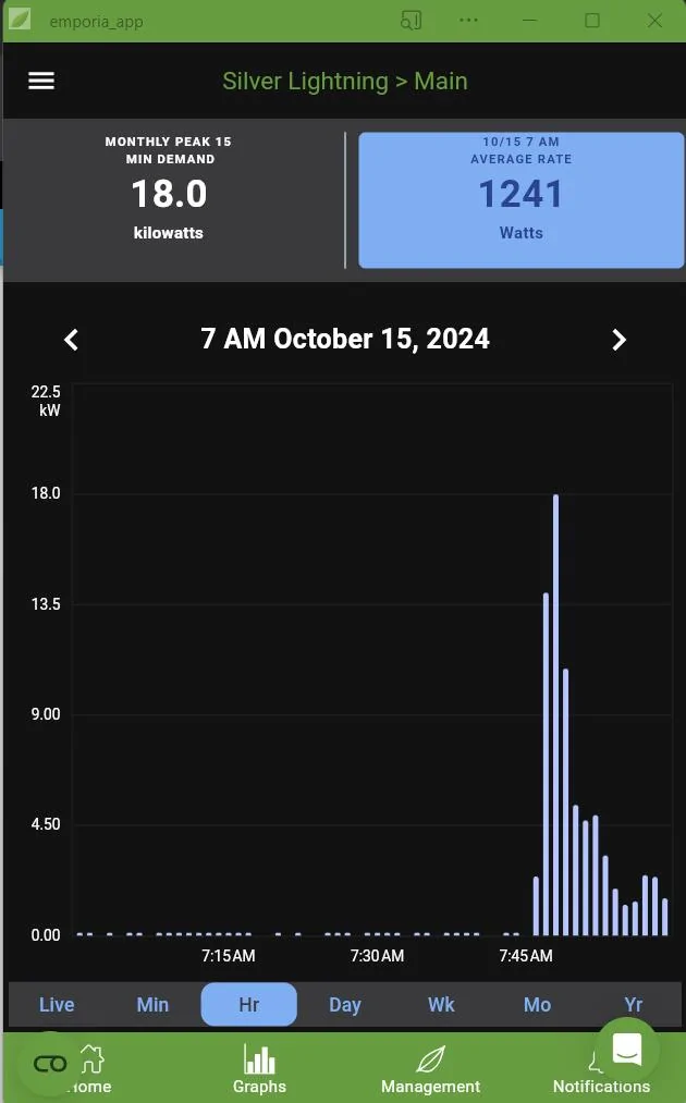

When I'm plugged in and remote start, I will see energy draw on my FCSP and my Emporia Vue2 energy monitoring system. My truck was charged to it's 90% set point the prior night, then at 7:46 I started the truck, briefly drawing 18kW, then it tapered down, finished at 8:01.

Ahh yes, I do have a schedule set for 11:00pm to 7:00am to charge my truck that is probably my issue with the test. I'll remote start before 7:00am tomorrow and see what the results are.

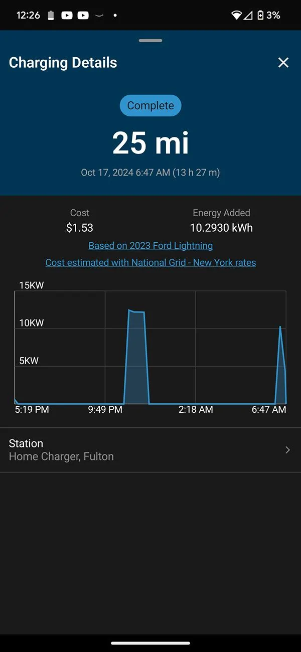

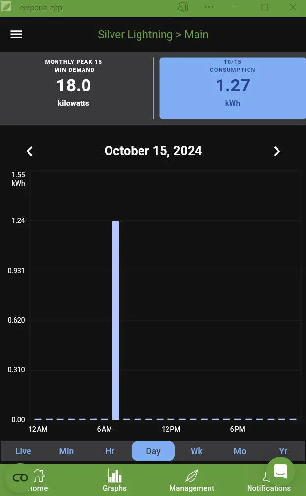

I do see the remote start using the house power now that I did it during my chargers schedule time. ? About 1.2kWh at 6:30am.
I'll be using the remote start instead of Precondition this winter.

Thanks for the report, this reinforces my belief that some folks might run into this issue than realize, but then again it's only 1.2 to 1.8 kWh, which computes to 3 to 5 miles of potential range lost.
