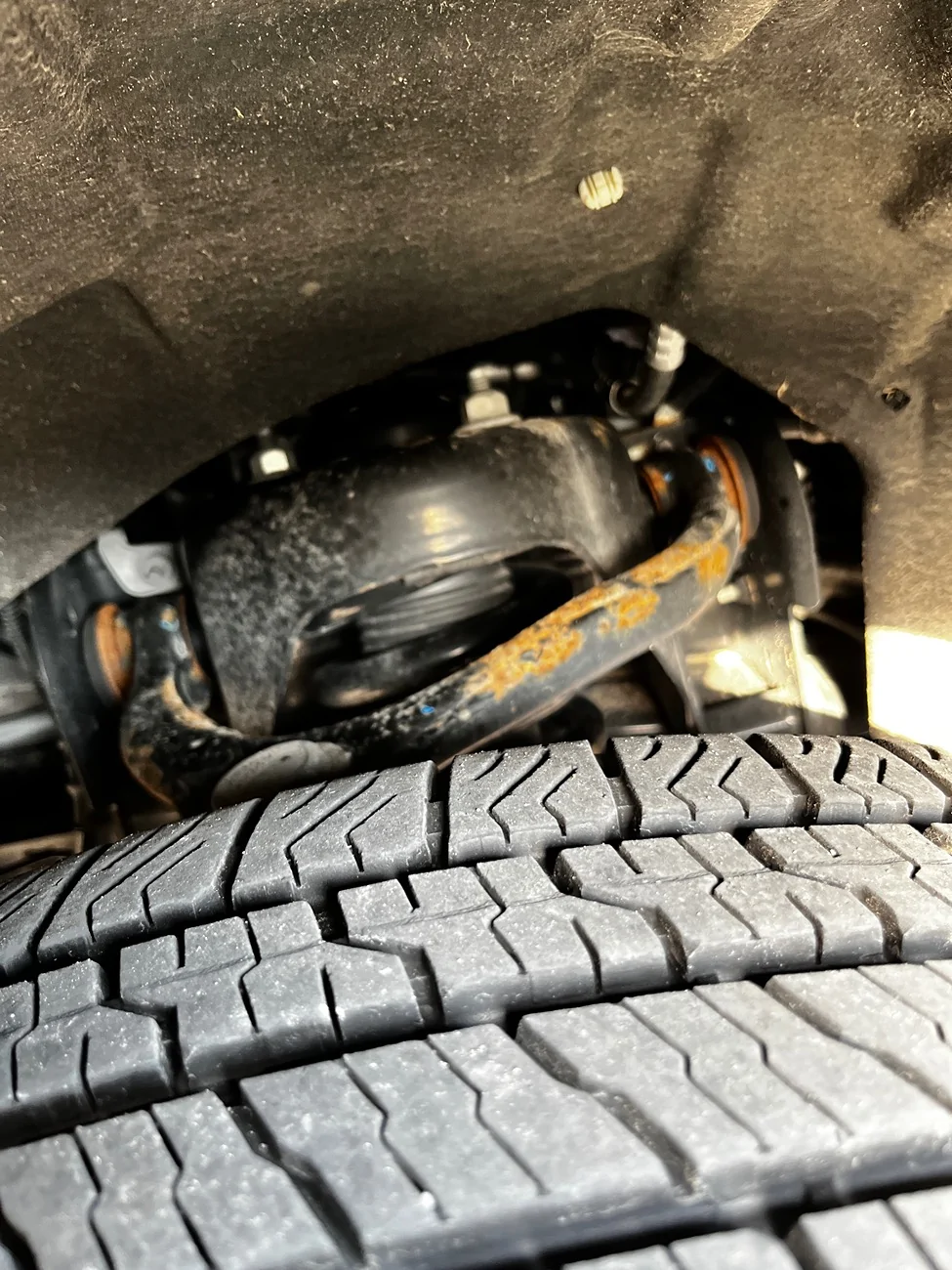

Just checking if anyone else is experiencing this rust up in the front suspension area. This is a 25 flash I got July last year. It has been a brutal winter but should I be worried

I wouldn't worry about it, the upper control arms are beefy steel.

The joys of living in chemical road states! Just clean and hit it with some black rustoleum. Good as new! I touch mine up every 2 years or so in spring. Same for trailer hitch, etc. Just go to an old parking lot and give it 10 mins after you're done so no dripping.
