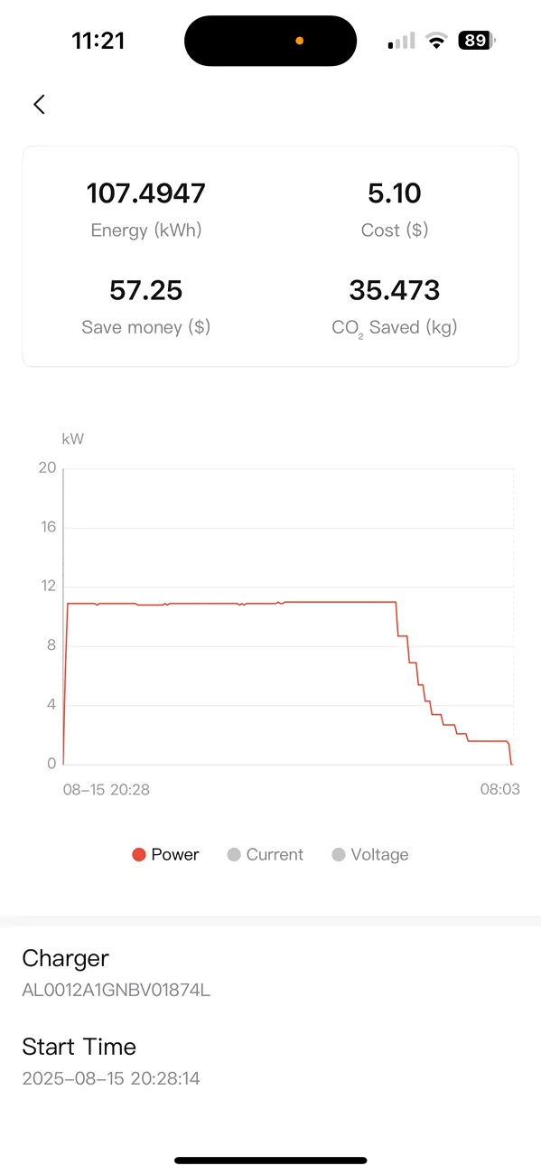

Well it seem the truck finaly abid to its specification. Knowing lithium chemistry it means the battery pack was in a "balancing mode" between the different cells which means maybe the vehicle needed to reequilibratre the voltage of some of its internal components. Now it charge regularly at 10.7. Nothing changed on the home charging station setup.

So the dealership did nothing and it just started charging like it was supposed to?
Do you charge to 100%?
