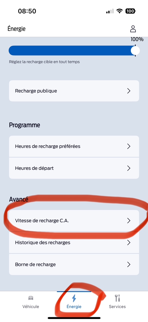

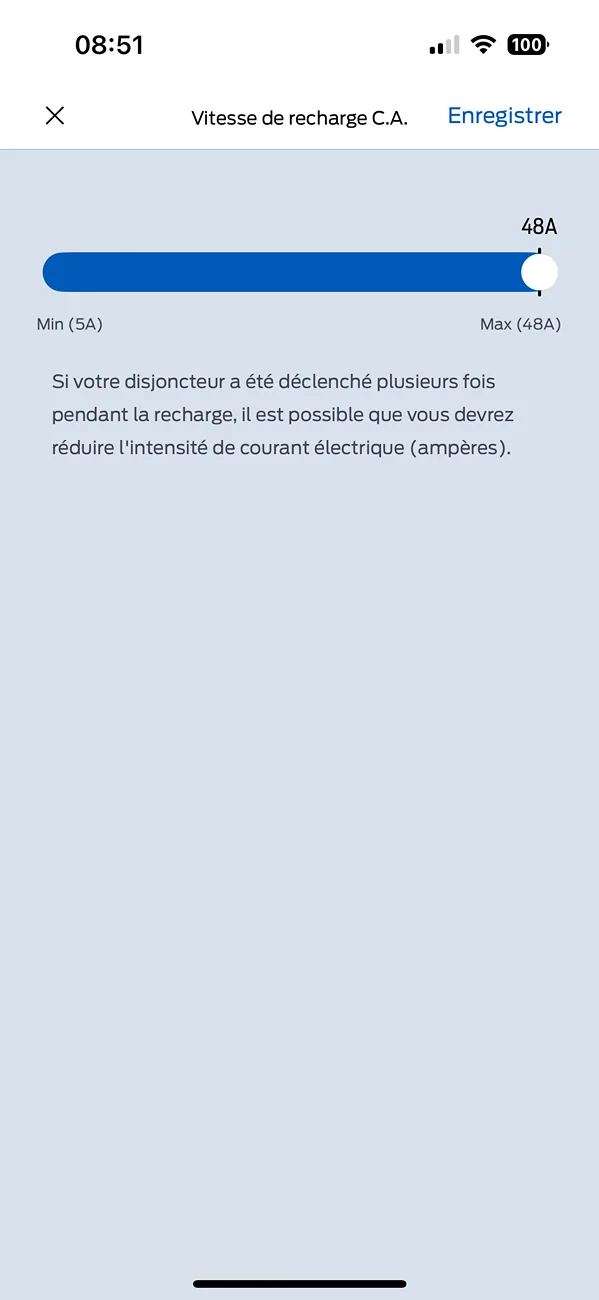

The charging speed in AC is programmable in the Fordpass app under the Energy label.
Can we see a screenshot of this? I haven’t seen this before or mentioned before by anyone else. Maybe a new model year thing?

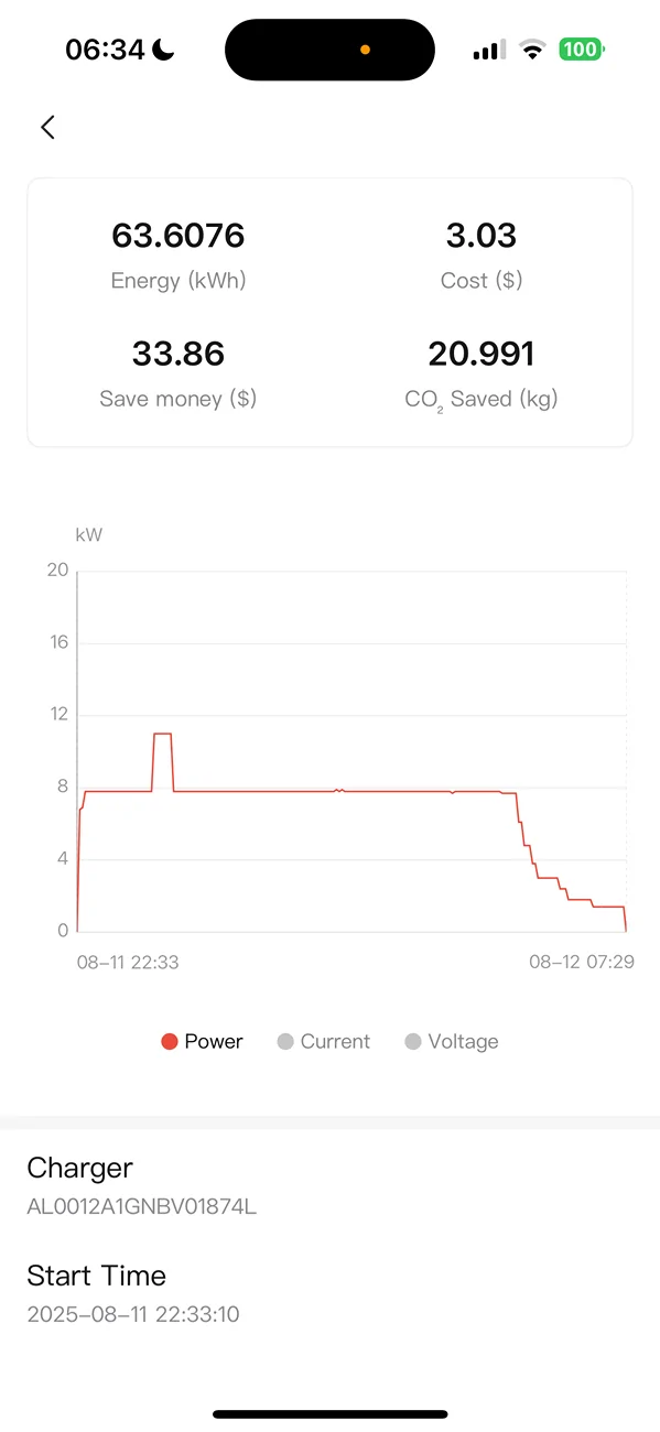

Not at all and thats the funny part of it. It behave like it has a 8 kw charger and with some occasional spike to 11kw.

I have a BMW I4 that happily charge at 48A on the same charging station and has been doing so for the last 2 years. I never saw anything under 48A with that car. Clearly the Ford is restraining the current. I have an appointment with the dealer i can't wait to see what they will find or tell me, i'm an engineer so i understand these things they can't fill me up with anything.

i just found the 2025 specifications and its clearly stated that the vehicle is capable of 48A and its not stated anywhere that you absolutely need a Ford Connected Charge station to attain it. Which give me legal rights to either return the vehicle because of non conformity or ask for a free Connected Charge + installation.

This is my charge yesterday. 8 kw for some time, a quick happiness at 11kw but for the remaining of the night its 8 kw. This puzzle me a battery so huge why does it takes it time to charge when there is more available.
Forget your 8kw. You're paying. 4.7 cents a kwh. Im at 27 cents. What cost you 3.03 for 63.6 kwh would cost me $17.17.
Yes, my 40 amp charger is running at 39.6 amps.
