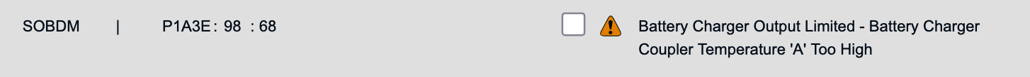

I would check the truck for a code like this:
Ford F-150 Lightning New Lightning owner puzzled at the slow AC charge 1755190996644-w8
May indicate the ambient temp is too high and the contact is getting higher than Ford would like. Even if another vehicle is charging at a higher rate, the manufacturer determines what temps they are comfortable with for these pins. That the truck is capable of hitting 11kW, clearly, but doesn't maintain it, indicates that it's slowing it down.
I don't see a dealer visit helping if this is what you are seeing because the dealer isn't going to change the Ford configured safety parameters. I would check the Autel connections for any corrosion or anything that may be leading to higher temps as well. I have seen this code thrown a few times between our vehicles when charging outside under the sun, but in the garage even at 90-ish degree ambient it's been fine.
A faulty charge port can cause that code. Usually the thermistor is out of spec, it’s not really overheating, it just thinks it is!
