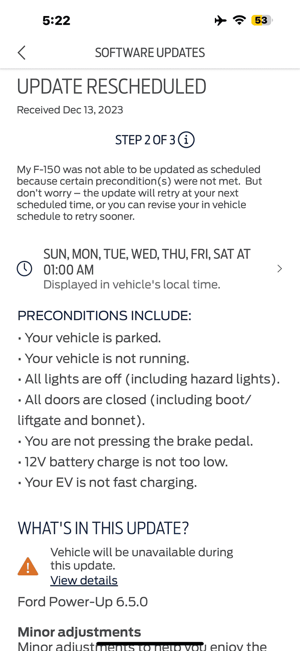

Looking back on an update failure notice received 12/13/23, it does say that all vehicle openings should be closed to process an Inhibit Mode update, including the "boot/liftgate" and "bonnet" (must have been written by the U.K./European division of Ford!).

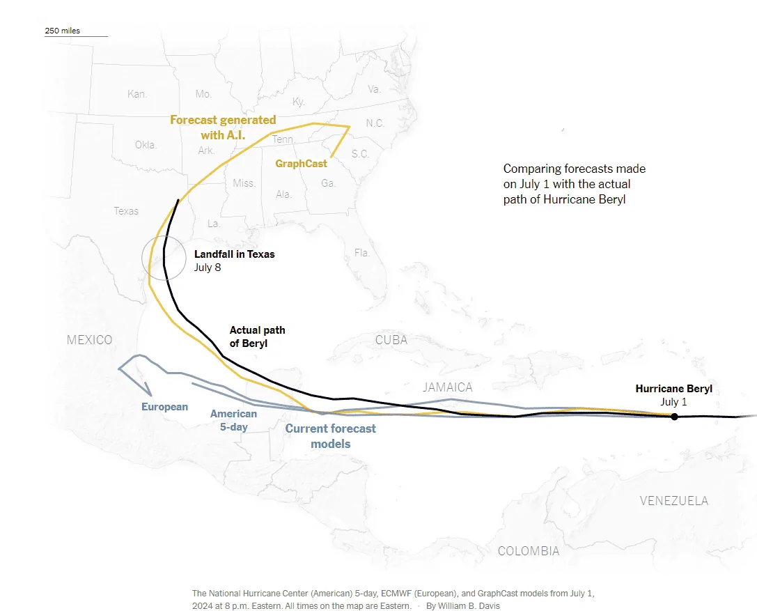

As far as the reliability of AI goes and some forum members' knowledge/comments on the subject:
Ford F-150 Lightning Software Priority Update: 23-PU1024-6CH-AUD - Refined Audio 1722483219266-y9
Source: https://www.nytimes.com/interactive/2024/07/29/science/ai-weather-forecast-hurricane.html
Yep, that’s what I was remembering. Thought I had that screenshot as well but couldn’t find it. If you’re 12V is charged sufficiently you should be fine to just let it update overnight on its own.
Thanks to you and rugedraw for advice. The AUD update worked the 2nd time around (only took 2 days to show up again on the FordPass Home screen). I charged up the LVB to about 77% (12.45V across the jump points) using a Noco Genius2, then ran the vehicle in full-accessory mode hooked up to my FCSP until Car Scanner read the LVB at 81% SOC. Closed the frunk, shut off and exited the vehicle, locked all doors, and turned off my iPhone BT. Took longer than the 7 minutes promised. I'm no audiophile, and the truck wasn't trundling noisily down the highway, but even in stereo mode, the sound seems less out of the center dash speaker than before. The rear speakers still seem weak from the driver's seat, but the sound is slightly more spatial in SURROUND mode vs. STEREO (never tried SURROUND before, AFAIK). I mainly listen to FM radio and the update didn't appear to do much for background static from poorly received channels. Alas!
