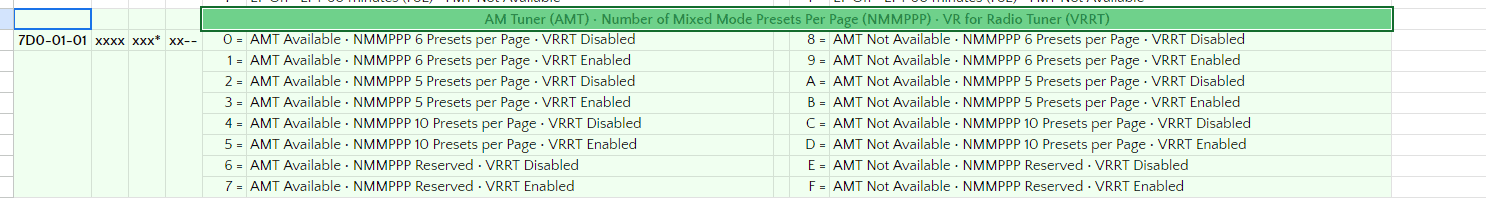

I also got the AM radio tab added today and mine also doesn’t work. When I select it, it does nothing.
I would say the key is here. I would change that value to a 7 and if that doesn't work, try an F to see if it enables the AM function.
