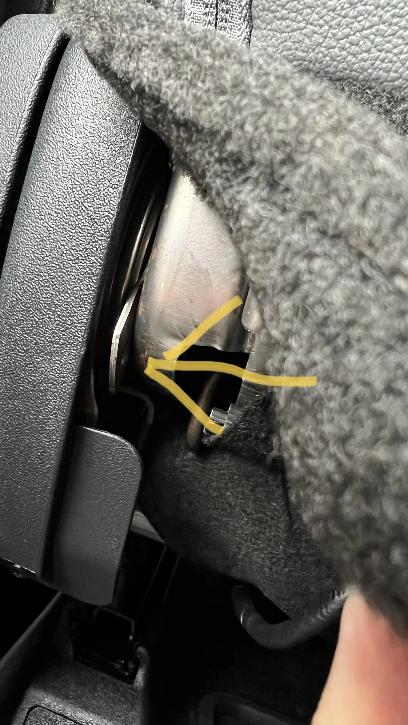

I had the same issue a few months ago and found this solution on another forum. The picture is of the back of the driver's seat, left side, at the bottom where the seat back pivots. Spraying some silicone lube in here and working the seat back forward and back a few times fixed my seat squeak, at least temporarily. The squeak returns after a few weeks so I've had to repeat this a few times. I see that Ford has reached out to you, so they might have a better long-term solution.
Just noticed that my arrow isn't very accurate, you need to spray between the two moving parts right at the pivot point.

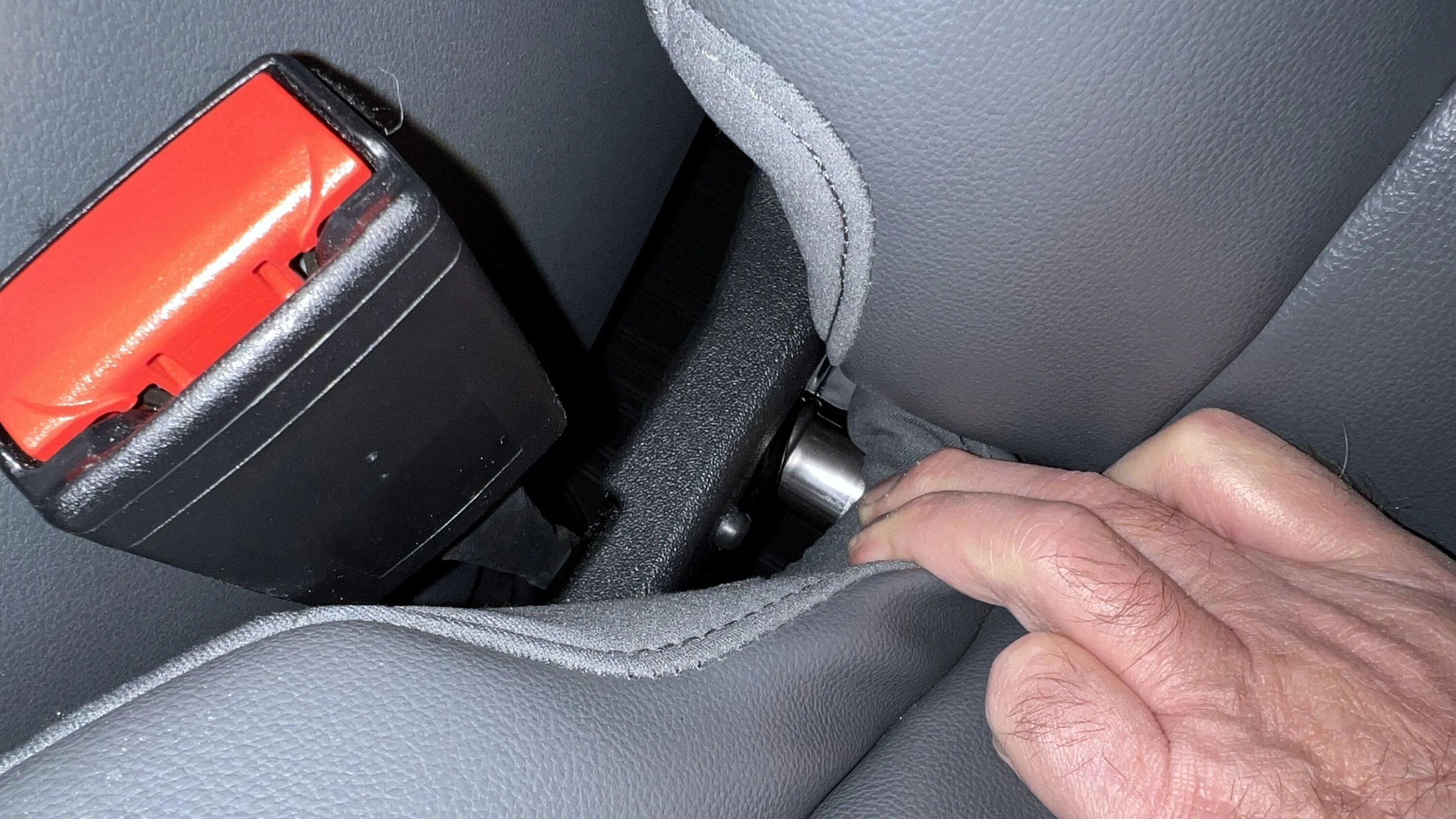

I think I've finally eliminated the squeak in my driver's seat. Sprayed silicone lube on the pivot point on each side of the seat a couple months ago and so far the squeaking has not returned.
Pull back the back corner of the seat cushion and spray the lube at the joint where the metal tube meets the seat frame. Do this on each side.
In a previous post on this thread I had tried spraying the same area, but from underneath the seat. That would eliminate the squeak for a while but it always came back. Hopefully this is a permanent fix.
FYI this is on a Pro with the manual seats. Not sure if the higher trim levels are similar.

Thanks, msadan. My Pro is squeaking like crazy and I can't stand it anymore. I will spray the areas you pointed out. Hope it will go away for a long time.
