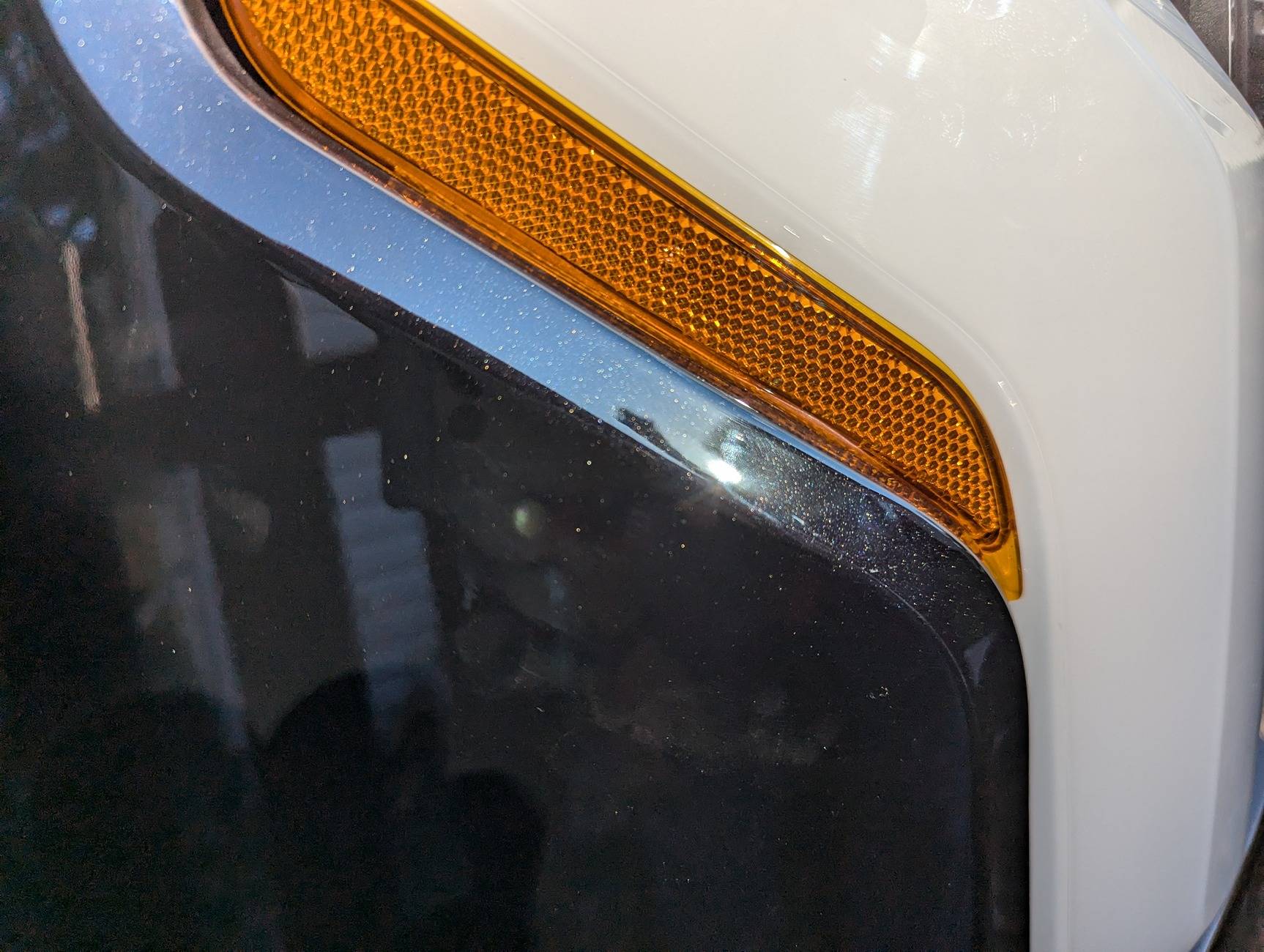

Has anyone had a panel as squeaky as this? Should I be concerned or odd this nothing to worry about? Just this one panel.

Exact same squeak from that spot. Noted it to the dealer when I picked it up because the panels are firmly pressed against each other and wearing paint away.

I have this exact same issue. I didn't notice it initially, but I found it when I was trying to figure out what was so squeaky when I go over bumps.
The panel gap between the light and the quarter panel is not the same on driver's and (this) passenger's side. There is a little nub of the panel that is rubbing against the plastic of the light. Also, the fit with the panel underneath it is not similar to the driver's side and makes a squeaking sound.

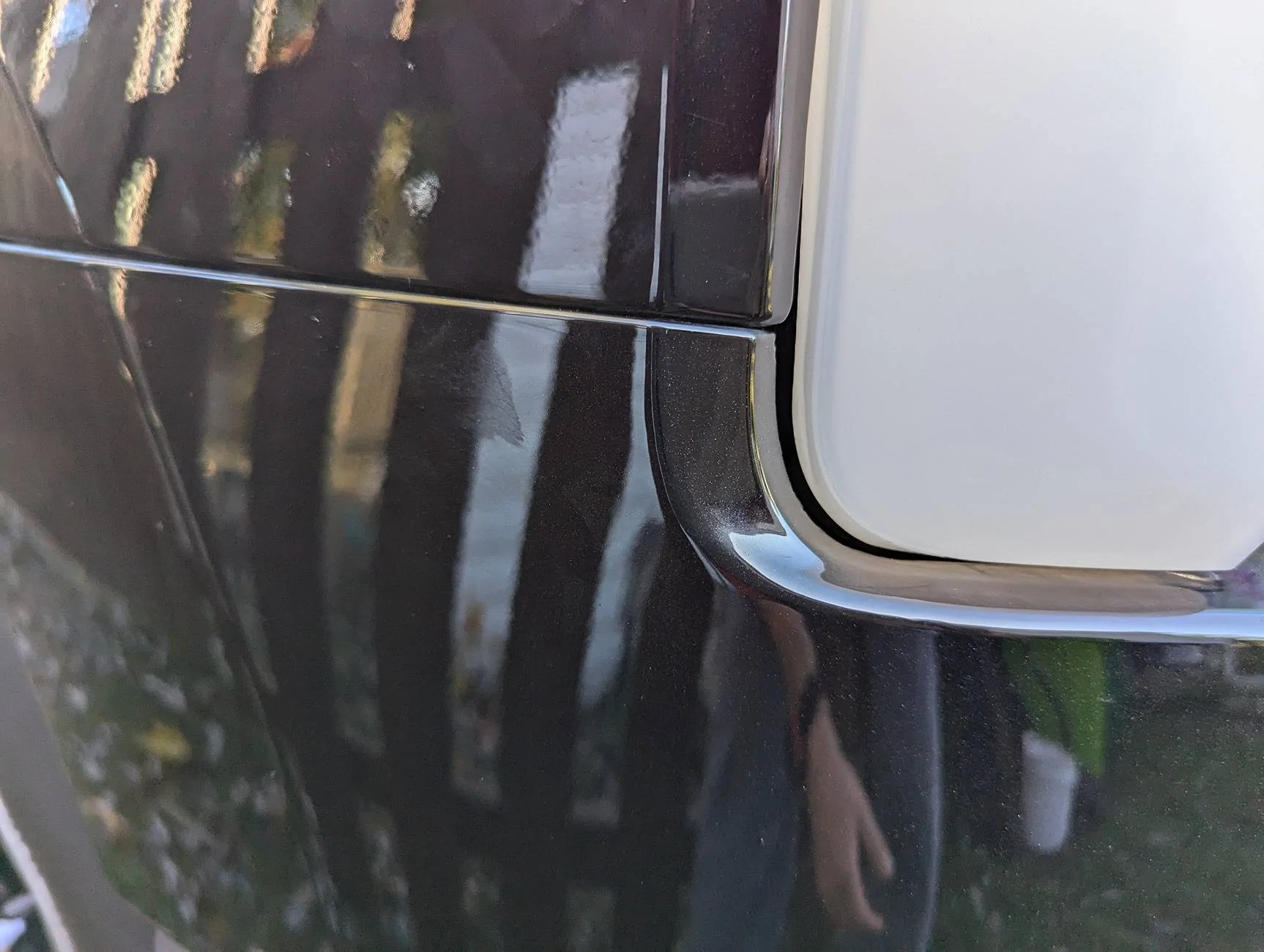

So I took it in finally to the body shop. They were pretty bewildered as to why I came to them, so I explained again that I took it to the service center at the dealership they are connected to, and I was told I had to go to the body shop. Turns out, that is not correct.
For a new car, it's the service center that has to deal with this. Evidently Ford knows all about it, and they have issued a "fix." Here it is :
Ford F-150 Lightning Squeaky quarter panel 1000004722
Evidently the headlight is loose? Not sure if that explains the panel misalignment, but ok...

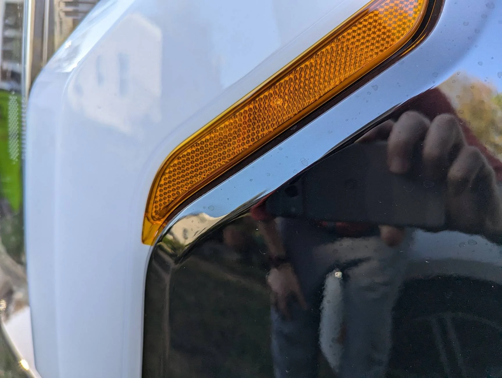

I've only had the truck back for a day, but I haven't heard any noise during normal street driving or going over speed bumps (I used to hear it often with the speed bumps). I will see how it does going over less improved roads this weekend. The panel gap is still not very good :
Ford F-150 Lightning Squeaky quarter panel 1000004724
Ford F-150 Lightning Squeaky quarter panel 1000004725
Here's the driver's side :
Ford F-150 Lightning Squeaky quarter panel 1000004726
And here's pushing on the driver's side vs the passenger's (after the fix). I'm not convinced that tape will be a permanent fix ?
