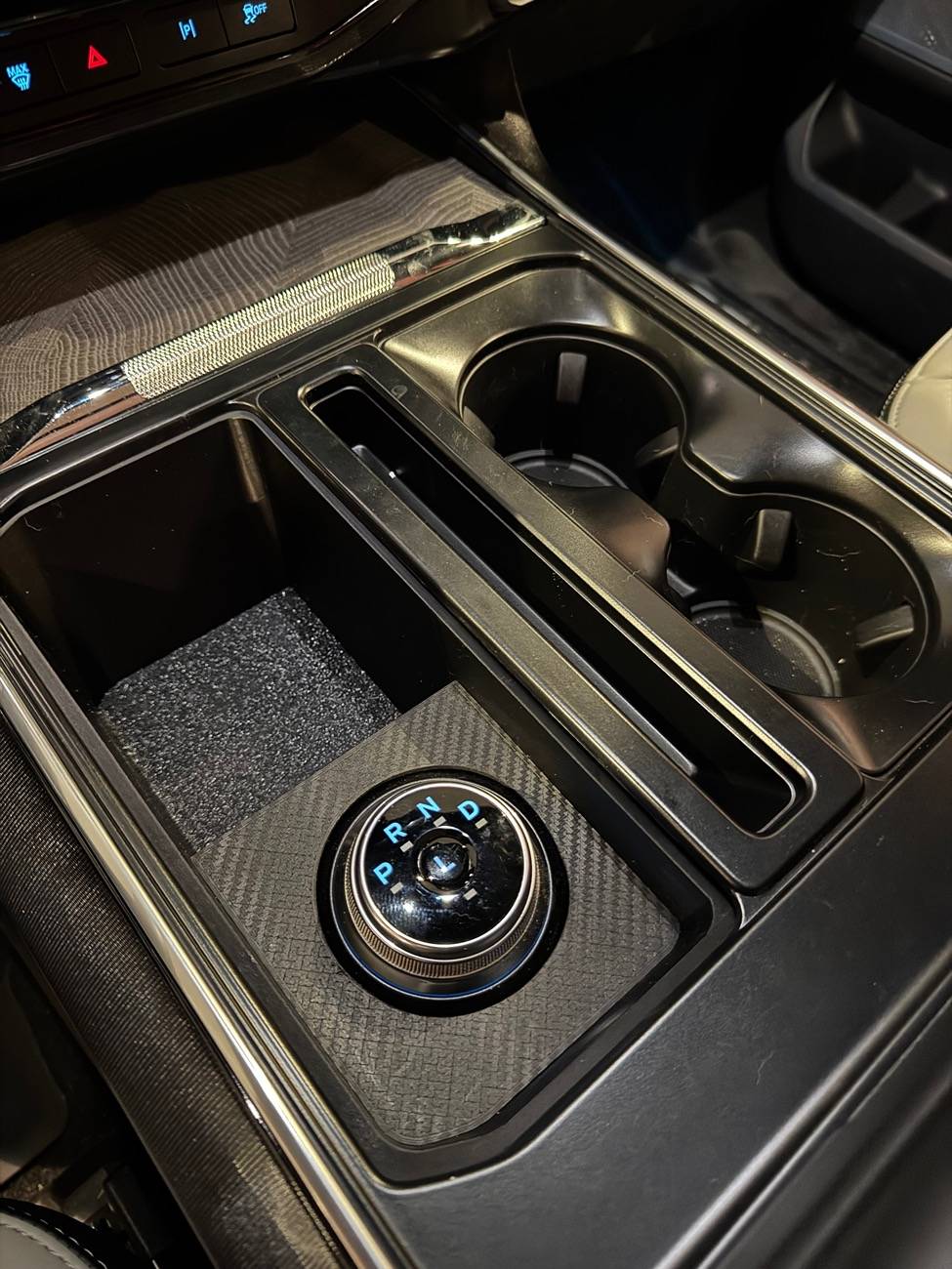

Completed everything tonight!
Took 12 hours to print everything, and only 20min to install! I have a platnium with the large screen. I did not have to remove any dash components, I just removed the two side panels and lifted up the center trim. Super easy. This is awesome!!!
ps. The “L” button activates the Neutral lock for 30min; same as the original shifter!!
Here is what I used:
  • Polylite ASA in jet black
  • Carbon fiber effects build plate, using a Hilbert Curve bottom pa
  • Ford bronco LX6P-7P155-EH gear selector
  • TPU for the tray mat makes it all look super OEM.
