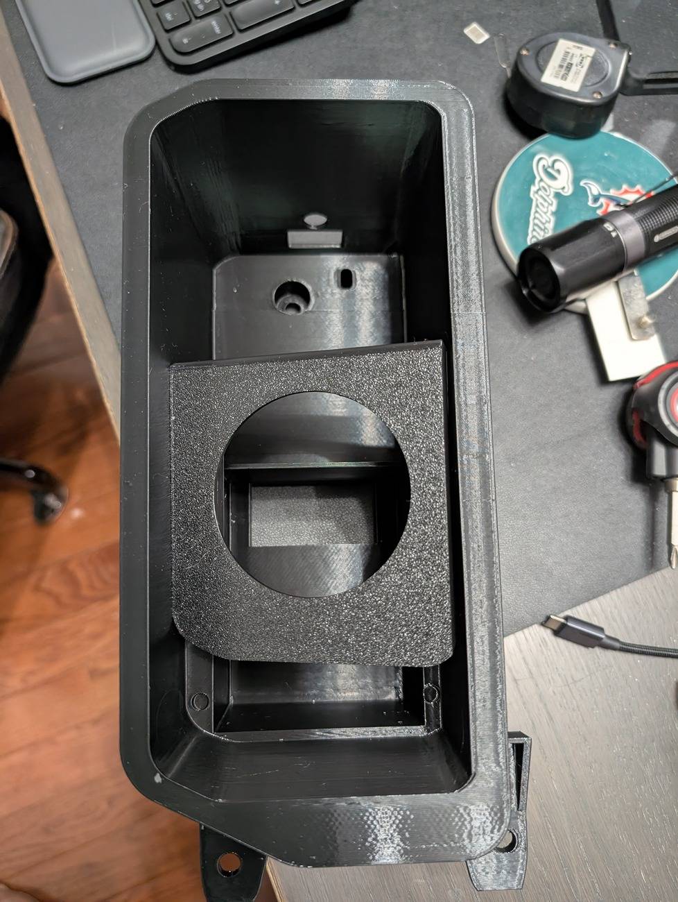

I have an extra print that I'm not going to use, its the version without magsafe or anything. Ill add a few magnets in there too. Let me know if youre interested. Looking for $40 shipped to you. I'm not trying to start selling these, I just happen to have an extra, and dont want to throw it away.

I just printed a second one with no cover. I made thr hole straight through the bottom so there is no need for magnets. I'll use a set screw to hold the shifter in place. If anyone wants either the first one I made ill sell it for 40 + shipping. I don't mind making them for people. It takes about 24 hours for mine to print. Just doing community service here on the forum. Not interested in going any further. I'll just sell as they come so I can keep buying filament.

I absolutely LOVE the final result of the rotary shift conversion in my 24 Lariat! I've seen a few different variations of this mod including cutting a hole in the dash and mounting it next to the steering wheel. I was planning on going that route but had trouble building the wiring harness. At the end of the day I'm glad I did because what I have now looks like just as OE as the dash mount, I still gain use of the workspace when in gear, the truck could be put back to original quickly and easily, the install literally too less than 20 minutes!! The first photo of the knob installed is in the raw finish how it arrives to you. I ended up hitting mine with a few coats of filler primer, doing a little sanding, and a final coat of trim black just to help it "blend in" a little. But I'm OCD like that. It totally looks good enough to run as-is.
HERE IS A LINK TO THE SHIFTER I USED. BEST PRICE I'VE FOUND ANYWHERE!
HERE'S THE LINK TO THE 3D PRINTER CUBBY/MOUNT
The mount will likely show "SOLD OUT" but just message him directly and let him know you want to be on the wait list. Ever since posting mine on a couple Facebook Groups, he's been getting slammed with orders.

I designed this version and I'm happy to answer any questions anyone might have!
Sorry if I missed it, but with this version I'm assuming that you have to cut the mounting tabs off the shifter since it appears that it drops in from the top rather than screws in from the bottom ?
Is it a tight squeeze or is double sided tape or something recommended to hold it in place/make it rattle free ?
Yep, I cut the tabs for my version and so far there has been no rattle at all. If some were to develop, it would not be hard to pop the lid off, add some felt tape, and close it back up.
