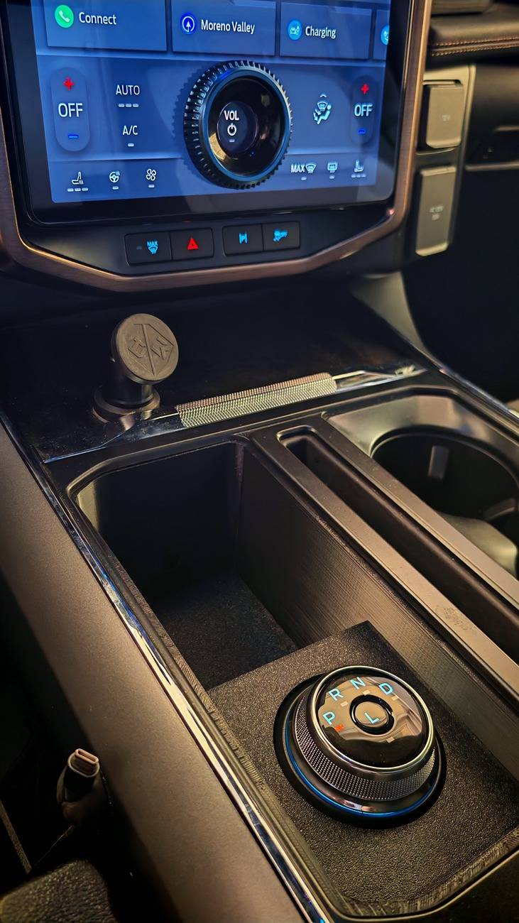

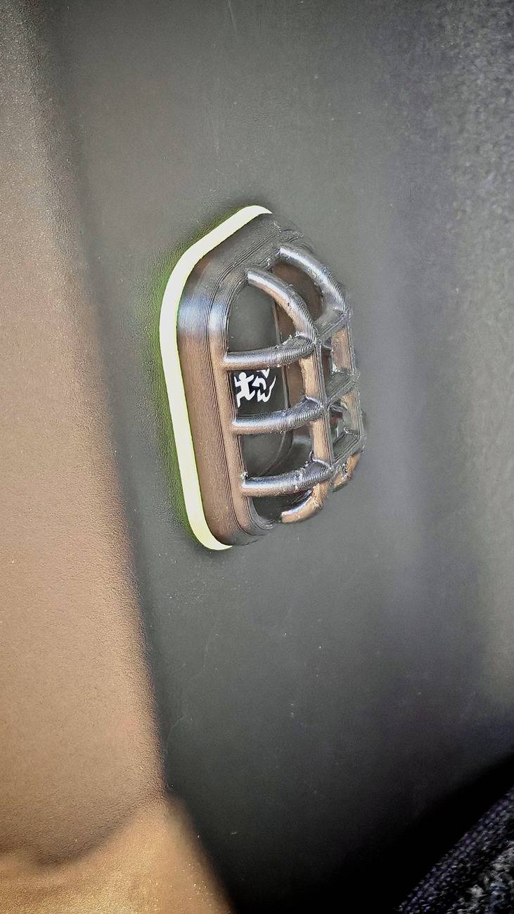

This has to be the best mod you can do on the Lightning! Thanks to Thanks to @Drayday55 for printing it for me his version which is perfect. Also the under seat air vent extension and Frunk button cover. The air extensions worked well for my

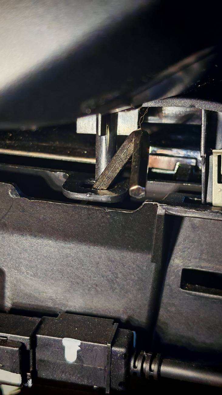

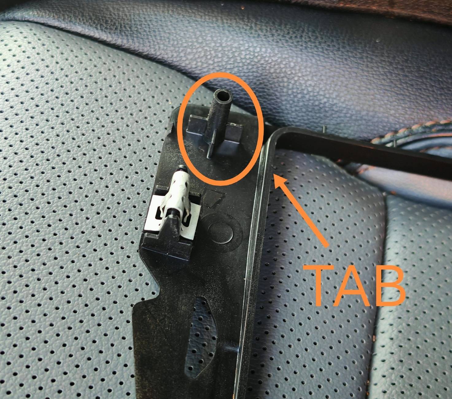

One note on the install, when taking of the center trim piece the video shows to pull towards but there is a plastic pin in a hole that needs to be lifted up but the center screen is blocking it from coming out of the hole it is in. You have to pry the hole down and the pin up to get it out, I also put a L- wrench in the hole once I had the pin out of one side to keep it from popping back in while prying the other side out. If you just pull I'm sure that pin will break, although not a big deal as it's probably not needed.

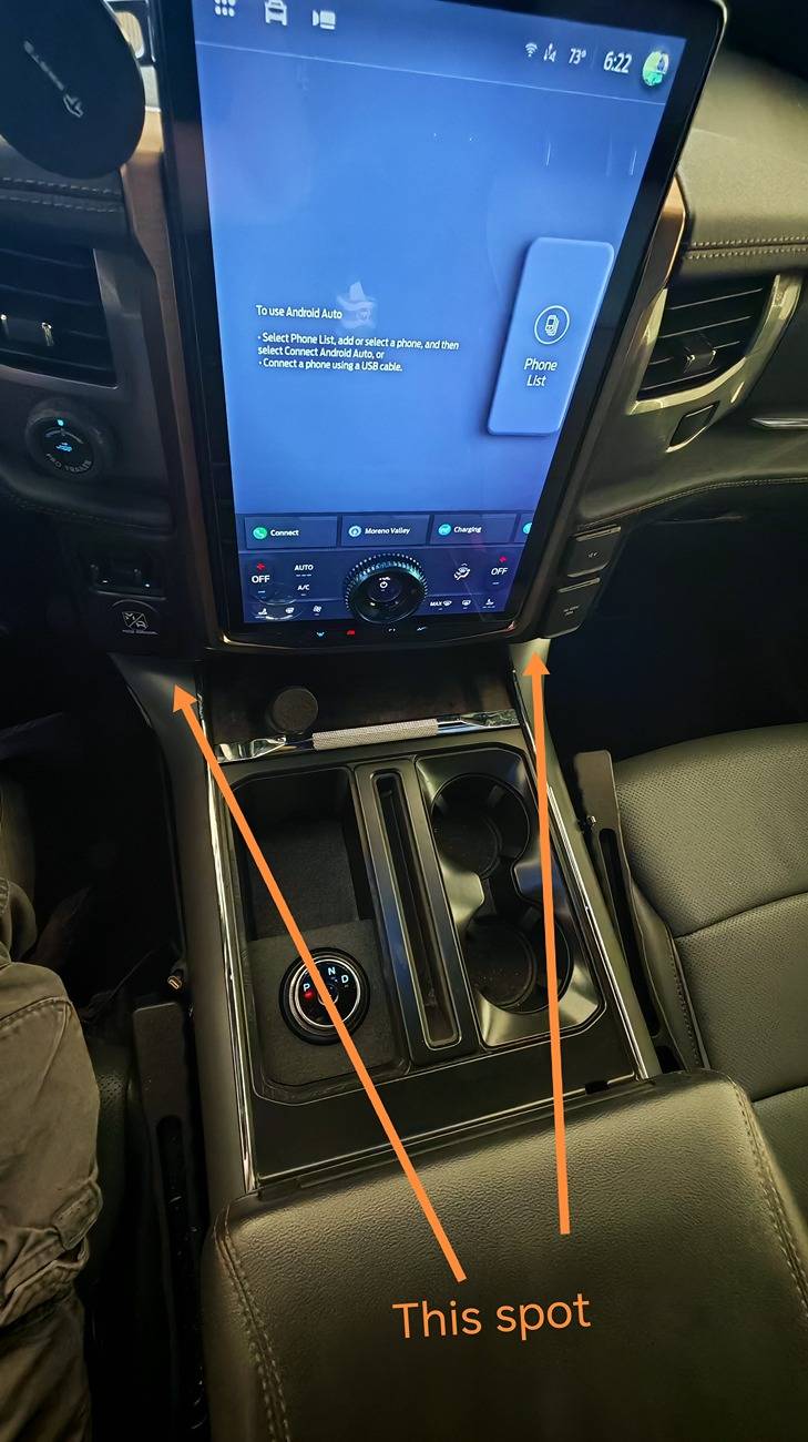

Thanks for the detailed information regarding the ā€˜center’ trim, but I’m still a little unclear on where that is located. Would it be possible for you to shoot a pic from the outside of the console and point out about where it is located?
Many thanks.
Many thanks.
