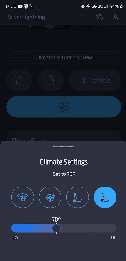

Just finished my test with truck being plugged in, charge had completed a couple hours prior [12.6 kWh], then let it set until around 5:30, started the remote climate session with the following features switched on [cooled seats], prior to parking the truck I confirmed my trucks basic setup is remote start permitted with 15 minute cycle time and automatic conditioning of cabin / seats / wheel. While the main HVAC console showed Auto-3, AC on/available, last used seat condition was cooling-3.
After letting it run for 15 minutes, I went out to see if the seats were cold or hot, found them to be chilled nicely, pressed the START button to full run status, Sync screen confirms that seat cooling fan-3 active.
Ford F-150 Lightning Stupid defaults on (new) Fordpass Climate pre-start 1720475884721-uf
Interestingly this fifteen minute event pulled in 1.5 kWh of energy over and above the initial charging from 81% to 90%, I suspect the battery ~settled~ during the down time, so the OBCC kicked on for a couple minutes to re-top the battery from a fraction under 90% back to 90% certain, then the remaining energy draw is to replenish the load of the HVAC system compressor, seat, evap and condenser fans.

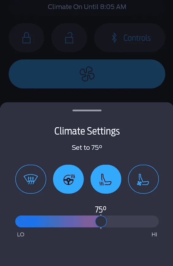

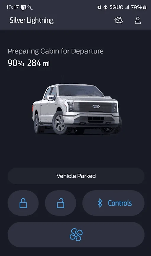

Did a departure timer test this morning, truck was plugged in & already fully charged from Mondays testing, didn't drive the truck Tuesday, still at 90% SOC outside temps low 80's inside garage same.
Set the leave time for 10:30 am, truck started with conditioning cabin at 10:10 and finish alert notification came in at 10:30. Truck was nice and cool, seats & wheel were cold.
The fan icon does not animate like it does with remote start, but you do have the text message that cabin conditioning is in progress.
