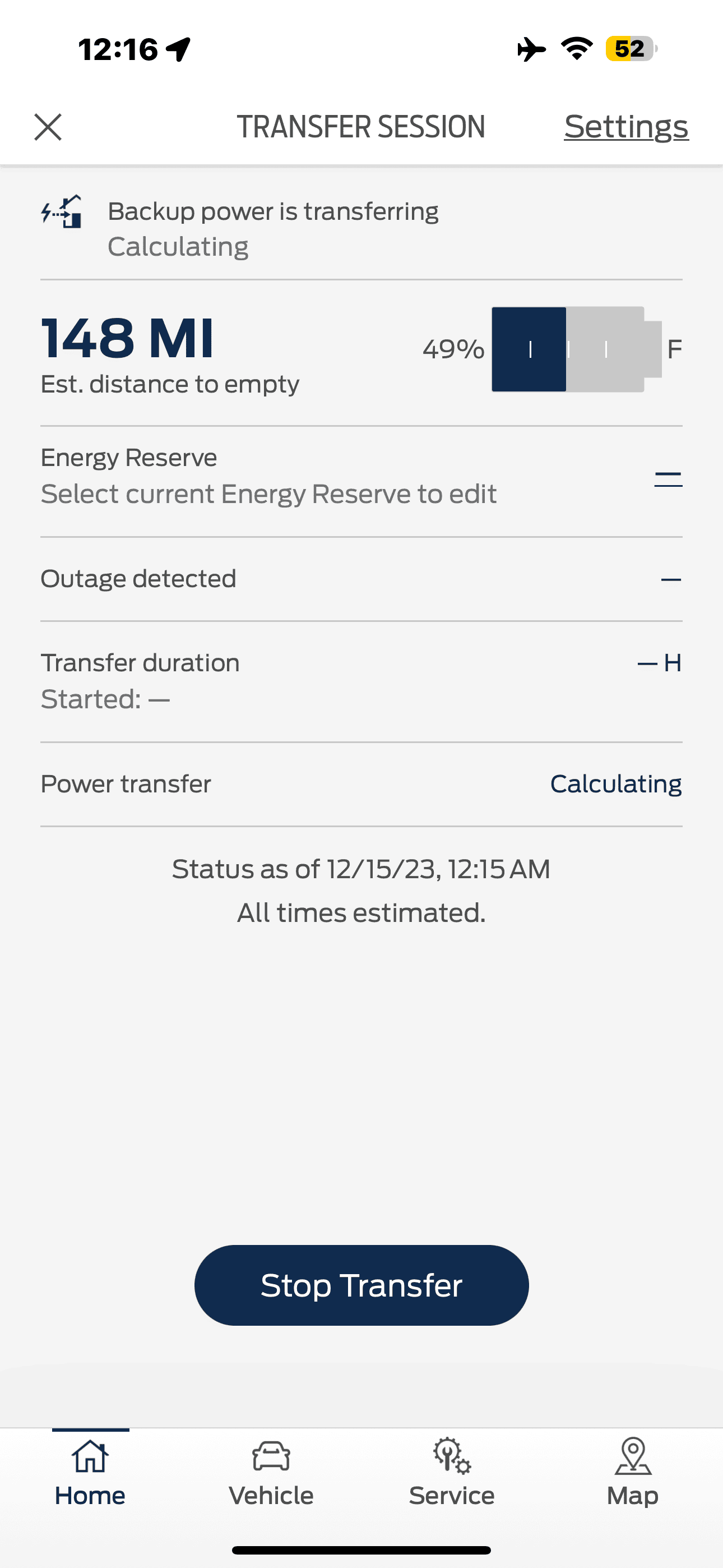

Further update on the reliability and trustworthiness of Ford's backup system.
I'm sitting in my kitchen. No power outage for sure as neighborhood Christmas lights are glowing all around me. I see the FordPass app on my iPhone hasn't updated in several hours. So, I swipe down from the top of the screen. Apparently, that initiates a Power Transfer (if you believe everything the FordPass app tells you):
Ford F-150 Lightning Installing a Home Integration System for Intelligent Backup Power (without SunRun) IMG_0680
Click on the DETAILS button, you see the following:
Ford F-150 Lightning Installing a Home Integration System for Intelligent Backup Power (without SunRun) IMG_0679.PNG
Clicking on the STOP TRANSFER button just causes a page-loading circle to appear and go round-and-round. :rolleyes:
Throw open the door to the garage. The truck is doing nuttin'.
Ford is like the Boy Who Cried Wolf. So much crappy information out of FordPass that when the app throws up something real that's life-or-death important, one might not believe it for all the previous white noise.
Edit_Update: I got out of the Power Transfer quagmire by turning off Automatic Transfer in the Intelligent Backup settings in both the Sync screen settings and in FordPass, then saving to the cloud my altered FordPass settings. After my FordPass Home screen notification button went back to WAITING TO CHARGE, I changed back to Automatic Transfer both in the truck and FordPass settings and the Power Transfer in progress notice hasn't come back. Maybe changing settings in only one place would be sufficient. I'll try that if the Power Transfer accident happens again.
