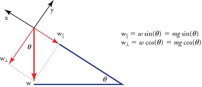

Actually the bottom of the ramp is presumably on the ground so the weight is divided between the earth and the tailgate. If the ATV is ifully on the ramp, e.g., in the center of the ramp, 1/2 the weight is on each supporting end, ground and tailgate.
There are perpendicular and horizontal components on every part of the ramp and assuming the ATV has both wheels and all its weight on the ramp (no wheels on the bed or ground) half the weight is on the tail gate and half on the ground.
Ford F-150 Lightning Tailgate Load Capacity and Heavy Duty Cables ramp weight diagram
However there are other considerations besides weight, i.e., controlling the loading and unloading of the ATV. Too steep and angle and it will be difficult to control unloading and loading. The rule of thumb is to use an angle between 16 and 23 degrees for safety in controlling the loading/unloading on a ramp.
"...To find the right loading angle, you will need to know the length of the ramp and the height of the secondary surface (the surface the ramp is leading to), like the back of the truck you’re loading the machinery onto.
If you’re keen to test your math skills, now’s the time to break out the pencil and paper, as well as a trusty calculator. In order to find the angle of your existing ramp, follow these steps:
  1. Begin by finding the ratio between the height of the secondary surface (the rise) and the length of the ground the ramp covers (the run), as opposed to the length of the ramp itself. This should be a 90-degree angle.
  2. To calculate the angle of your ramp as it stands, use the arctan (inverse tangent) function on your calculator with the following formula: slope (angle) = arctan (rise over run).
  3. Remember, as mentioned above, your desired angle for loading ramps is typically 18 degrees, with the safe loading angle range between 16 and 24 degrees. If your calculated angle is outside of this range, you may need to adjust the ramp’s length or the secondary surface’s height. Ensure this is done safely...."
From: https://www.bunyipequipment.com.au/need-to-know-safe-loading-ramp-angle

Draw a force vector diagram. Any weight on the ramps will be split between the tailgate and the ground. The split will depend on the angle and the point of contact on the ramp. As long as the front tires are in the bed before the rears come off the top of the ramp, there’s no way the tailgate will ever see the full weight of the AtV.
The split is always 50:50 if the ATV is all on the ramp.

Remember, 'weight' is a force, it is the acceleration due to gravity times the object's mass, or from physics:
F=ma (force = mass x acceleration)
The "a" is due to the curvature of space-time the mass of the earth produces, as Einstein explained in relativity.
So the weight of the ATV has a direction normal to (perpendicular to) the earth (ground), no matter what the angle of the ramp is, and the force (weight) will be divided between the supporting parts, in a simple ramp, the two ends. You could always put additional supports between the ground and the tailgate to divide the weight further.
