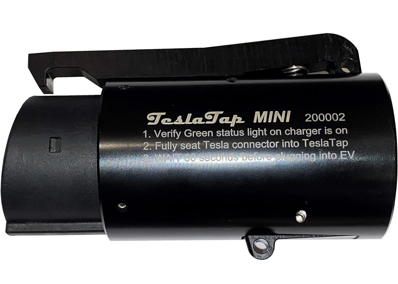

I have been using the Tesla Tap mini rated for 80 amps continuous. It’s all moot at this point as I’ve ordered the Tesla Universal Connector Just providing this for the record
Ford F-150 Lightning Tesla Gen3 Wall Connector Warranty Voided by Charging Non-Tesla with an Adapter IMG_9168
Additional details from the website
Authentic TeslaTap MINI LIGHTNING Version – MADE IN USA .... YES, THIS ADAPTER DOES WORK ON ALL WALL CONNECTORS and DESTINATION CHARGERS including Gen2 and Gen3. The TeslaTap MINI has O-Ring seals on all Tesla and J-1772 pins and is virtually waterproof. TeslaTap adapters have a special circuit that allows you to charge your non-Tesla EV on ANY Tesla Destination, UMC, or High Power Wall Connector. Safety is the most important issue and our adapters have all of the pins needed to maintain full functionality and safety protocols used by both Tesla and J-1772 charging systems. This adapter is NOT COMPATIBLE and will not work with the Tesla Supercharger Network. We do not list all of the vehicles that are compatible as our bypass circuit makes the TeslaTap MINI 80 compatible with ALL US built EV’s with a continuous charge rate up to 80 AMPS @ 250V (20 Kw). TeslaTap has a US Customer Support line that you can call or email if you have any type of issue using their adapters. Clarification: Tesla is the registered trademark of Tesla Inc. and is not affiliated with TeslaTap.
That is a high quality adapter, from one of the original brands ever made - I have and use this one as well as the Typhoon from A2Z on multiple vehicles for several years now.
I used to use it on a Gen2 at home, I have since replaced it with Gen3 Universal, and I still use the adapters on the road when I need. With my Gen3 Universal, the handle has never heated up to the level of when I used an adapter. I don't recall ever grabbing my TeslaTap and thinking it was too warm/hot. I have grabbed my A2Z in SE USA, outdoors in the sun and thought - that is toasty. And I got rid of my Lectron when it got uncomfortably warm inside my garage in NE USA.
That said, I'm going to highlight in bold two sections though. The reason it works is because of the bypass circuit, and going back to the original post. That bypass circuit is the modification that probably gives them the basis to void the warranty.
