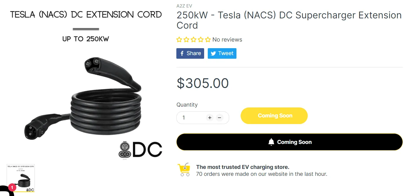

So I was chatting with the A2Z company that is making one of the adapters. Asked them about an extension cord for DC charging. They replied, yes they are also working on an extension cord:
Looking for an adapter for my CCS Ford Lightning for Tesla Superhcarging. I know you have one aleady. But the problem is the cord length because the Ford Lightning charge port is forward on the driver side just in front of the door.​
Any chance you could make an adapter with a 6 or 8 ft extension for high power DC fast charging?​
A2Z EV
Hi there. We are finishing up a DC extension cord which will be 3 to 9 ft. It should be available early 2024. We are doing safety testings.​
(re-posted to fix formatting)
Just noticed its already listed on their website as "coming soon":
https://a2zevshop.com/products/tesla-nacs-dc-supercharger-extension-cord
