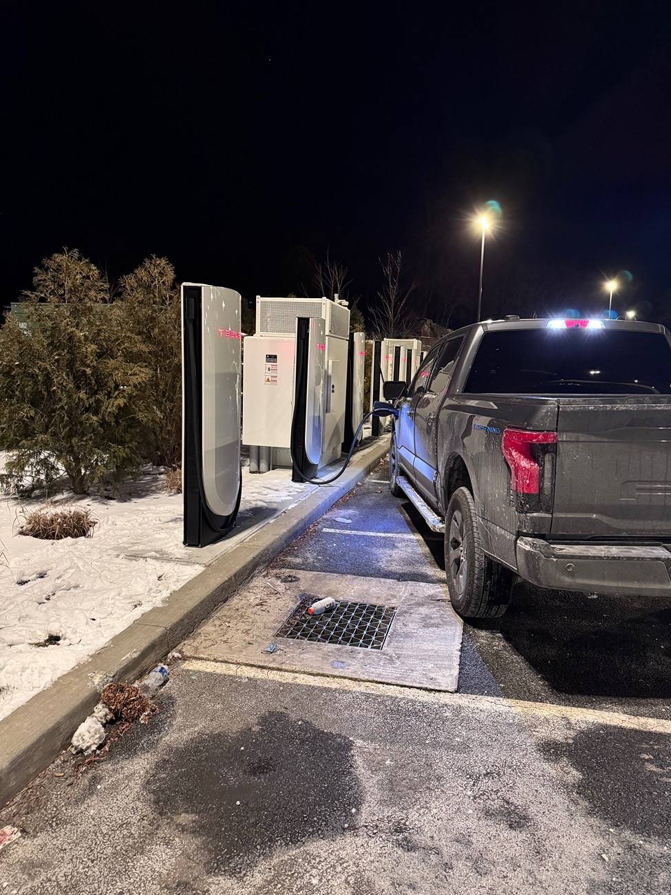

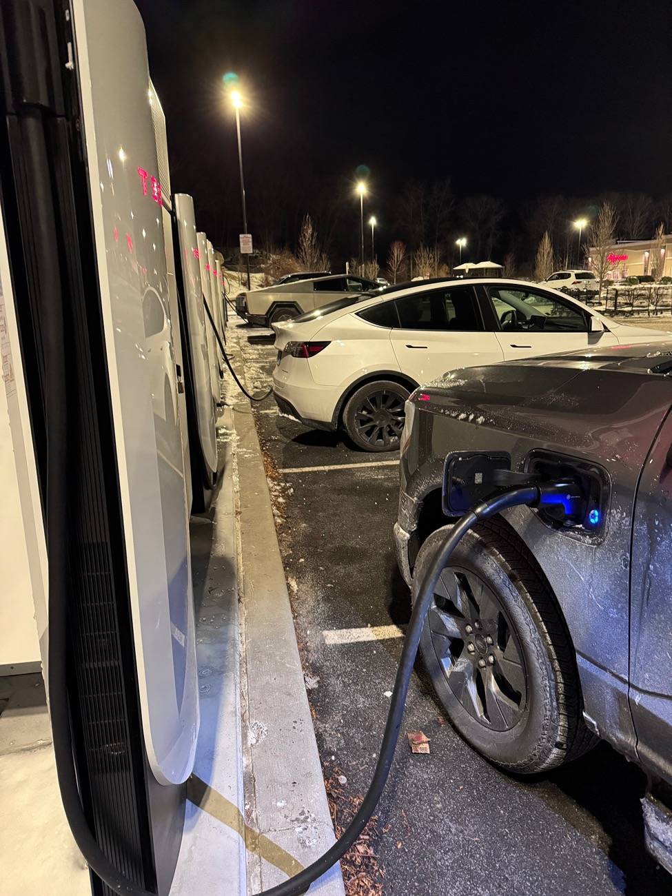

So this morning i on my way to work i stopped at a tesla supercharger and it had the adopter built in, i plugged it in activated from tesla app. But truck kept saying charger fault, with red circle light. Then i tried my adopter also and same results. I had ford plug and charged disabled.
location- harrison, NY 325kw
any advice, i checked if its all tight and connected well, thanks?

Update 1/21 i tired out the tesla chargers 325kw this morning. Had bad connection first day. So i gave it a try again this morning. Everything works now, whats good about this location ( Harrison, ny) comes with non tesla adapter in the chargers.
* yes i parked sideways, first charger was out of service, so just note that before attacking lol
