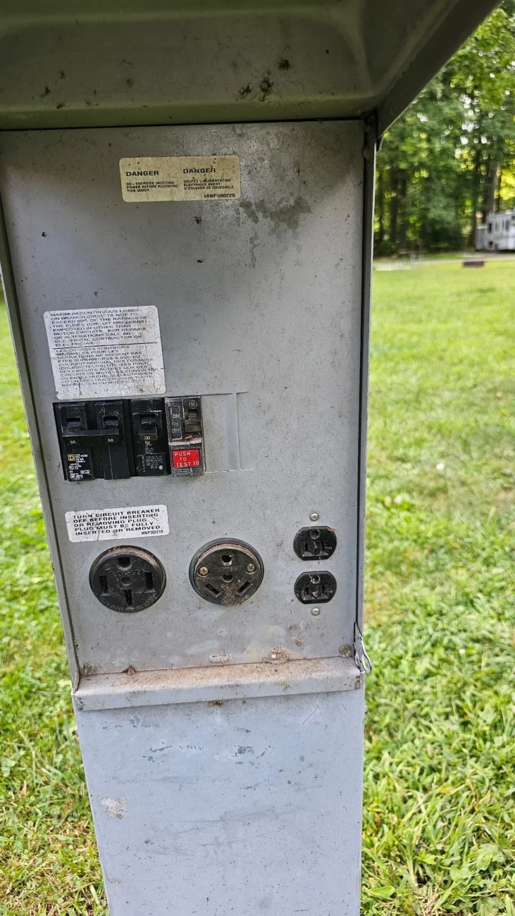

This is what i came here to ask.
I have a camping trip set up for this weekend with a 31 ft camper trailer. I want to plug the truck up to 50A and the trailer to the 30 amp outlet. Do you think the campground will let me plug into both at the same time? That's going to be a heluva amp draw. That would be great if I can do both! Here is the power pedestal that I will be using.

I have camped at 5 different campgrounds this summer. I make sure that the campground both the 30amp and 50 amp outlets in the same box. I plug my camper in to the 30 amp outlet and my truck in to the 50 amp outlet and have had zero issues. Its such a great amenity to have.

Yes, that is exactly what I have done repeatedly.
I recommend you hook up your trailer first and make sure everything is good on the 30A circuit.
Then hook up your EVSE on the 50A. Come back after a few minutes and again after about an hour to make sure the charging is going fine and the outlet isn't overheating.
I hope you are using a surge suppressor/circuit tester on your RV. I've also used one with the EVSE but had mixed results. Sometimes the tester won't let me charge but the EVSE charges fine with the tester removed.
