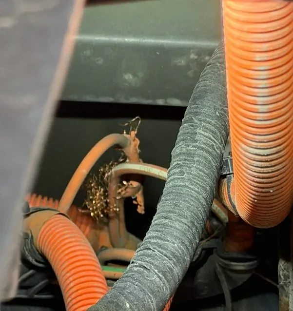

I posted this a few days ago in another thread without a replay. So I made another thread.
This past Wednesday I went to work like normal. Truck drove just fine. As usual, I sat in truck for about 20 minutes and listened to music and thumbing thru emails. Got back in the truck 10 hours later and went to start the truck, but no dice. I got the STOP SAFELY NOW, FULL ACCESSORY POWER ACTIVE. Tried turning off and back on several times... would not start. Checked 12V battery, it was reading 11.9 volts. I tried my jump box that I've given a dozen jumps to people over the years, hooked it up... nothing. I had my wife bring me my battery charger and let it charge to 13.6 volts. Tried starting it... same issue.
Got it flat bedded to the dealer the next morning. They looked at it and ran all kinds of test for a day and a half. They called me and said they found the problem.... rodents chewed thru part of the high voltage wires! He said that the harness will cost $2,200. The fun part is, it's on backorder without an ETA. 😶
He suggested that I get my insurance involved as my warranty AND my extended warranty would not apply as it is "an act of nature" that caused the breakdown. I will call my insurance tomorrow morning to let them know of my situation. I'm figuring it will cost me probably 6, 7K when it's all said and done.
I recorded a groundhog several weeks ago with my phone in the backyard close to where I was parked. I parked right next to a tall brushline with high weeds and woods behind that. I'll bet it was that damn groundhog that chewed my wires.
At least I know what the problem is, but now I may have to wait weeks or months before I can get my Lightning back. :(
What do you guys think about this whole deal?

I went through something similar in December 2025. In my case a family of squirrels had moved in over a three week period when the truck was parked near our cabin. Each HVB wiring harness (4) and 3 LV wiring harnesses had been chewed on. 9 weeks later I got the truck back. Insurance covered the $10K cost. Lesson: don’t leave the truck unattended in/near a wooded remote area.
Wow, that's terrible! 10K, that's not bad for all of that being replaced. I hope that that's the only wire that he hit on mine. They are supposed to call me in the morning with the estimate for labor. I hope State Farm doesn't try to play me on my claim.
