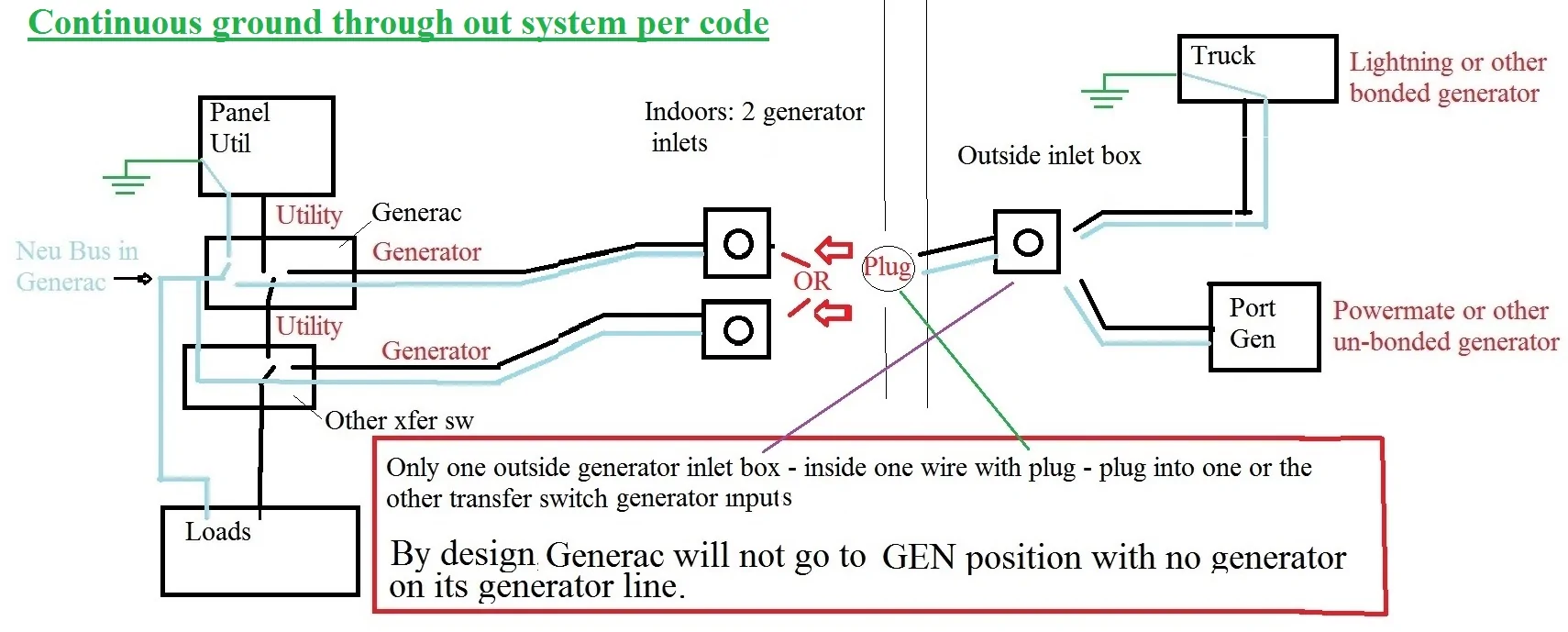

When I got my 2023 Pro with 9.6kw PPOB in January 2024 I couldn't use my original transfer switch because it didn't switch neutrals, so I got a GENERAC 6953 for under $400 to be able to use the Lightning for backups.
I wanted to keep the gas generator so if I need to drive the truck somewhere during an outage I would have a backup. And I did not want to unwire the original transfer switch, so I added the GENERAC and wired the two transfer switches together a simplified block diagram:
Ford F-150 Lightning The Home Integration System Departs With A Whimper Block diag of 2 xfer sw hook up w inlet boxes
I have one generator inlet box outside the house that either the gas generator or the lightning can plug into. Inside the house I have a generator inlet box for the GENERAC and the old transfer switch has a built in inlet. The 10 load circuits are fed from the old transfer switch which gets fed by either the utility or the Lightning through the GENERAC. The old transfer switch can also be fed from the portable unbonded gas generator if needed.
I wired up for the truck in June of 2025, but have not had an outage yet. I test the system periodically.
After a recent OTA update, the PPOB reserve is funky - it turns off the PPOB long before the reserve has been met. The workaround is to use the nearest charge station option in the truck PPOB reserve setting menu, which defaults to 10 miles for some reason.
It will be much nicer having the truck powering the house in an outage than the loud gas generator, if we ever have another one...:)
