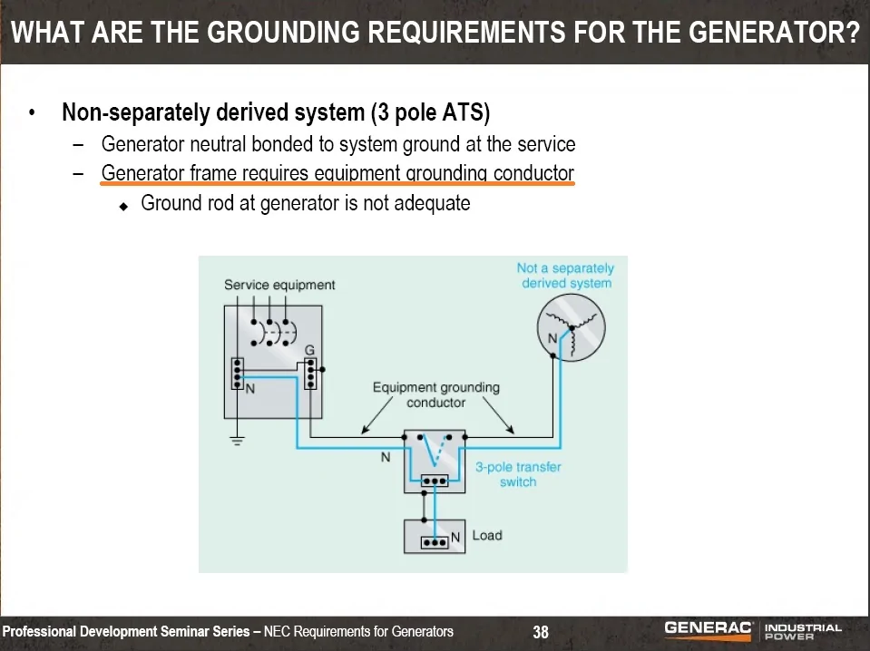

Assuming the Ford Vehicle Connector is there to avoid GFCI tripping due to a dual bond, I wonder how they accomplished this without creating a shock hazard?
All their literature and utility recommendations up to this point have said to only use an un-bonded, floating neutral generator with the GENERLINK system, or convert the generator to floating neutral by removing the bond at the generator and specifically said NOT to simply disconnect the ground wire between the generator and the GENERLINK system due to the risk of a shock hazard in the case of a fault.
"Per the National Electric Code, all generators must have a "floating neutral" when used with the GenerLink Automatic Transfer Switch. Please refer to the generator operation manual for bonded neutral specifications. "
Generator Compatibility & Requirements
To ensure a seamless connection with a GenerLink system, a portable generator must meet the following specifications:
  • Four-Prong Outlet: The generator must have a 14-30 (30-amp) or 14-50 (50-amp) four-prong outlet. This allows for two hot wires, a neutral wire, and a ground wire to connect safely to the device.
  • Voltage Output: The unit must be a 120/240-volt generator. Single-voltage (120V only) units are not compatible as they cannot power both ā€œlegsā€ of your home’s electrical panel.
  • Circuit Breaker Protection: The generator must have an integrated circuit breaker. This acts as a secondary safety layer to prevent overloading the GenerLink or your home’s wiring.
  • Clean Power (Recommended): For homeowners planning to run sensitive electronics (like laptops or smart TVs), a generator with a Total Harmonic Distortion (THD) of less than 5% is highly recommended.
  • Maximum Capacity: The generator’s continuous running wattage should not exceed the rating of the GenerLink model installed (typically available in 30-amp or 40-amp versions).
Neutral Bond Compatibility Note
One of the most common technical hurdles is the ā€œFloating Neutralā€ vs. ā€œBonded Neutralā€ configuration.
Important: Most GenerLink models require a generator with a Floating Neutral. If your generator has a ā€œBonded Neutral,ā€ it may trip the ground fault protection. A licensed electrician can quickly determine your generator’s configuration and advise if a simple modification is needed.
So what is that 'Connector' doing?
To make the PPOB a floating neutral system would require unbonding the neutral at the truck. A 'connector' at the outlet is not going to actually do that - the bonding is a jumper connection between the neutral and the chassis at the inverters.
And disconnecting the ground wire from the house ground would be a safety issue should a fault occur.

There is another thread where we were discussing the Generlink option. A forum member called the manufacturer and they said you have to use a Lightning specific cable. My best guess is the ground is disconnected like everyone else is doing but the manufacturer didn't specifically say they are.
That could be, but it is not consistent with all their previous literature, and what the code requires, that the source has to be connected to the house grounding electrode system.
AND if so, why wouldn't they say here use this adapter (the Ford Connector) with any bonded generator?
NOTE: What the GENERLINK FAQs says:
Why do I need a Ford Vehicle Connector?
Ford and Global Power Products developed the proprietary Ford Vehicle Connector, a short cable that makes the GenerLink compatible with the Ford truck and helps ensure the Pro Power Onboard built-in OSHA-compliant GFCI functions correctly when providing essential home backup power. The connection requires a two-part cable system: the Ford Vehicle Connector plugs into the 240V outlet (L14-30) in the truck bed, which then attaches to the GenerLok cable that plugs into the GenerLink unit that is installed either on the meter or next to the meter.
Do I need to ground the truck when using the GenerLink?
No. The vehicle chassis is bonded to neutral (grounded conductor). The grounded conductor passes through the Ford Vehicle Connector and GenerLok cable to the home service entrance where the neutral (grounded conductor) is bonded to the ground (grounding conductor). The grounding conductor is connected to the grounding electrode (ground rod) which provides an electrical path to earth. In simpler terms, when connected through the GenerLink system, the truck's electrical system is designed to safely use your home's existing grounding system, providing a secure electrical path to the earth.
They are saying the neutral is bonded in two places, the truck and the house.
But they are saying the utility neutral and the truck neutral are connected which make it a non-separately derived system.
A non-separately derived system requires a continuous equipment ground:
Ford F-150 Lightning The Home Integration System Departs With A Whimper NEC equipment grounding conductor required
So if they are lifting the ground, they are not complying with the NEC.
