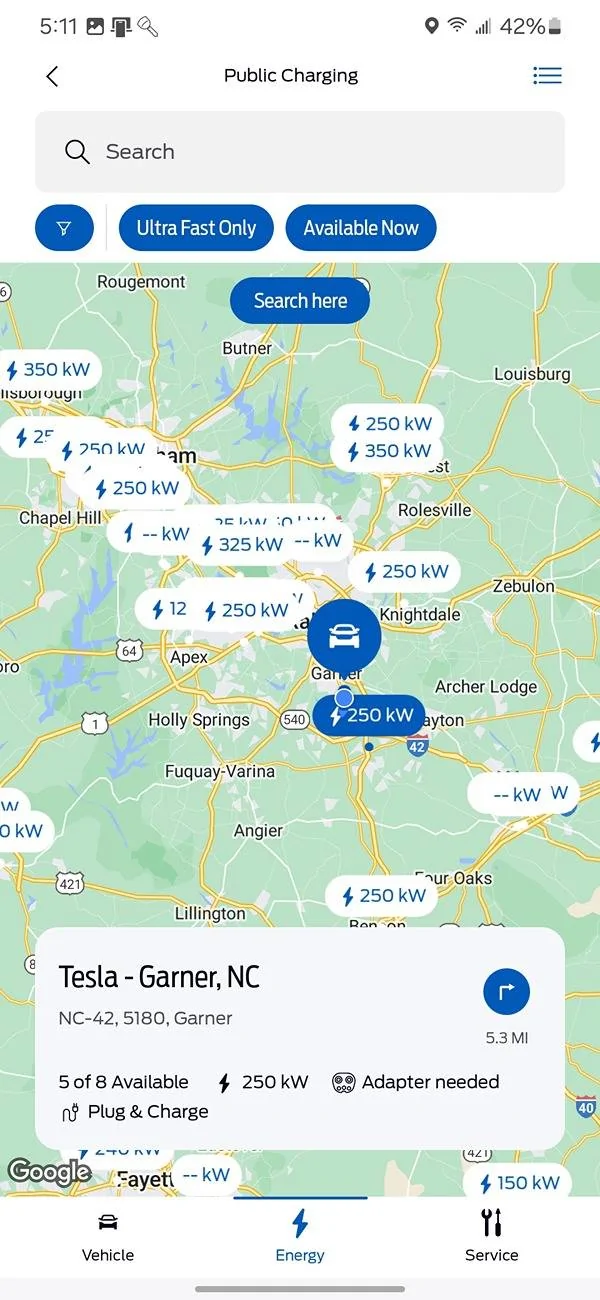

It’s just the FordPass Public Charging map on iPhone. The left side is PlugShare with NACS and CCS connectors selected and filtered for >20kW to filter out the Tesla destination chargers.
So is that the difference? You get a google map with an iphone but not with android?

FordPass, Energy, Public Charging.

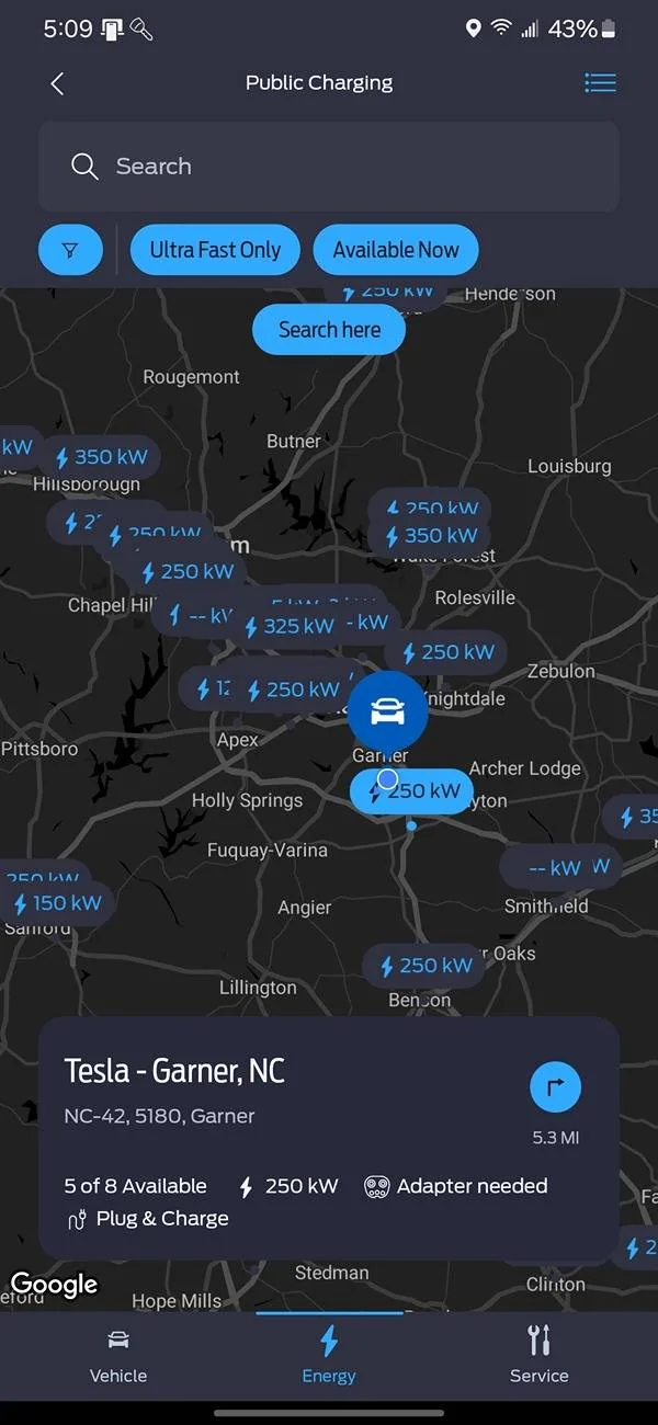

Yeah...I don't get that with my FordPass app. Mine is just gray lines on a black background. I do get the chargers showing up like that, but no Google map.
101
6,430
8,693
Ford F-150 Lightning This will be my last attempt at a Lightning Road Trip 1000004931
Then you're likely not in the PUBLIC CHARGING section.
Click on ENERGY at the bottom.
Under the word: Charge, click on Public Charging.

Exactly what I am doing... I go to the charging symbol at the bottom, click on public charging, and get the black background with gray, unlabeled lines. I'll try to get a usable screen shot and post it.
