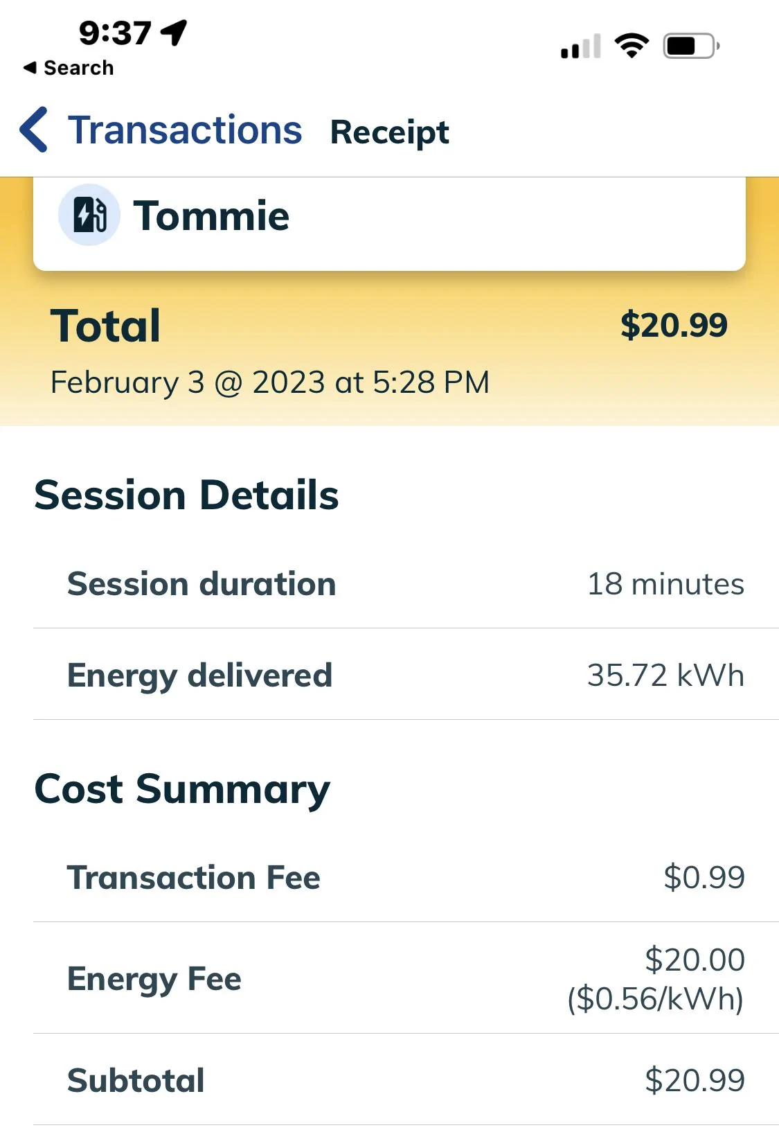

I agree, I love plug and charge!
Since EA chargers are always down or full, I go to the more common & accessible EVGo and pay even more money!
At $0.59/kWh EVGo also is true plug and charge by signing up for AutoCharge+.
EVGo chargers are newer, faster and offer a much less stressful experience than EA.
Ford F-150 Lightning Tips for improving the charging experience (Electrify America) IMG_5ADDE5A1DF2F-1
