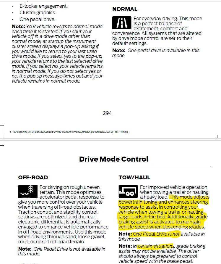

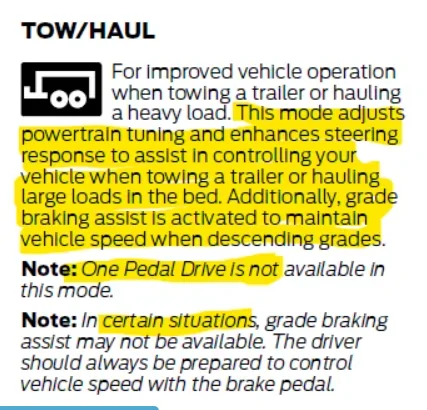

Let me reiterate in contrast to another OPINION, Tow Mode Matters!!
Consider using it until you know how the trailer impacts your trucks handling!!

I agree with Taxman Hog. You should tow in the tow mode. The braking system is enhanced, the cooling system is enhanced if you have the max tow package, the trailer brake controller will not work in normal mode, hill decent control is active if you have max tow, the motor is optimized in tow mode to tow appropriately, and steering is optimized.
It's not worth reducing your safety or the safety of others to increase your range by a few percent, if any.
