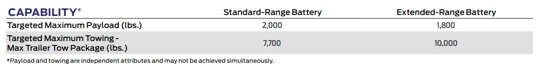

Note that the towing numbers reported are with the Max Trailer Tow Package. Which is exactly what I said.
Standard range towing without said package is reported as 5,000 lb. It's not in that PDF but has been in other Ford materials and is on the web here and there. Also as I wrote, I haven't seen anyone report the towing capacity for the extended range without Max Trailer Tow Package. Maybe it's also 5,000 lb. Maybe it isn't.
And I also didn't conflate payload and towing. I noted that the payload remains at 2,000 lb even without the Max Trailer Tow Package.
In summary, you really should verify your information before you post.
I stand corrected.

If the standard range battery is rated at 426 hp and the extended range battery is rated at 563 hp I can understand an increase of the base towing capacity of 5,000 lbs. to maybe 7,500 lbs. ( but I haven’t seen the actual towing capacity of the baseline extended battery). But could someone explain how the Max Towing option increases towing capacity another +/- 2,500 lbs. without increasing horsepower of the motors? The package says it only includes enhanced cooling of the batteries and motors.

My semi-educated guess (engineering background but no direct experience with these systems) is that running the batteries and motors at higher sustained loads builds up heat and they are unable to safely sustain the max tow load under adverse conditions (steep grade and high ambient temperature). Additional cooling allows those sustained loads while protecting thr motor and battery

So you’re saying that the motors/batteries already have the ability to tow the additional capacity. The Max tow package only adds hardware that protects the motors/batteries from damage?

Correct - the Lightning is the most powerful F150 ever produced by ford (i.e. excluding the Shelbys and other aftermarket trucks). Horsepower and torque aren't the issue.

That's basically all a Max Tow package is on an ICE truck as well. Those systems usually include a second radiator used to keep the transmission cool during towing along with some other handy towing features.
