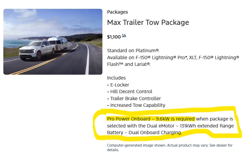

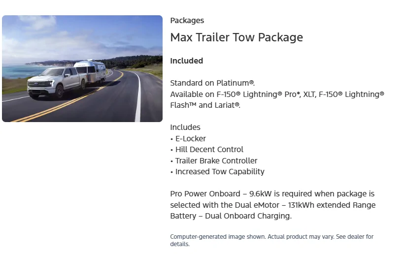

Looking at the FLASH BUILDER, similar data, (this is likely a static display of features for the option)
I don't think you will get dual OBC unless OPTIONED under a FLEET ORDER BUILD, and from my reading what they're saying is that if you've optioned the 131 KWH battery and dual OBC then you MUST have the 9.6KW PPOB.
This would still be a rare build for retail offerings (abandoned fleet builds) is about the only way you're going to see one.

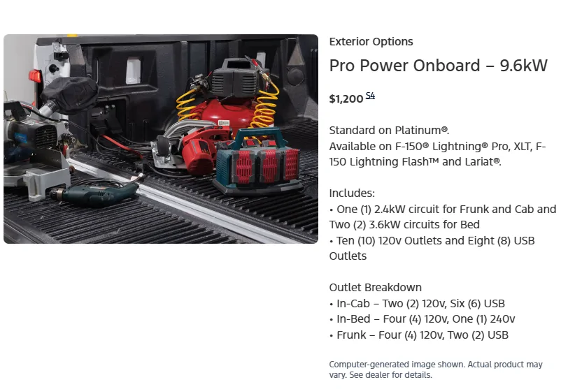

Also from the FLASH builder options pick list.
Ford F-150 Lightning MAX TRAILER TOW PACKAGE if not planning to tow? 1756645673047-3r

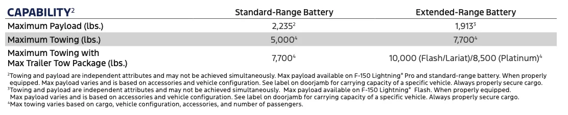

You need the max tow package to get the maximum tow rating (10k pounds) and the max payload capacity (2235 pounds). You also need the proper tires. The extra equipment provides compensation for its weight and more.

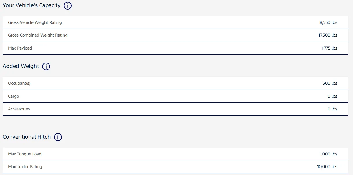

Well see that would be a game changer. But according to all the information I had seen, Max Towing does not increase payload rating, it actually decreases it. And the guys here also said that no other mechanical changes are made to Max Towing trucks. So which is true will be the wild card here.

Not sure where you are getting your information. Tech Specs say Max Tow package and Extended Range Battery is the only way to get the 10,000 pound towing capacity:

Oh I fully understand that the truck only gets the 10,000 lb Towing rating if it has the Max Towing package. What I'm saying is that I recently asked the Forum here if there are any mechanical differences between a Max towing package truck and a non-max towing package truck and all the guys said that the additional cooling is the only real difference.

Towing yes, but what about payload.
I have not dug into it but I didnt belive that max tow improved payload capacity at all.
OK, so this is where it gets interesting...
Well, that's 250 lbs. less payload capacity you will have. And since trailers (campers, enclosed trailers, boats, etc.) are designed to put 10-15% of their total weight on the tongue, that translates to a loss of 2,500 lbs. or more of maximum gross trailer weight.
So, using myself as an example.. my trailer/camper weighs 7,500 lbs. so assuming 13% on the hitch that's 1,000 lbs. Wife, myself, and two big teenagers go 800 lbs. Our coolers and camping gear are 200 lbs. So that's 2,000 lbs. of payload. My truck is stamped 2,030 so I'm OK.

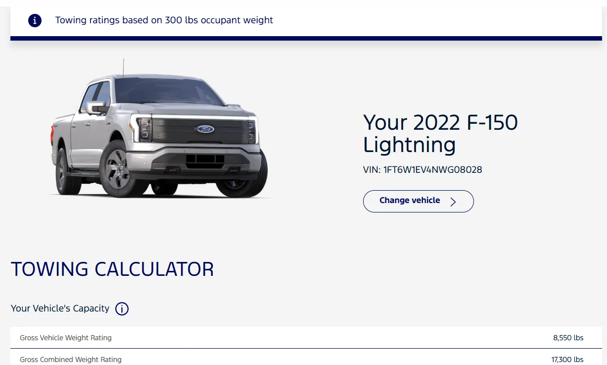

Ford F-150 Lightning MAX TRAILER TOW PACKAGE if not planning to tow? 1756820423943-vd
Ford F-150 Lightning MAX TRAILER TOW PACKAGE if not planning to tow? 1756820451055-ia

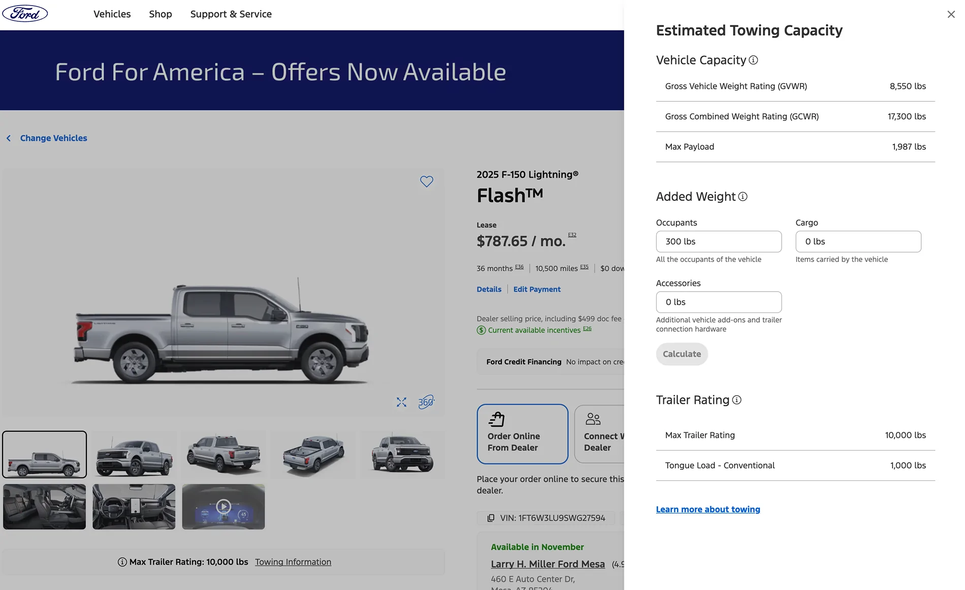

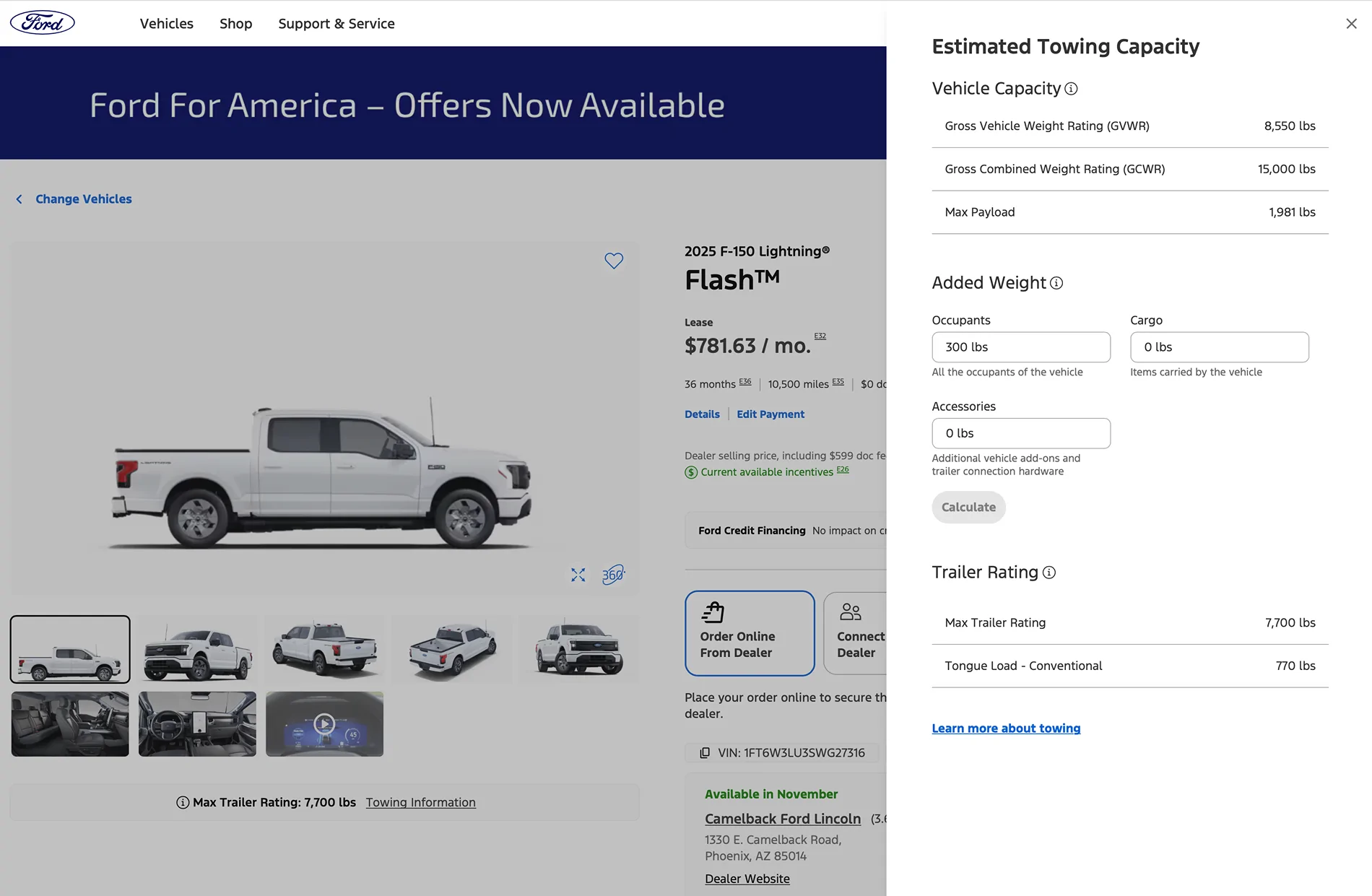

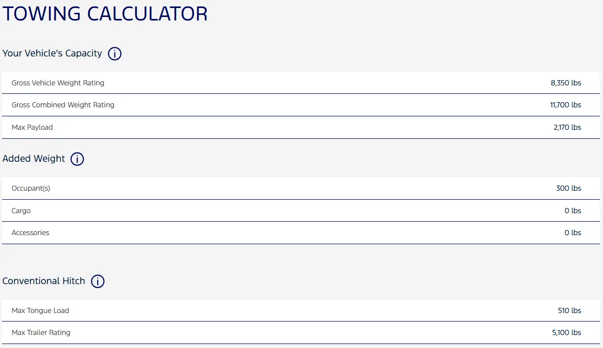

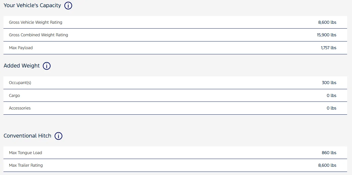

Two Flash models with nearly identical configuration. One has the max tow package, one does not. Both have all-season tires. The one without the max tow is missing the electric locker.
Ford F-150 Lightning MAX TRAILER TOW PACKAGE if not planning to tow? Screenshot 2025-09-01 at 07.53.46
Ford F-150 Lightning MAX TRAILER TOW PACKAGE if not planning to tow? Screenshot 2025-09-02 at 08.11.30
