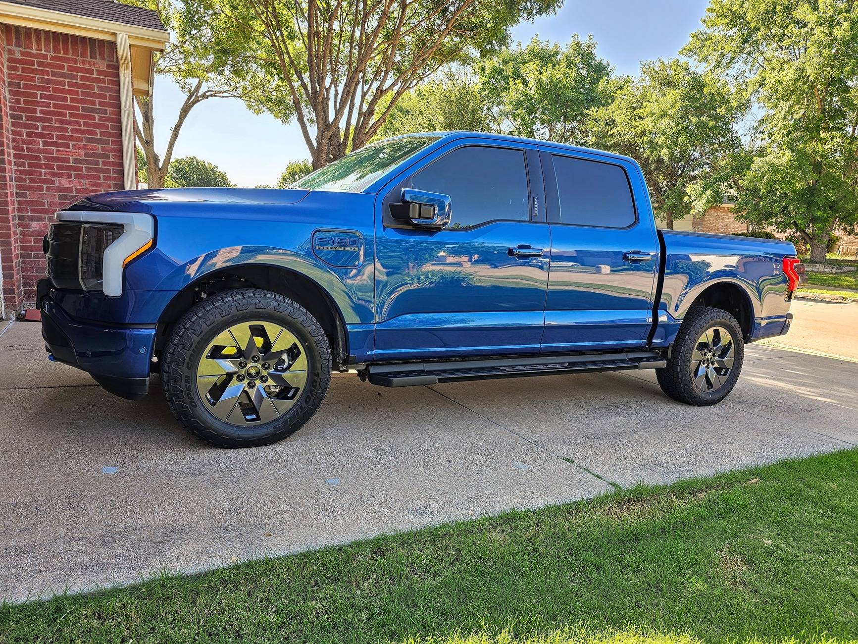

Just got them installed this morning and they look and ride very nice. Checked lugnut torque and it is at 150 ft-lb like factory requires, so all good.
Your truck looks so good! Those sidewalls look more prominent and aggressive than others I’ve seen. Are the sidewall detail the same on both sides? Or could it be the XL 116T version?

It is hard to tell with them mounted, but I looked underneath the truck. The backside of the tires appears the same as the outward facing side.
