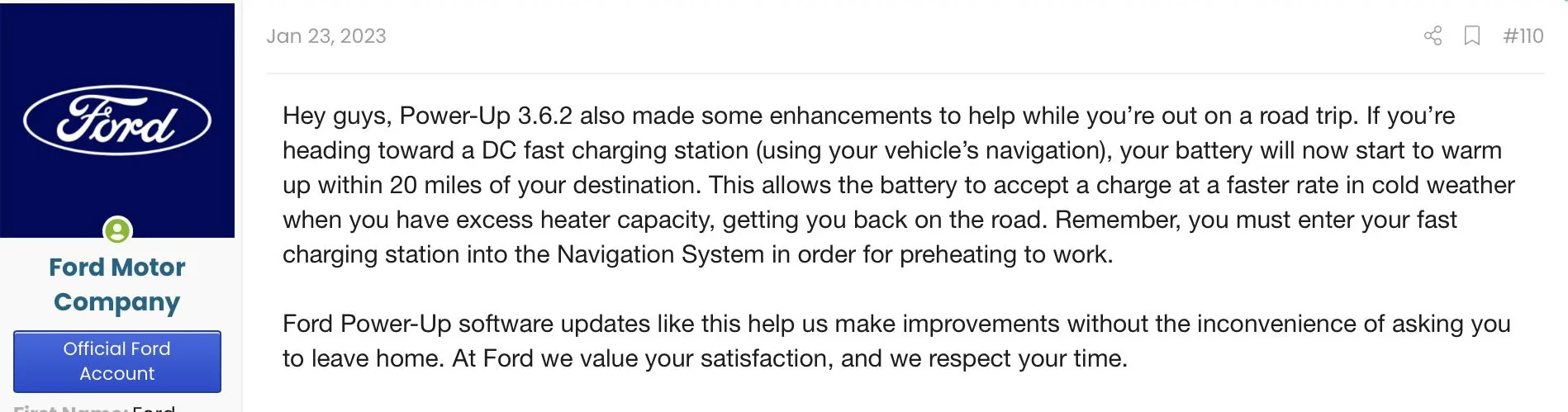

@WRSNH why concerned about navigating with preconditioning ❓❓
it’s summer, doubtful anything special is happening In warm weather.
it’s a winter thing, warming a cold battery.
but as g.I. Joe says “knowing is half the battle”

The Lightning DOES NOT give you a notification that preconditioning has started.
I'll make my intended charging stop the next destination, especially in the cold season.

It's not just a cold weather thing. If the battery is too hot it will not take the charge at the rate you are expecting.
It's a Goldilocks thing - not too hot, and not too cold. 😋
Granted, it tends to be a greater issue in cold weather, but not unheard of in hot.
