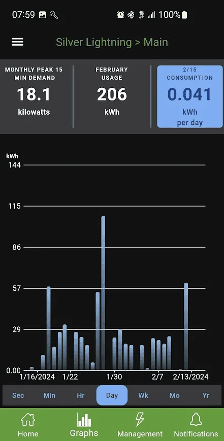

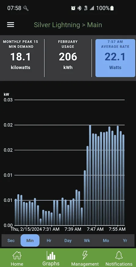

Plugging in overnight did nothing for my Lightning last night, BTW, the charging configuration is such that it is outside the time frame like (I described above, done intentionally to test a theory) the EVSE won't even provide sufficient energy to the the PTC for a 15/30 minute remote start cycle.
This is what I have so far for total energy consumption since midnight Thursday morning, plus 15 minute plugged in remote start. The Available energy dropped from 95% last night to 90% this morning because of cold soaking @ 20ยฐ overnight.
The experiment will continue through the weekend.
Ford F-150 Lightning Preconditioning 1708006038289
20 watts for the blower motor..........41 watts/hours since midnight
