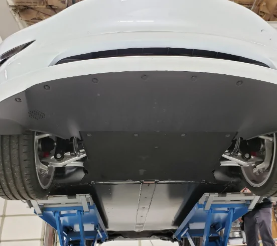

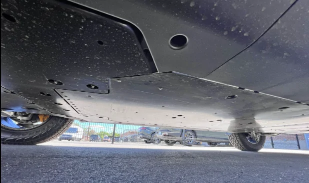

It would be cool to add more power. In order to add efficiency Ford needs to do 2 things.
1. Make the truck more aerodynamic. Both the Rivian R1T and the GM EV trucks have significantly less drag.
2. Add a clutch disconnect to one of the axles. That way on the highway one of the motors can be completely shut off.
My Tesla allows me to slide a slider on the screen to go from AWD to RWD or FWD, It also has a Drift Mode. (Never even used it). Not asking Ford to do this same... but love the thinking outside the box.
If you have ever looked underneath the Lightning? It seems that someone could sell a cheap aero package.

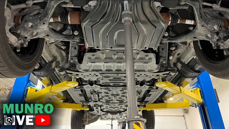

Even the Rivan has Aero:
Ford F-150 Lightning Tuning a Lightning 1760409687968-cg

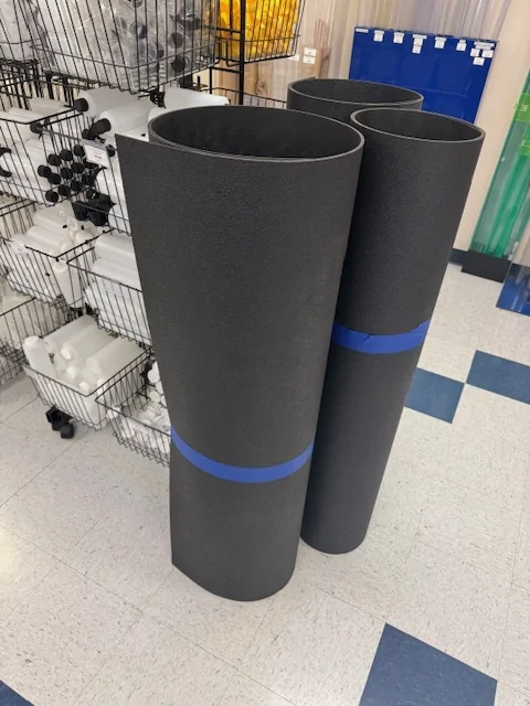

Even remember having one of those rollup snow sleds as a kid.
Ford F-150 Lightning Tuning a Lightning 1760409788451-5u
Made from pretty thick Polyproylene. If we could have this in Black and remove a few bottom bolts and create our own aero. It's flexible to it won't made noise yet would defend against rocks, mud and all those air catching places.

I have looked at the underbody sheeting and spent some time on ecomodder seeing what the hypermiler guys are doing.
In the end there are two schools of thought. Make the bottom good a d smooth, or keep the air from going under there in the first place.
The downside to smoothing the underside is it can have undesired effects. A flat bottom can actually make a bit of suction if not done right. Flip that around and load the back, giving a noze up attitude and now it can reduce pressure on the rear tires.
Thats why most OEMs go simply with keeping air from going under there in the first place. The just results in an area of stagnat air that you just drag around with you.
From what I have seen blocking air from going under is as effective and essier.

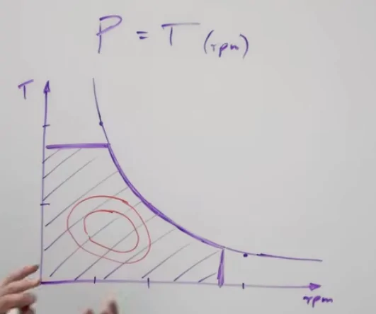

The efficiency loss due to hard acceleration, I suspect, is minimal. Electric motors gain efficiency as they generate a back EMF at higher RPMs. Hard acceleration gets the motor through the less efficient RPMs faster. Of course it also gets the truck into aerodynamic drag quicker as well. The compensating tradeoffs are obvious. The magnitude of those effects are above my pay grade.
This guy's pay grade allows him to draw it (Red Circles). Dude knows his stuff when it comes to efficiency.
Ford F-150 Lightning Tuning a Lightning 1760634637084-mt
Comes from this older video reposted:

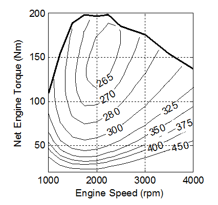

So, the "efficiency" lines he draws corelate roughly to a Brake Specific Fuel Consumption graph for regular fuel engines.
An example is here
Ford F-150 Lightning Tuning a Lightning Engine_load_vs_engine_speed_for_different_specific_fuel_consumptions

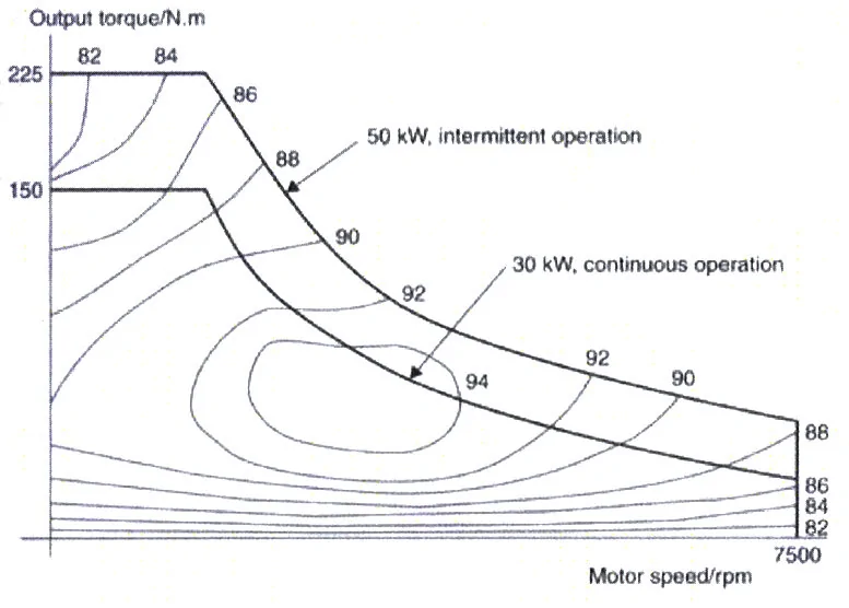

Compared to a power efficiency map for a brushless motor.
Ford F-150 Lightning Tuning a Lightning Efficiency-map-for-a-BLDC-motor-3-TABLEN-CHARACTERISTICS-OF-THE-THREE-CYCLES
Now not a perfect example since we don't know what engines/motors these are from, but we can see in the Brushless motor example the efficiency is between the mid-80s and mid-90s. Aka, more torque requested, more loss, having maybe 10-12% more loss at high demand.

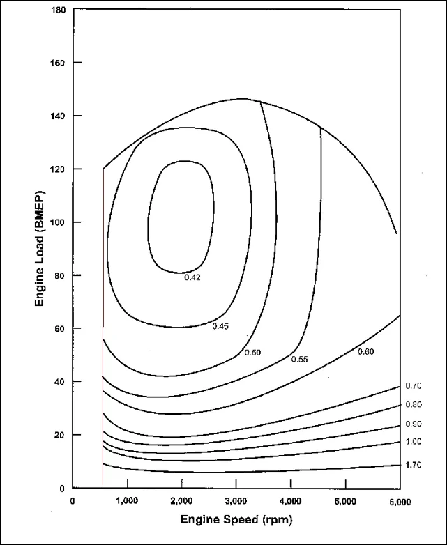

On a fuel motor we can see the same thing. In this example we see that fuel usage per power output (possible grams of fuel per kw delivered) changes pretty drastically. comparativly if where the electric motor may have lost 12% in efficiency, if that gas motor ends up in the 350 region it has ~25% loss in efficiency.
Ford F-150 Lightning Tuning a Lightning Brake-Specific-Fuel-Consumption-BSFC-plot-and-torque-limit-curve-constructed-from
Its not so much that electric motors don't have "any" loss, its that they don't have a high loss and that loss is much less than in a gas motor.
If I can trust ChatGPT with some of this it would indicate that in a typical brushless motor the loss from high output is <10% (% loss, not change in absolute efficiency). In the plot above the total change was 41% (41% decrease in efficiency). Absolute efficiency is in the 30% range so using absolute there isn't the same.

What you are saying makes perfect sense but neither me nore the Lucid guy were thinking about ICE. If You think of his circles as 95% and 97% and his curve as 60 KW, his graph of electric motor looks exactly like yours. I think he was just trying to convey some general concepts to electrically challenged folks like me. But I do get your point.
Even if electric efficiency improvement is not significant, it adds up. When I keep my power band in control (under 50 KW) that motor efficiency adds to the power I am not loosing fighting air molecules at higher speed or on tire friction flooring it. So my total real life saving operating that motor in that range is much larger than 10%. I get 3.6 Kwh in my city drives vs 1.8 Kwh flooring it on the highway. 100% improvement is not too shabby. So as others have suggested, instead of worrying about mods, I just chill and enjoy the scenery.
