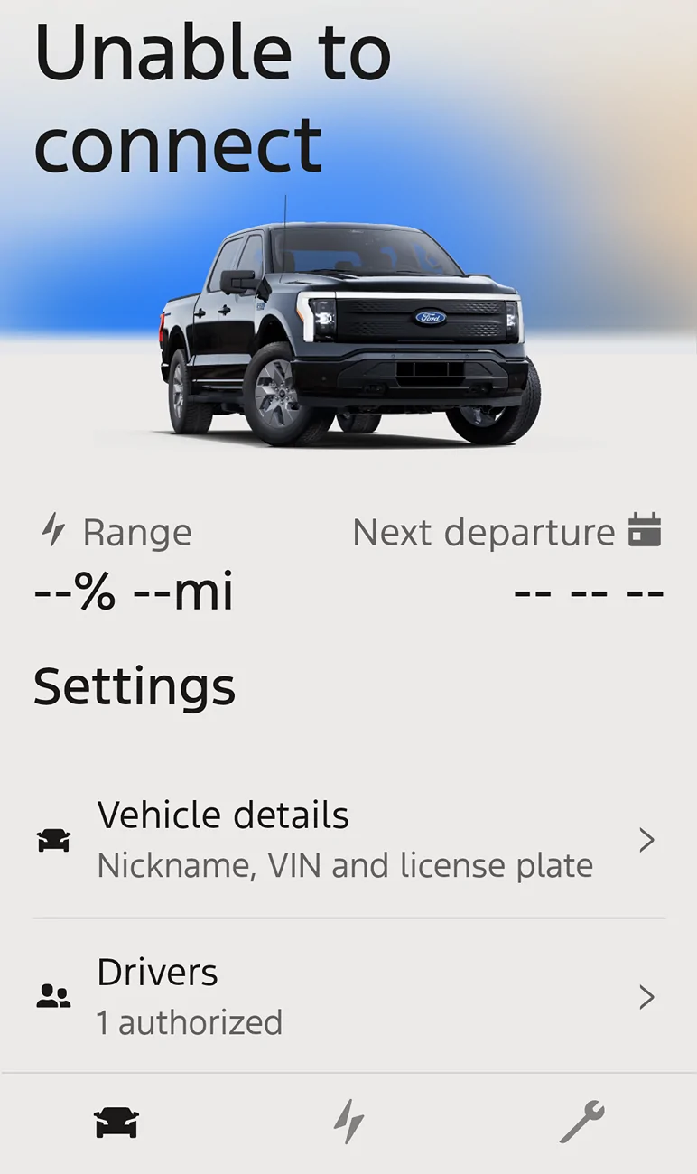

For the last 2 days Ford Pass has been unable to connect to my truck.
Logging out and logging back in did not fix the problem.
Any suggestions?

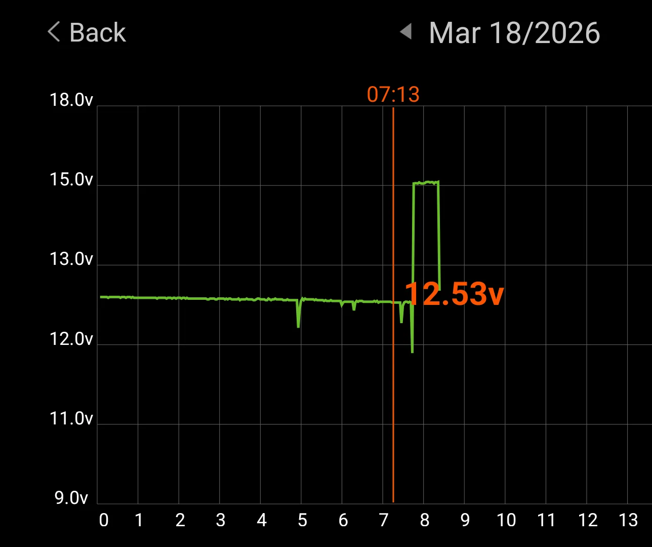

Update: I noticed my parking sensor alerts were coming from the IPC/dash instead of door speakers. Might be a low 12v battery... Classic...
My Chinesium Bluetooth monitor shows 12.5v overnight. That should be enough?
2025 Lightning with less than 7,000 miles... Already battery problems...

Plugged into Level 2 charger at work. Chinesium battery sensor says charging at 14.01 volts. See if 4 hours on L2 charger can bring 12v back to life.

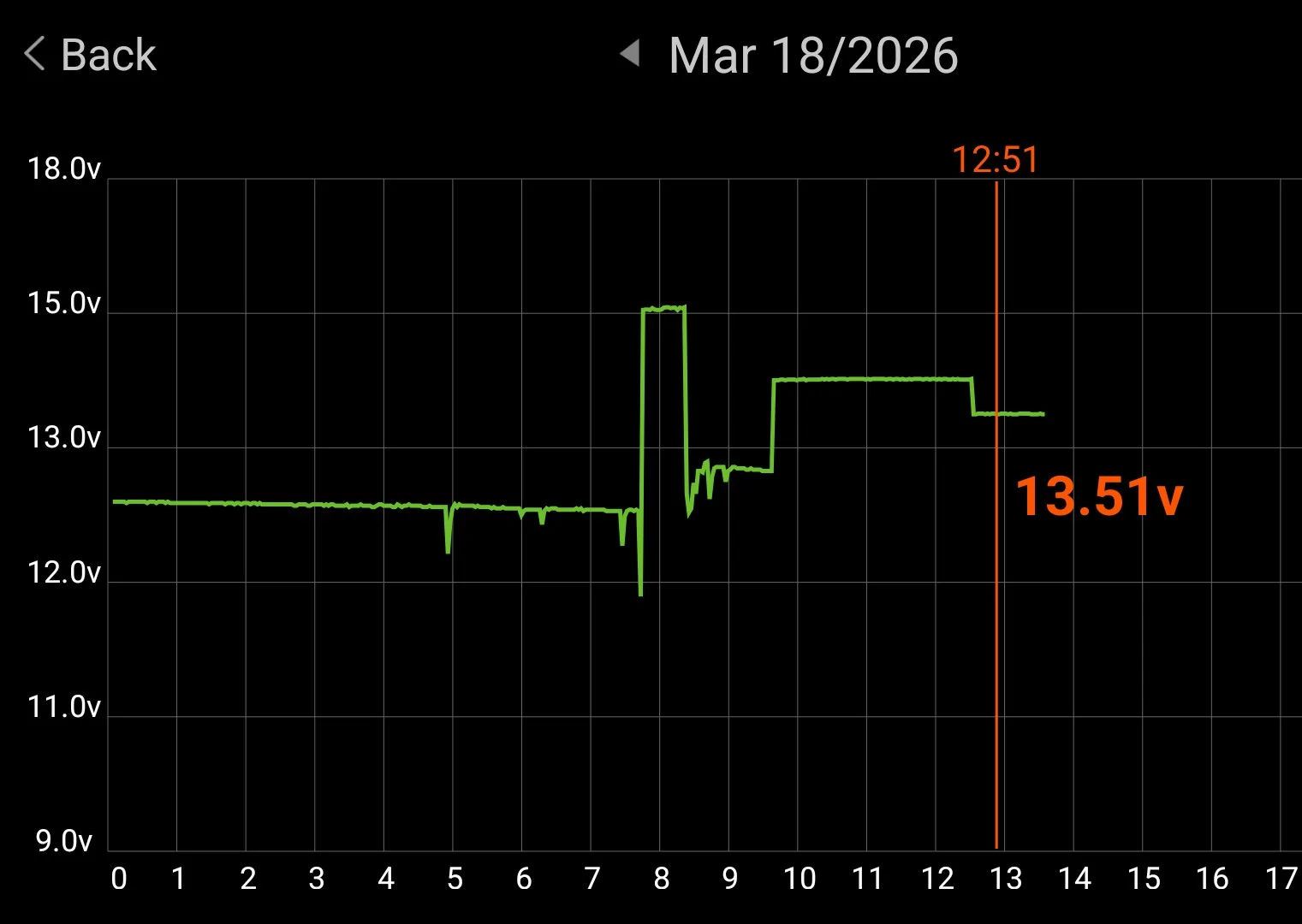

Update: Ford Pass randomly started working again. Been on L2 charger for 2 hours. I don't know...

Looks like it charged at 14 volts for 3 hours and then dropped to 13.5 volts for the last hour of L2 charging.
