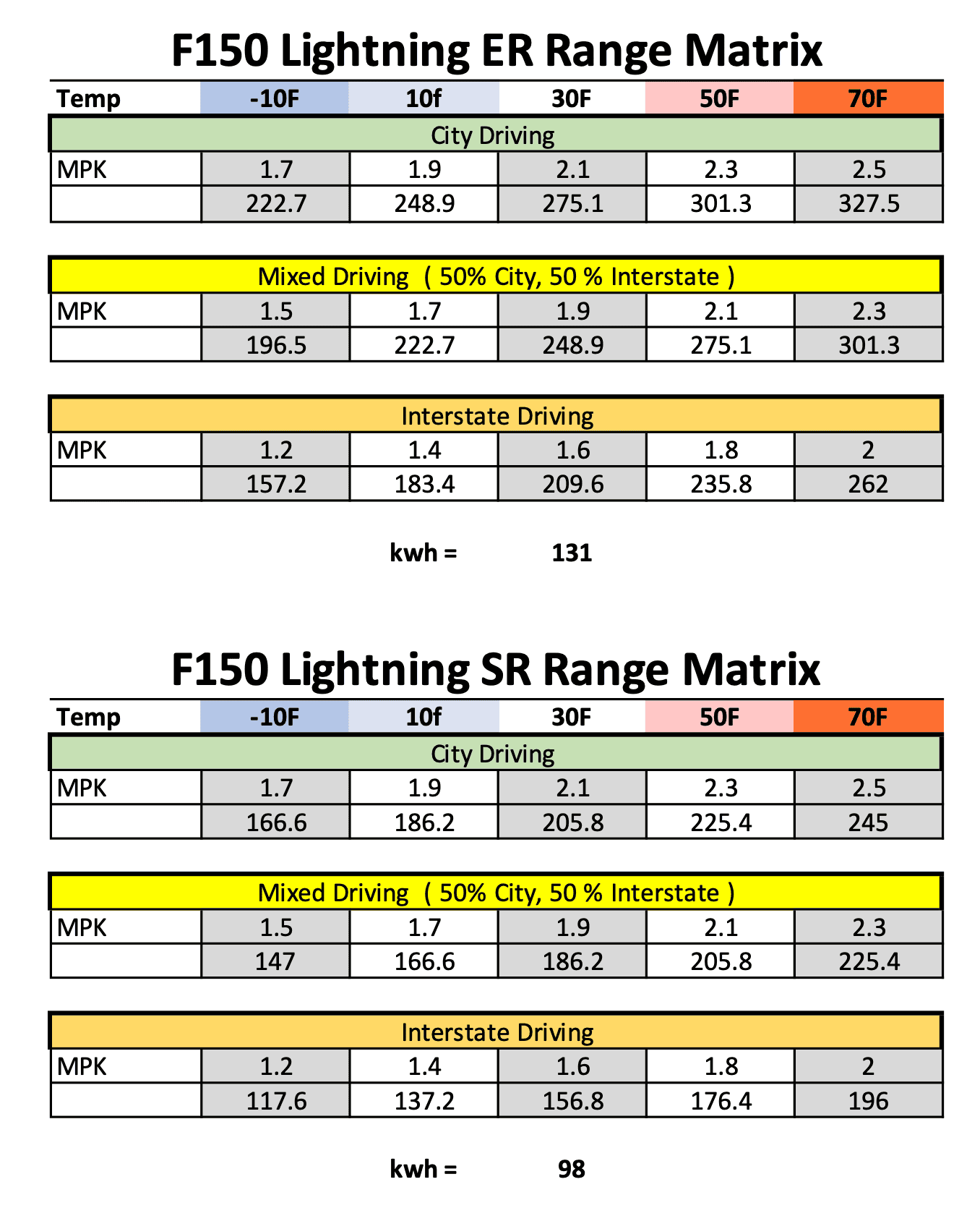

Your MPK numbers are not very far off what I have witnessed over the course of 17,000 miles and many days in that type of temperature or colder. Please see attached as a ROUGH GUIDELINE as to how speed and temp affect MPK and Range.
Ford F-150 Lightning Unexpectedly low range F150 Lightning Range Matrix
As others have said...
Limit use of cabin heat, Drive slower (I hate that answer but its true), Precondition prior to driving for longer trips (Has to be plugged in to 240v to precondition battery).
Bottom line, this vehicle is great for many things. Frequent long trips in colder temps is not one of them!
