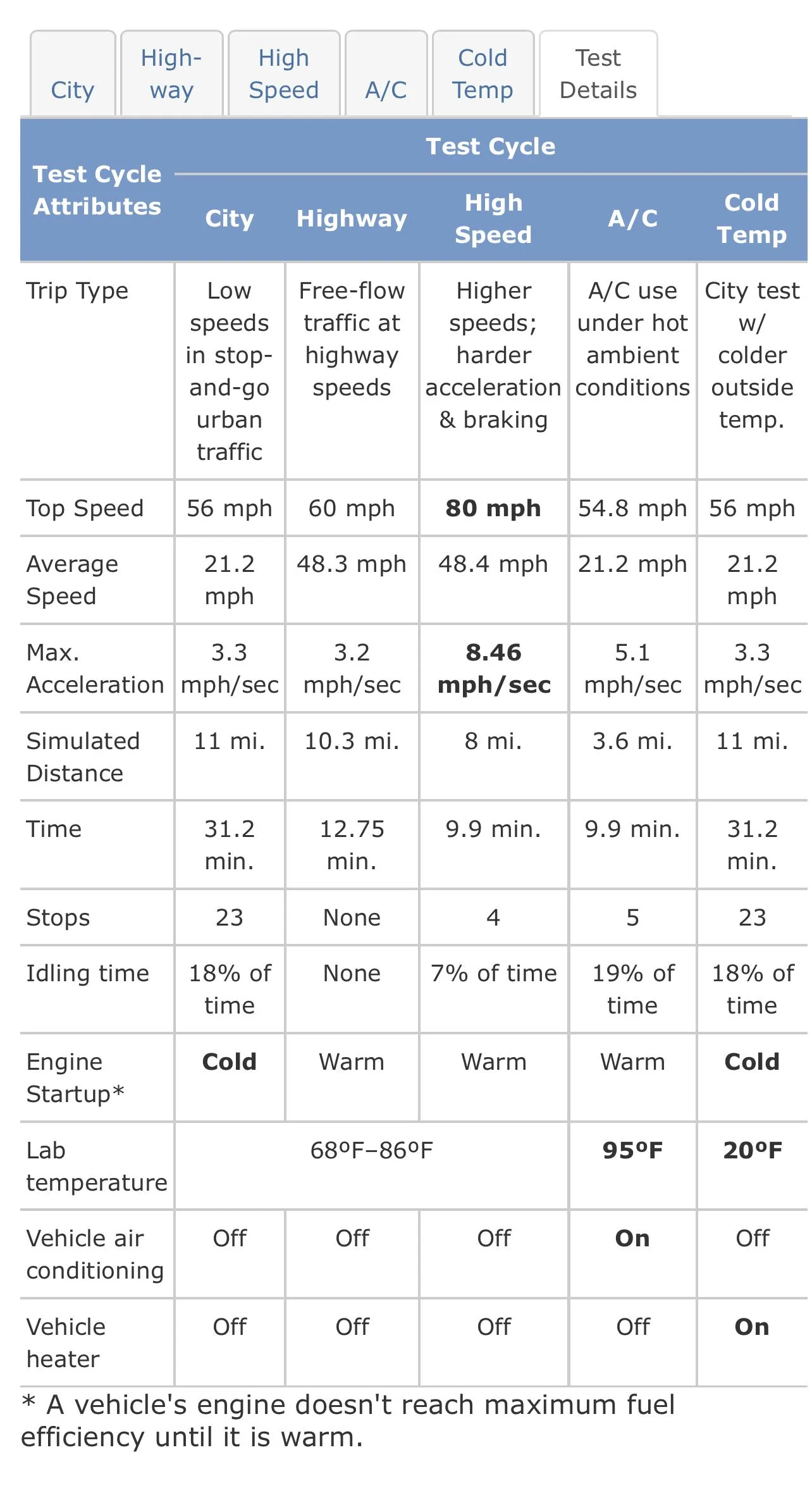

epa is outdated and all of the tests are at 55 mph.
while the EPA tests may be outdated or misleading in some way, they aren’t at 55mph
Ford F-150 Lightning Range Super Low? Lariat ER at 1.7kwh 8D01FD9E-3A22-485D-A59C-41D225B3E738
Results of all the above cycles are taken and averaged to reach the headline EPA figures.
For BEVs, these are all done in a dyno, but results are multiplied by an inefficiency factor (apparently usually 0.7) to account for various real world inefficiencies.

Thanks for the info and link! The average speed is still only 48 mph on both the highway and high speed test, so i dont know how that translates to real world highway driving (typically longer ranges at a higher rate of speed). another thing i thought was interesting is using the .7 factor, how is does this achieve consistent results considering some vehicles have much better aero?
apparently the regs allow for various ways to adjust the dyno tests to real world conditions, with the 0.7 just being a common example factor.
To some extent this would seem to police itself, as manufactures will have every incentive to both maximize the EPA mileage rating, while also sandbagging for customer expectations.
ultimately, the EPA mileage estimates for BEVs are probably no less hypothetical thanI’ve ever experienced in ICE vehicles.

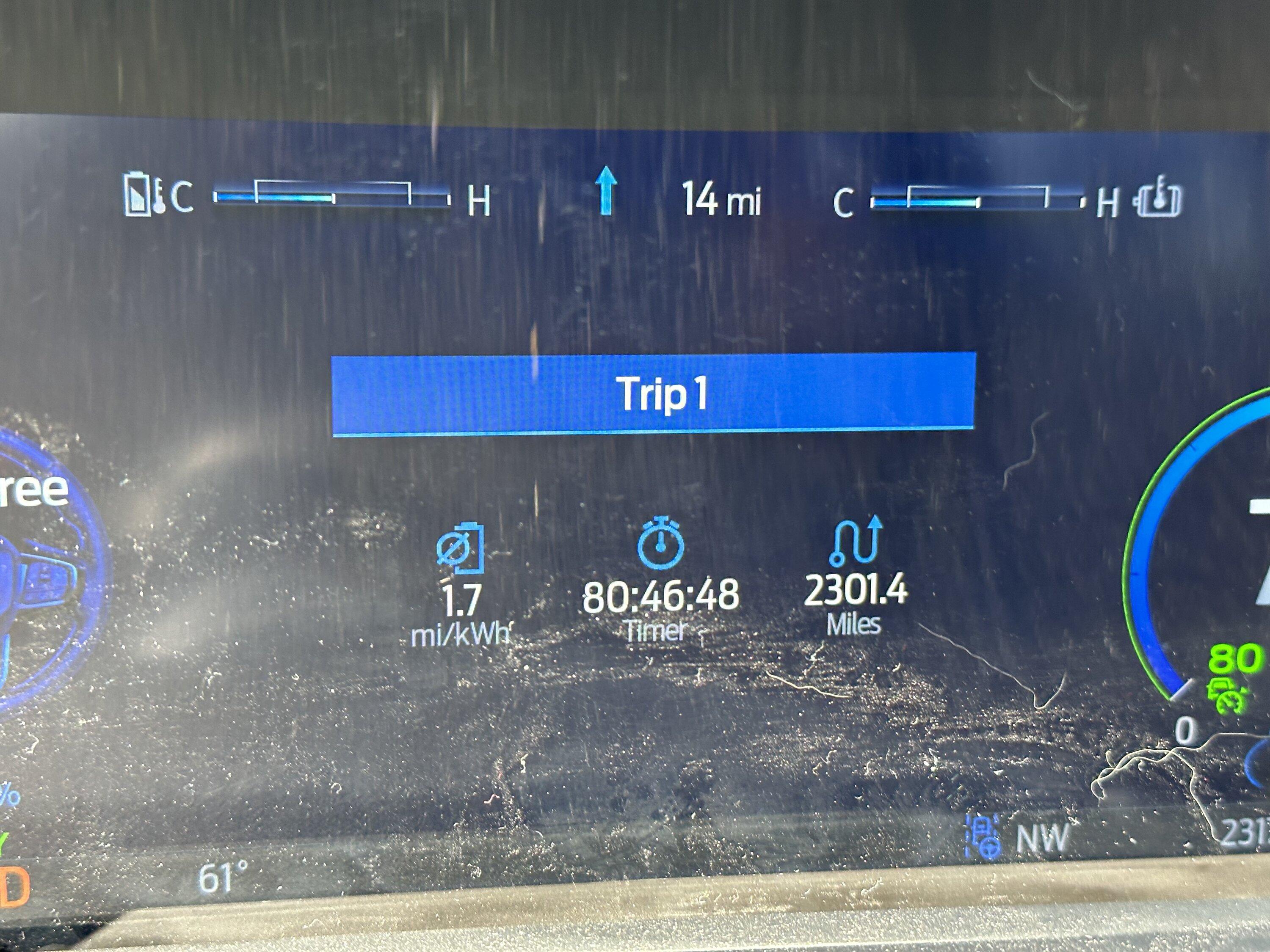

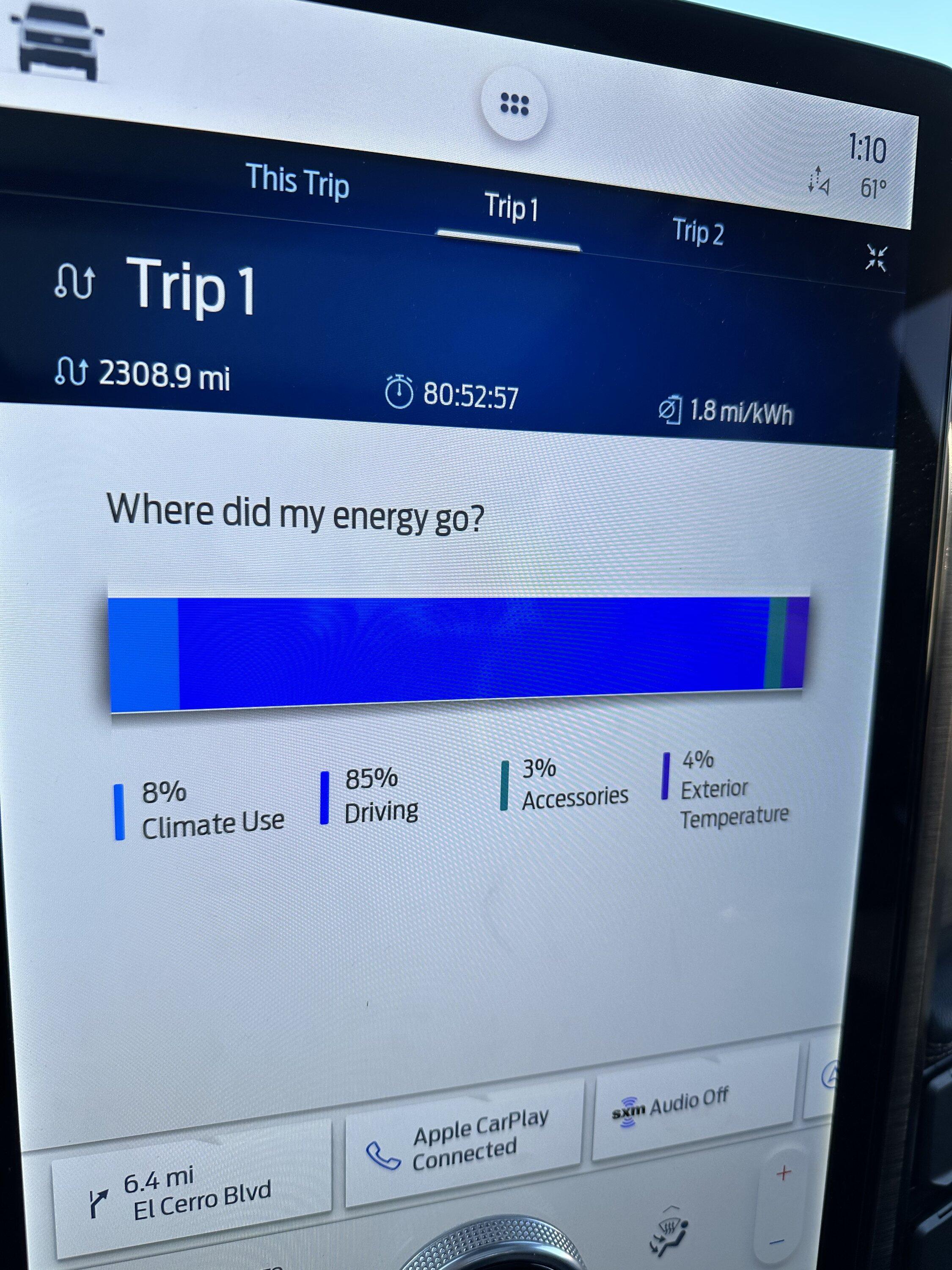

Ok. Phoning some friends here.
I have had my Lariat ER for 2 months and 2300 miles. I live in California where the temp has been 35 to 70 degrees out. I have the all terrain tire swap instead of all season. For about 400 of the miles I have had a lightweight paragon tonneau cover. I am not carryobg
I have been AVERAGING 1.7kwh per mile. When driving long distances down the 101 at 70 or 80mph I have been getting 1.4 to 1.5. I have tried pre heating and even turning the HVAC off. What is odd is that sometimes I will do highway driving 40 miles and get 2.0 kWh. Off highway I get a great 2.8+.
1.5 doesn’t even get me 200 miles of range at full charge (not including battery degradation over time).
anyone else seeing such horrible range? Any advice?
I have had 2 different Tesla X and have never seen this wide variation.

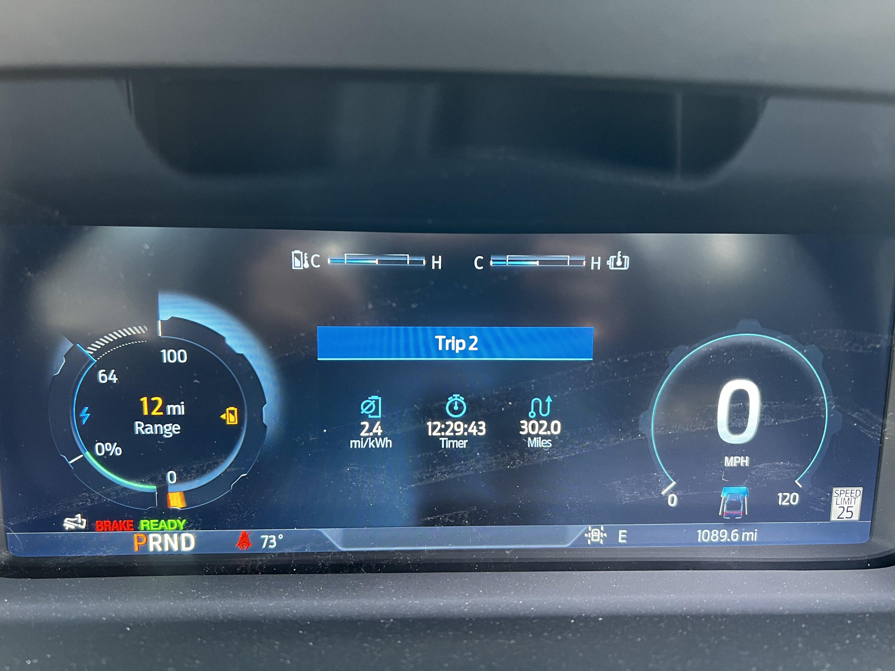

I do live in SoCal and my hwy speeds are never over 70. Stock tires and driving 50/50 city/hwy. thats what I get as a range.
