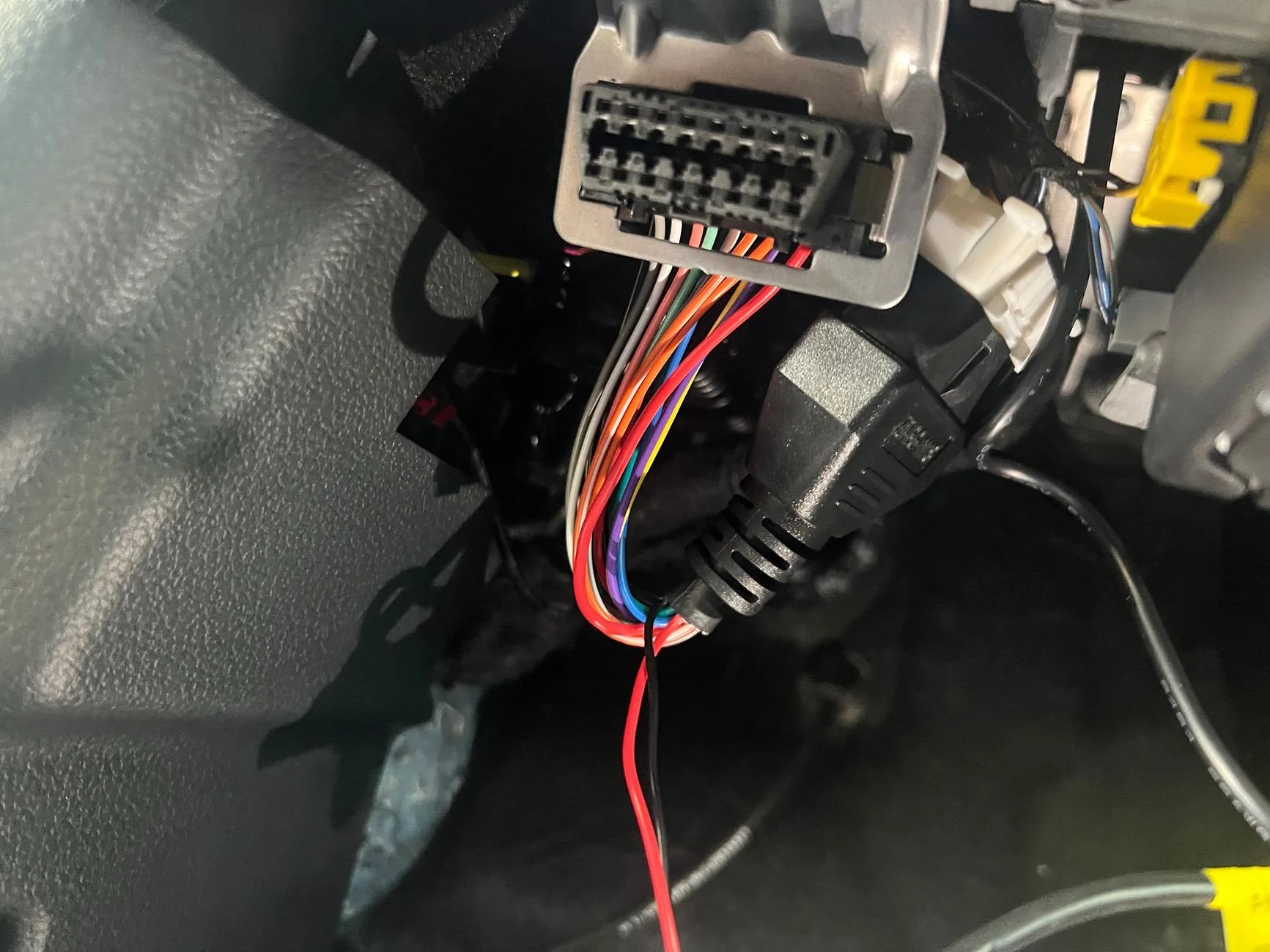

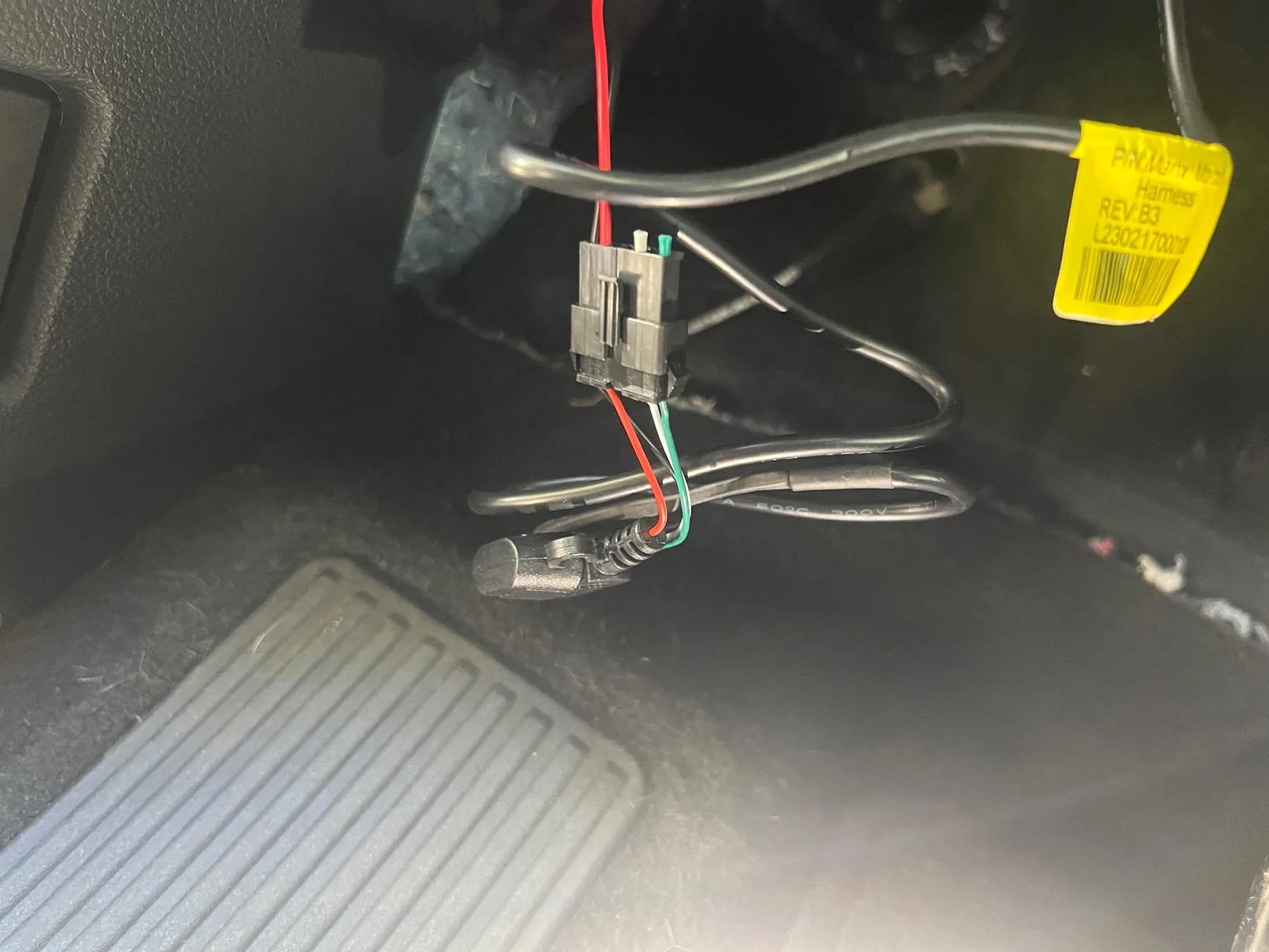

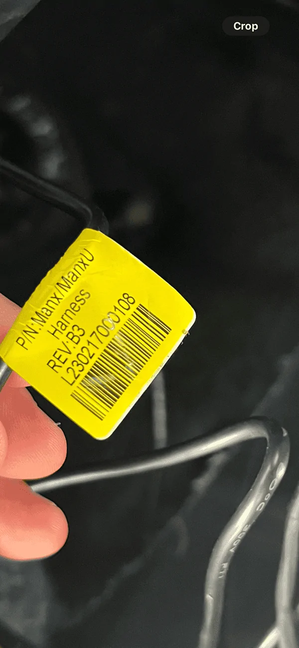

Does any one else have this? Brand new 2024 lariat never saw this before I found a piece of tape dangling on the floor too. Obviously it was holding it up. From what I can tell one wire goes way up into the panel I can’t see where and it looks like some type of a harness that was attached to the back of the OBD II. ??‍♂ goggled part number some type of man x harness but can’t really find anything

First unplug it immediately and leave it unplugged. That's most likely a dealer installed GPS tracking device. This is becoming more and more prevalent from lots of dealers of every kind. You didn't ask for it and you have absolutely no obligation to leave it operational.
After it is unplugged, you can follow the wires and remove it completely. Or just leave it. Eventually the dealer will call and ask about it if they care. At which point you should speak to their manager and explain to them that he is an ass and if he wants it back he can come get it and shove it up where it truely belongs

You absolutely can unplug it. That harness is powering something like a Lojack more than likely. And is probably draining your LVB. The white OBDII port that the harness is plugged into is your actual OBDII port and should be where that black port is now.

Thanks everyone. I have unplugged and put the white OBD part back but now I have a long single cable going up into the dash some where ??

Well thanks again everyone. It was definitely a low jack some company spireon. At first, I didn’t wanna open up the dash because I’m like this is a brand new car but I remember when I had pulled on the cord I thought something fell but I was like maybe it was just the cord making the sound so I went back in there with my hand underneath the dash and I’m like I don’t feel anything, but I found this thread
